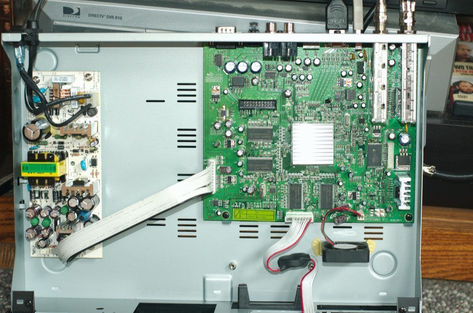

The 8100 comes with a fan, and the 8100 uses the same circuit board as the 8000 (says 8000 on it), so there is a power plug for a fan (or at least contacts where a plug could be attached).
The power plug is front right when you're facing the front, I think about 1/3 of the way across. I have a picture of it that I posted to another forum a while back. I'll look for it.
The fan, however is a very small one, about the size of a silver dollar. Not sure if the power is enough to run a big computer fan, but it can't hurt to try. My first 8100 had a very noisy fan, but it ran perfectly. My second one, you could hardly hear the fan (may not have been running at first), and it overheated and got hot to the touch, and it was rebooting every half hour on the half hour.... either rebooting or freezing up, which you first notice by no volume, then you get about two keys with the remote before the box freezes. I finally put the fan from my first 8100 (which got hit by lightning) into the 2nd 8100, and it has been fairly stable since.
EDIT: found a (not the best) picture. See fan glued to the case up front right.

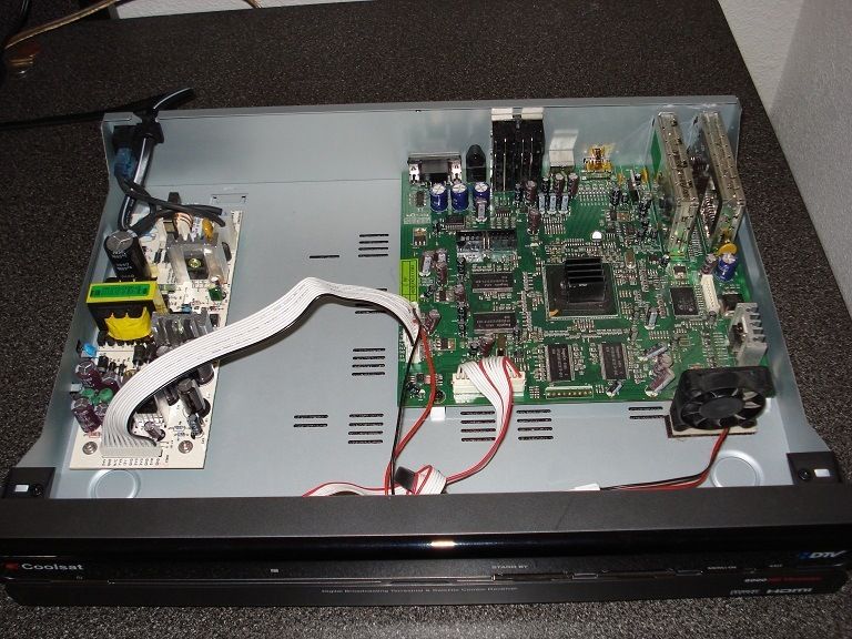

I will take a picture of mine today that shows the internal fan for ya. That will be later today after work of course.

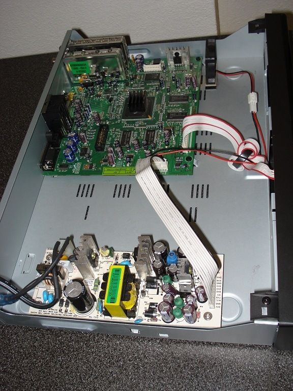

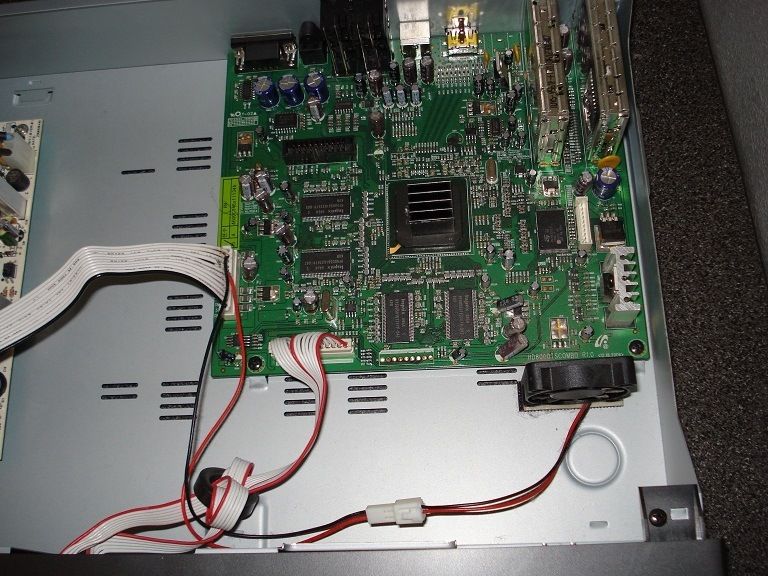

OK as promised, pictures of my Coolsat 8000 with internal fan.
very nice pics :)
I should put one in mine....heck there is enough room to put the guts for ANOTHER receiver in there :D
