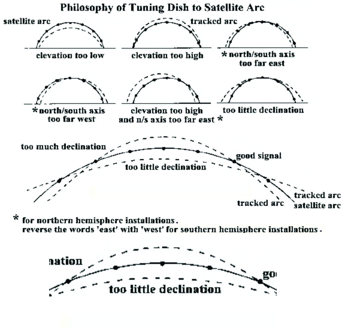

Look at our other posts. Especially the satellite arc chart showing errors and the solutions. Very helpful and valuable.

Personally I would start at the bottom inset of the attachment.
Figure out where the major tracking error is happening and then making adjustments to minimize them.
Then work wider and wider arcs.
Then work wider and

Okay. Let's take a more logical approach. Look at the diagram and try to digest what is going on with your tracking.

And again. When you get a pattern going. Look at the chart. It's right there. One of the hints will tell you what's up.

Chart time. Look at what's happening.
