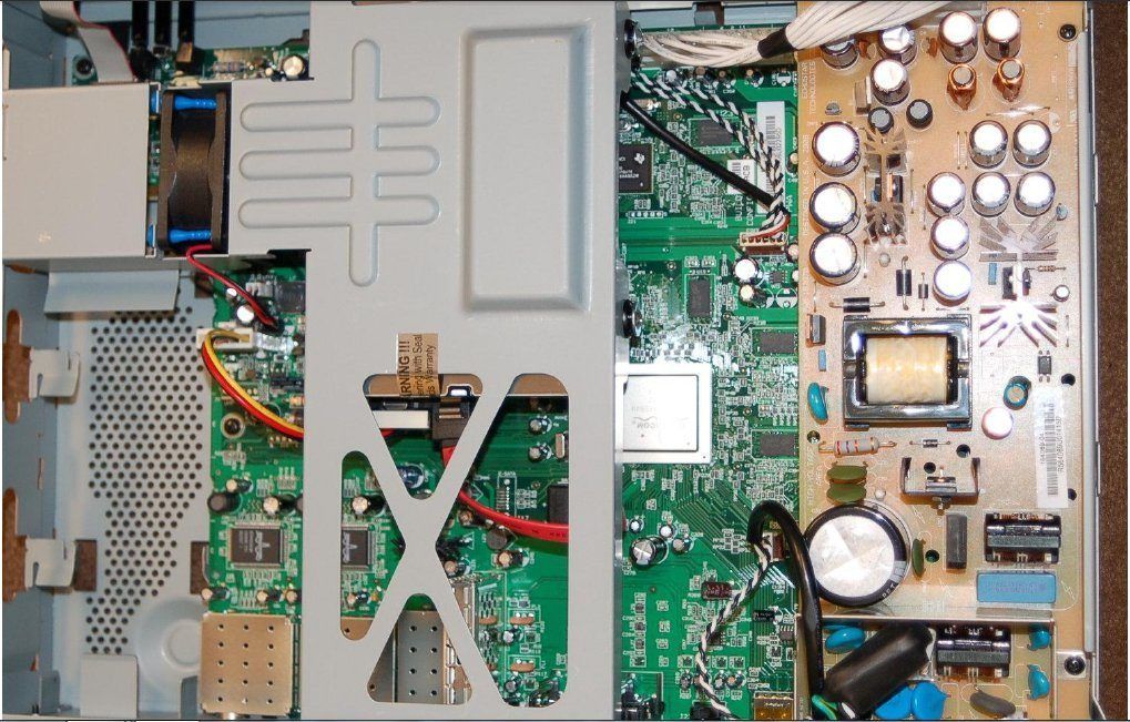

I would think the PS would have to be connected via wires, with or without connectors.
You would be correct, take a look at the top right.
(Thanks Scott for the pic)
EDIT: Just don't get yourself killed touching the power supply parts.
