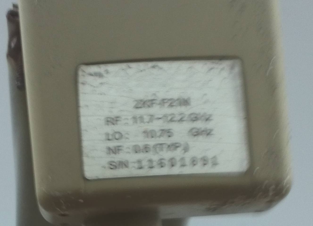

The LNB label says:
LO: 10.75
HF: 11.7-12.2 Ghz
NF: 0.6

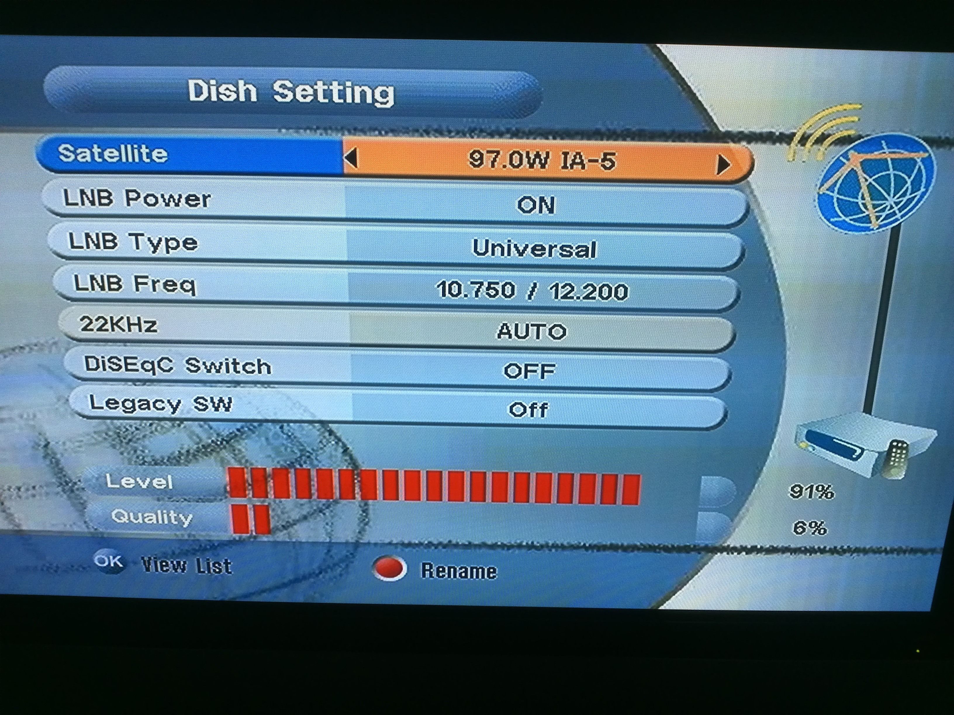

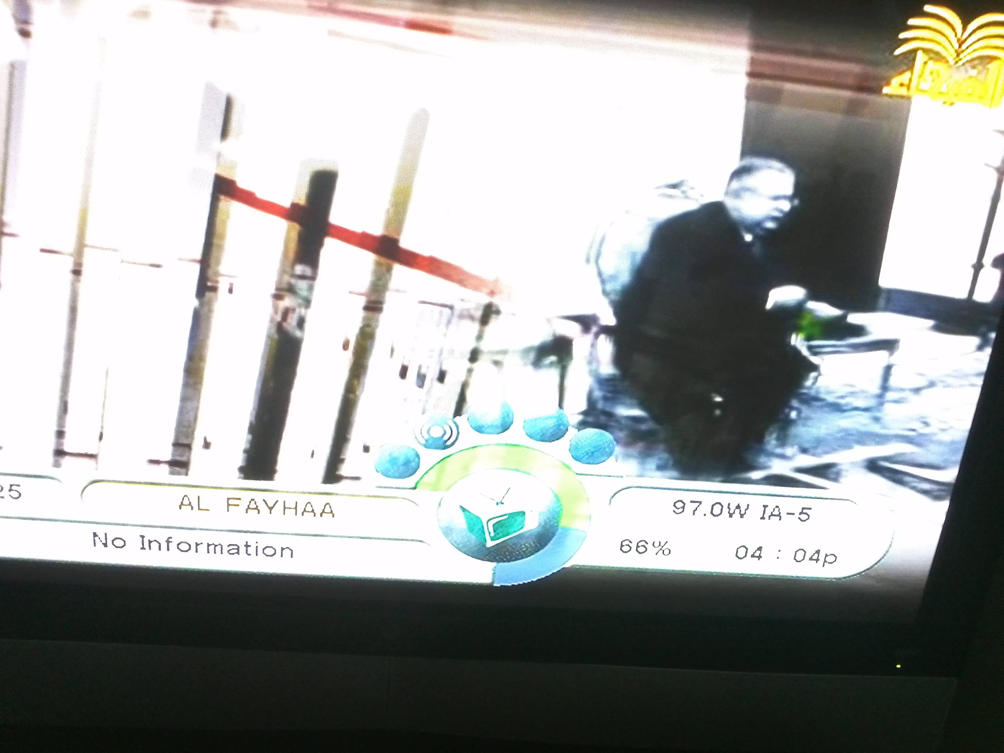

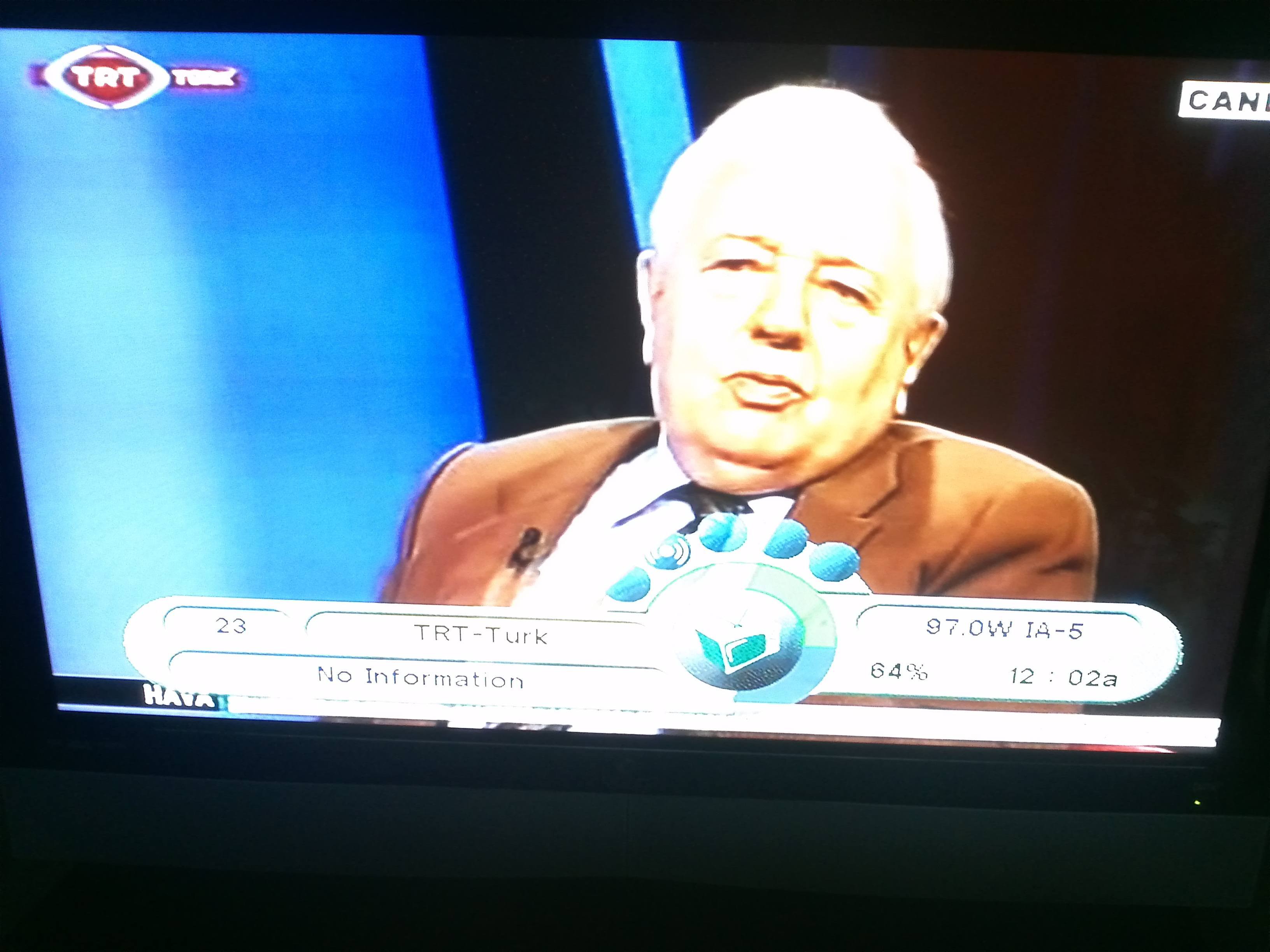

I've had the dish/lnb for 10+ years. The receiver for maybe 2 years. Signal strength has always been weak, but it seems to have degraded even further recently. At this point, if there is even light drizzle/overcast outside many channels are completely lost, and others appear as blocky picture/scratchy sound. It's time to address the problem. I went outside to take a look at the setup. The coax seems to be connected snugly to the LNB. I snagged a photo of the LNB the best I could. I went inside, and took a photo of my config screen also.
I'm thinking updating the LNB might be helpful. 0.6 dB seems really high compared to the newer lnbs that i'm seeing (just did a little browsing on ebay etc). So I was thinking I might change it out for an updated model with 0.1dB noise, and nice high gain. There is no switch involved, it's a direct connection from receiver to LNB. I might go out there with a ladder and try to move the dish up vertically a little bit and see if it improves the reception - just in case the dish is sagging over time. I tried adjusting the dish upwards 2 years ago, and didn't really have any measurable difference though. So I'm thinking it's probably either my settings on my receiver, bad rg6, or the LNB. The config screen on my coolsat shows 90%+ on "level", but the "quality" always shows very low <10%. When I flip channels and they lock in, they show signal strength in the low to mid 60s.

Change the LNB setup. Its totally wrong
should be SINGLE and LNB Freq 10750
one note on that. SatelliteAV (one of our sponsors) had a comment on that
http://www.satelliteguys.us/free-air-fta-discussion/275466-300khz-stability-ku-lnbf.html
I can slap any label I want to make "it look good and sell some" but you should get comments from other folks first. I think your dish may be out of whack a little bit. I have a Coolsat 5000 and a 30" dish with a .4 LNB. I've had the same setup for about 7 1/2 years now with only the LNB being changed out (and that was about 4 years ago) and it still works like a champ. (well I have switched the cabling too) I'm in Minnesota where it can get dang cold.
