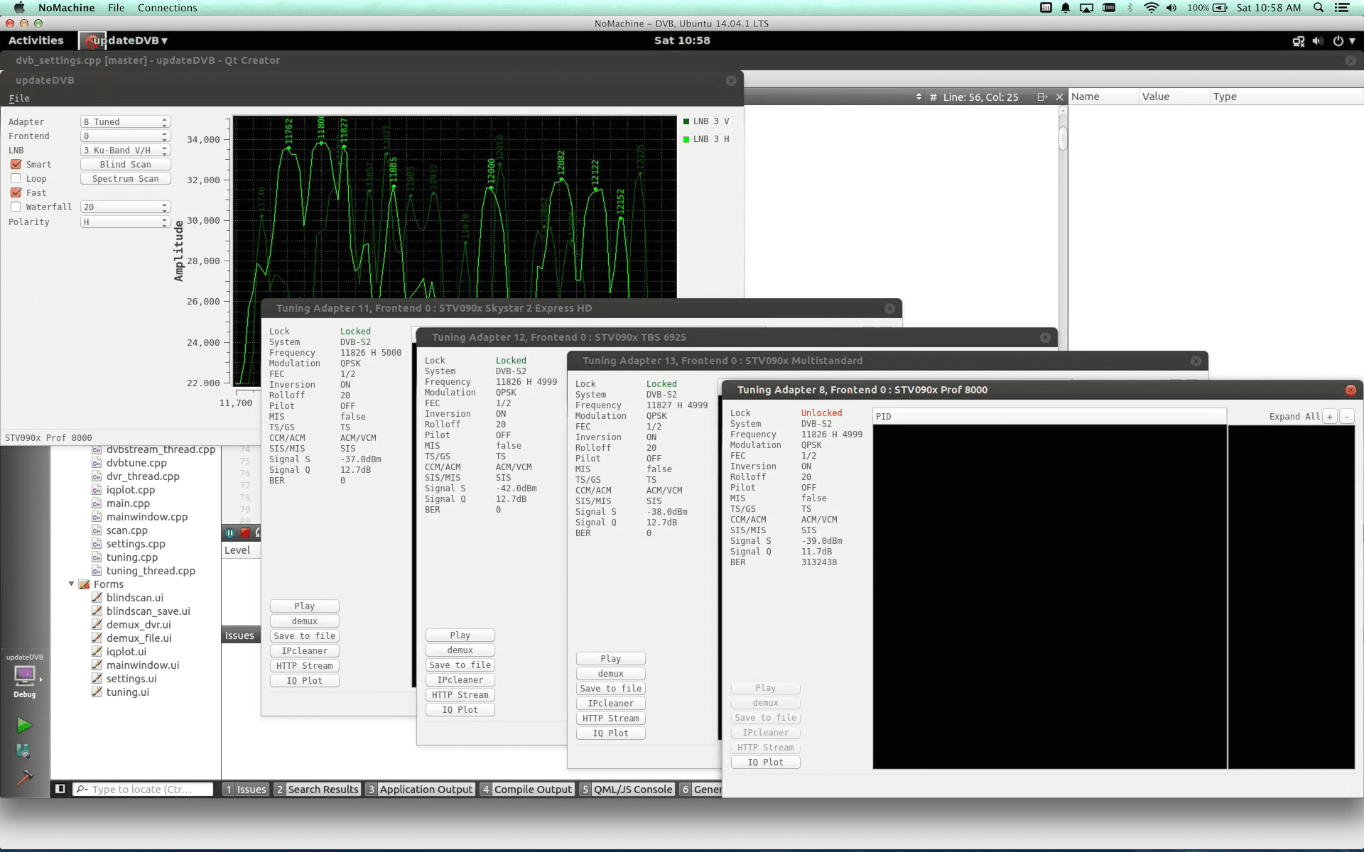

You'll notice is uses the cut 0x30 stv090x demod, and that there is two of them, its actually two cards in one. two different adapters.
You can see in the screencap the
TBS6925 stv090x cut 0x30 advanced
Skystar 2 Express HD stv090x cut 0x30 consumer
Digital Devices Cine S2 v6.5 stv090x cut 0x30 consumer
Prof 8000 stv090x cut 0x20 consumer
All three cut 0x30 have no issue locking and maintaining lock throughout modulation changes. the cut 0x20 loose lock with every modulation change and has a very high pretty much unusable ber.
The DD Cine S2 v6.5 has the same tuner (stb6110A) tuner as the Skystar 2 Express HD. This tuner is a little faster than the stv6100. Both devices complete a spectrum scan in 1.2sec. The TBS6925 (stb6100) completes a spectrum scan in 2.1sec.

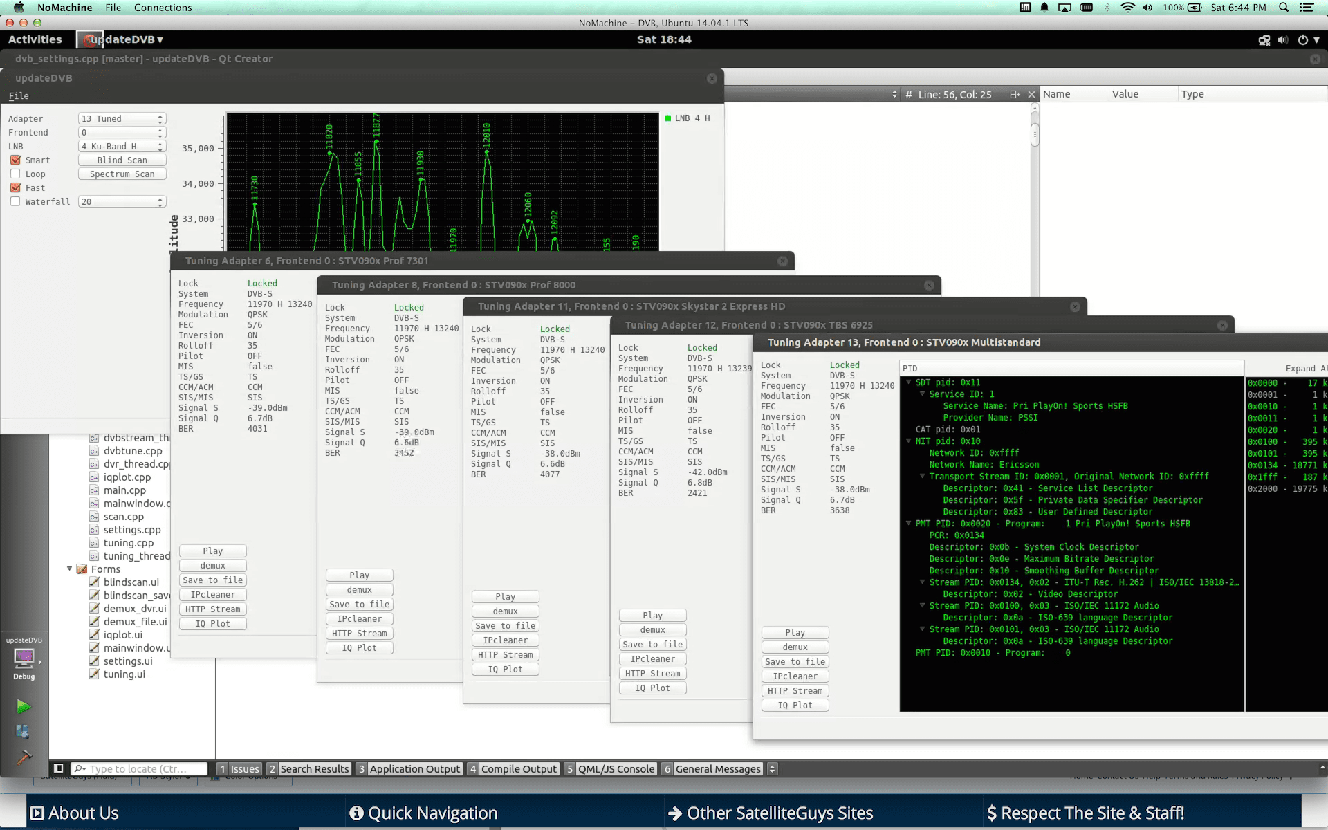

I only compared this tuner to other stv090x devices. Its performance is equal to all that I tested as you can see in the screen cap, the SNR is identical, the ber was the same as all the other cards when testing below threshold signals. Here is a screen cap of weaker signal tp. My app doesnt average, if it did you'd see the SNR and ber are all pretty much identical. Something Ive noticed but havent had much chance to test is that cut 0x30 seem to handle weak S2 a little better then cut 0x20. There are a few good choices for cut 0x30, the TBS6925 (expensive, but advanced model demod) and the Skystar 2 Express HD and TBS 5980 as well.
