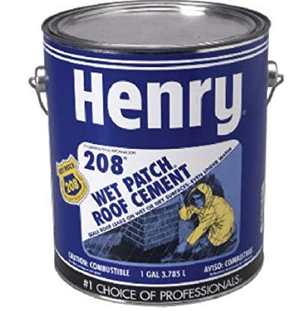

Either ...
If you remove it and seal it, your done with it.
If removing the foot plate will tear off shingles, then leave it on.
Either way, I would recommend Henry's roof sealant. You can get it at Home Depot, Lowe's or Amazon.

All of the wood is likely rotten under the shingle.
Pull the mast or shoe using a 7/16 or 1/2 socket or wrench.
Get some wet stick roofing cement and spread it over the are with a trowel or paint scraper.

Ceiling it with roof cement should work fine.
