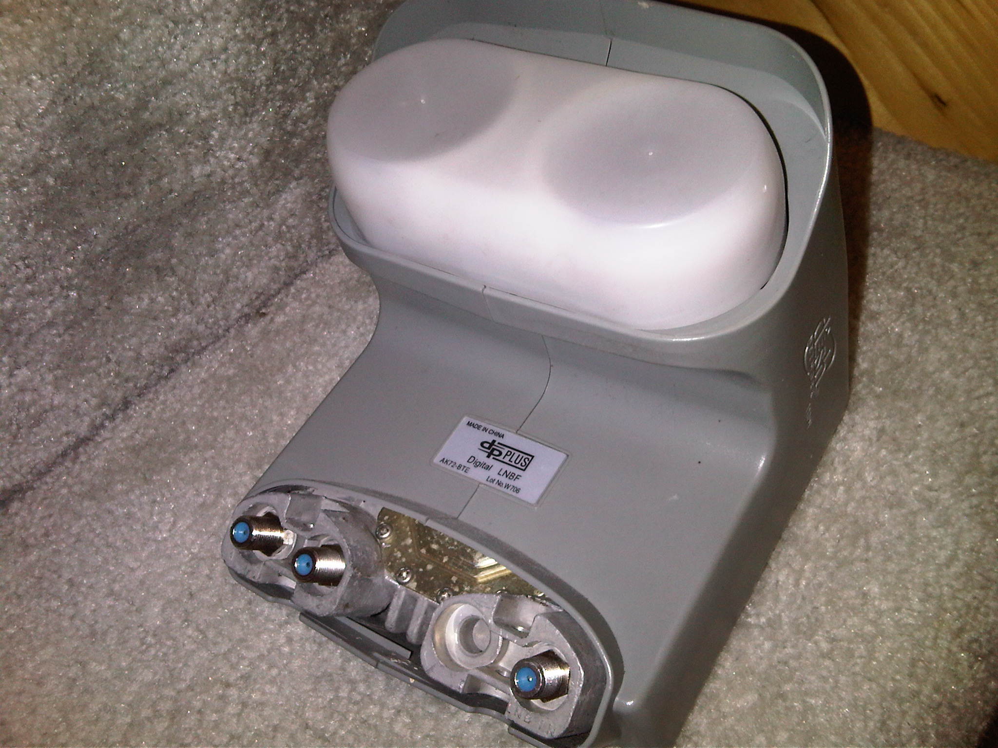

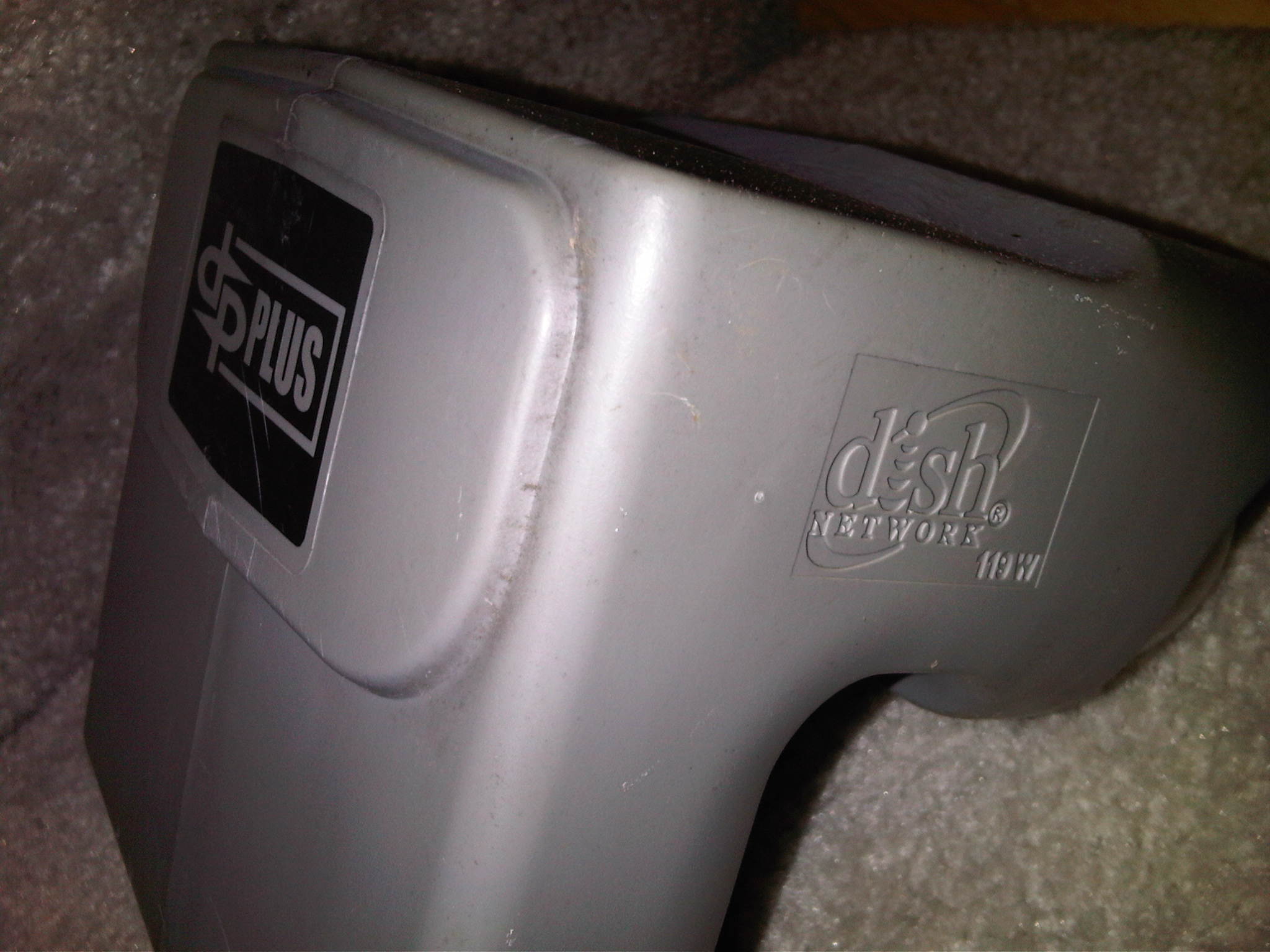

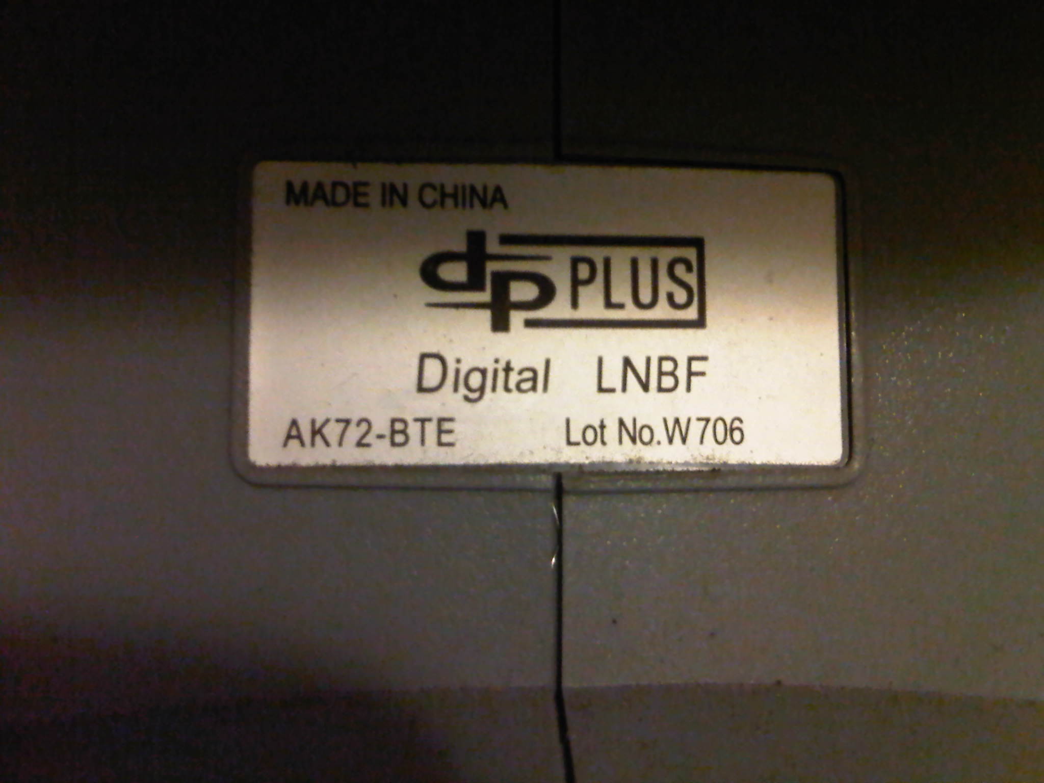

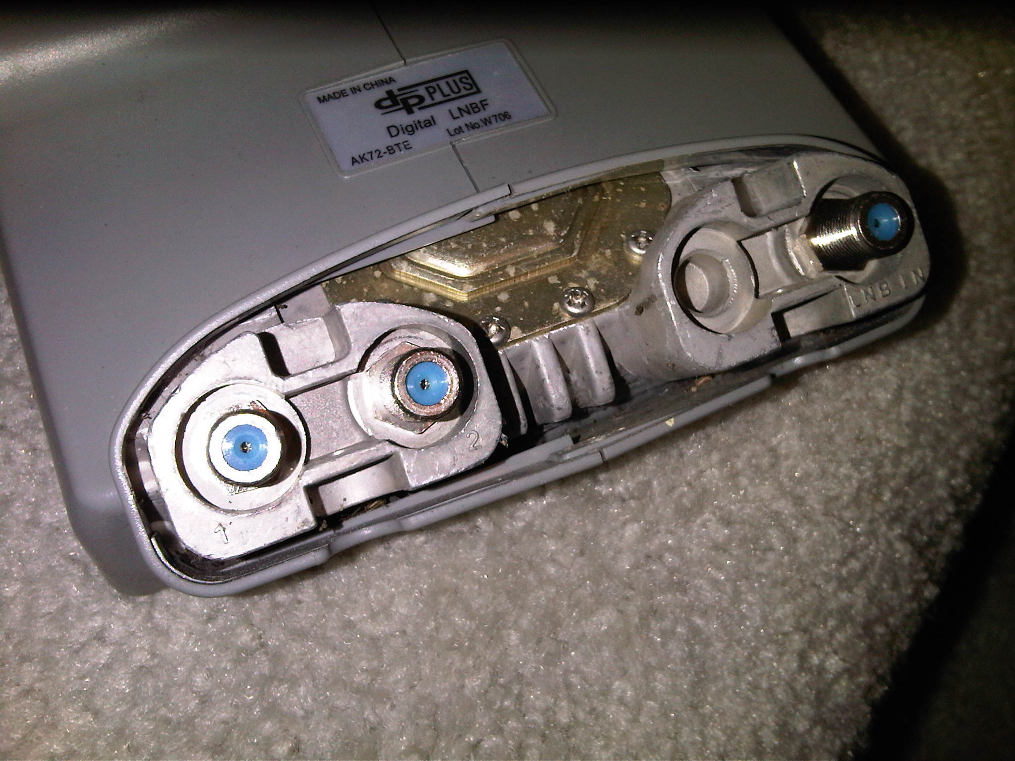

Attached are pics of what the LNB looks like (its 110 on one side and 119 on the other side). Was wondering if this LNB will work and I can just use one of the LNBs to point to just the 118.7 bird.

it wont work. You need the special LNB for 118.7
All of Dish's satellites (EXCEPT 118.7...I'm not including 121 as its used for businesses only) are circular polarity and work between 12.2 and 12.75 Ghz
118.7 is Circular polarity but runs at 11.7-12.2 Ghz (lower frequencies) so not to clash with 119.
the LNB looks like the one on the left. It has 119 & 118.7 in one setup with 2 separate connectors

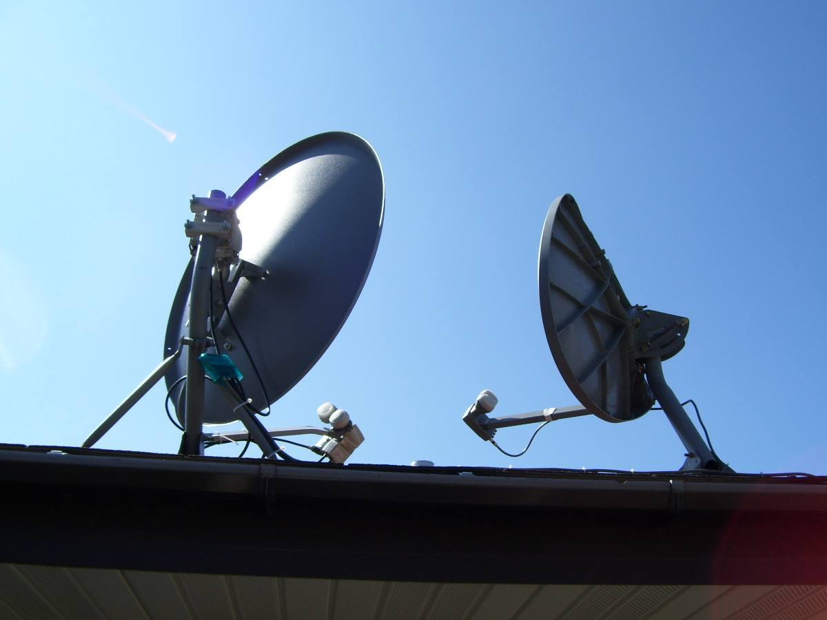

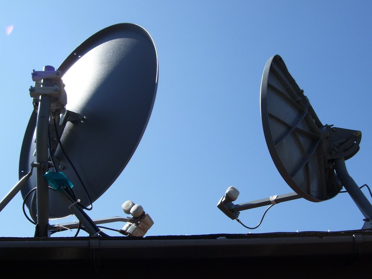

I've done a 9 elevation here in MN for a satellite. Remember the dish "sees" about 22-25 degrees higher than what the LNB looks like it is. Thats the good part of offset dishes is it may not look like its possible but it probably is (unless you have trees in the way)
The right dish is at 8.8 elevation. The left dish in those pics were aimed at 148 (15 elevation here in Minnesota)

I thought I was right when I assumed that the dish still sees 22-25degrees above the lnb, but that dishpointer website through me off where it says "elevation" and when you mouse over it says this is the actual elevation of the signal and when you click the show obstacles it shows another point where you can put further down the path to show what height that is. And say 60ft away I was getting only like 12ft on that mark which made me think "man im never going to even clear just a neighbors house".
But if its definetely 22-25degrees then we should be good. Dishpointer is showing like 10.6 degrees elevation, so we should be alright if you got 8 in MN.
