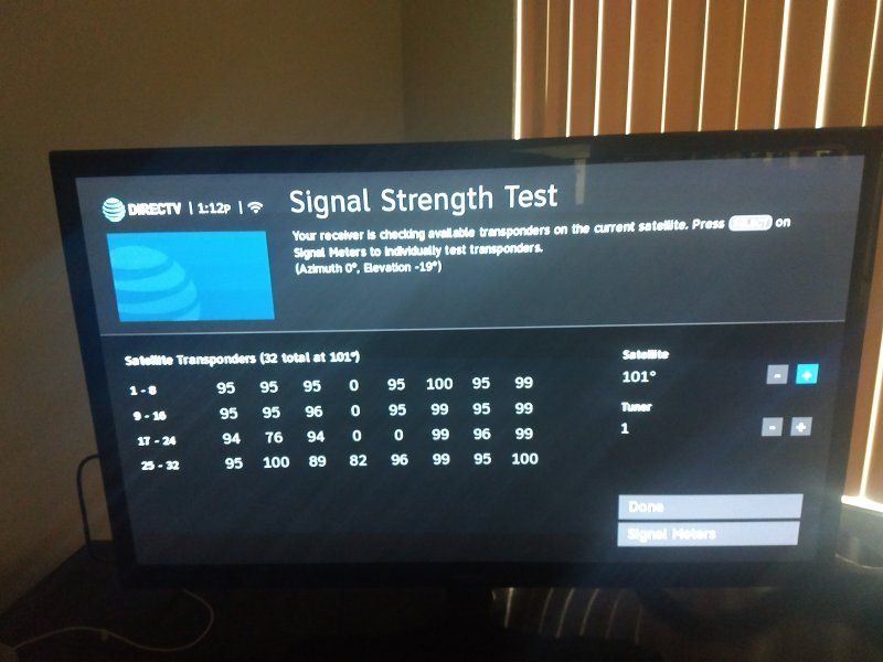

On all transponders? Can you post what numbers you have right now? You can exclude the 99s and 103s numbers.
How about the other four sats, 99ca/cb and 103ca/cb?
Whats up with all the zeros on the 101, the rest of the numbers on the 101 look right.
You should not have 4 zeros I don't believe, I never have.
4,12, and 20 are spot beams, I don't know about 21.
There are six spotbeams on 101 - 4, 12, 18, 20, 26, and 28. They should all be ignored.
That 0 on tpn 21 could indicate some sort of problem, unless Directv was doing something with it at the moment you did the readings and it really was 0 at that time.
