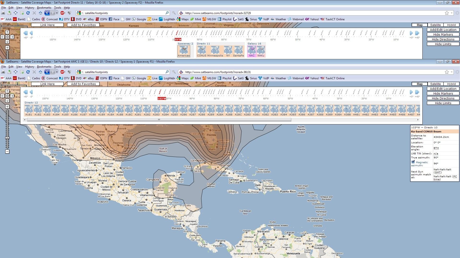

Here is DirecTV 11 and I see no footprint in that area. If someone else more tech savvy want to read these and chime in with details.

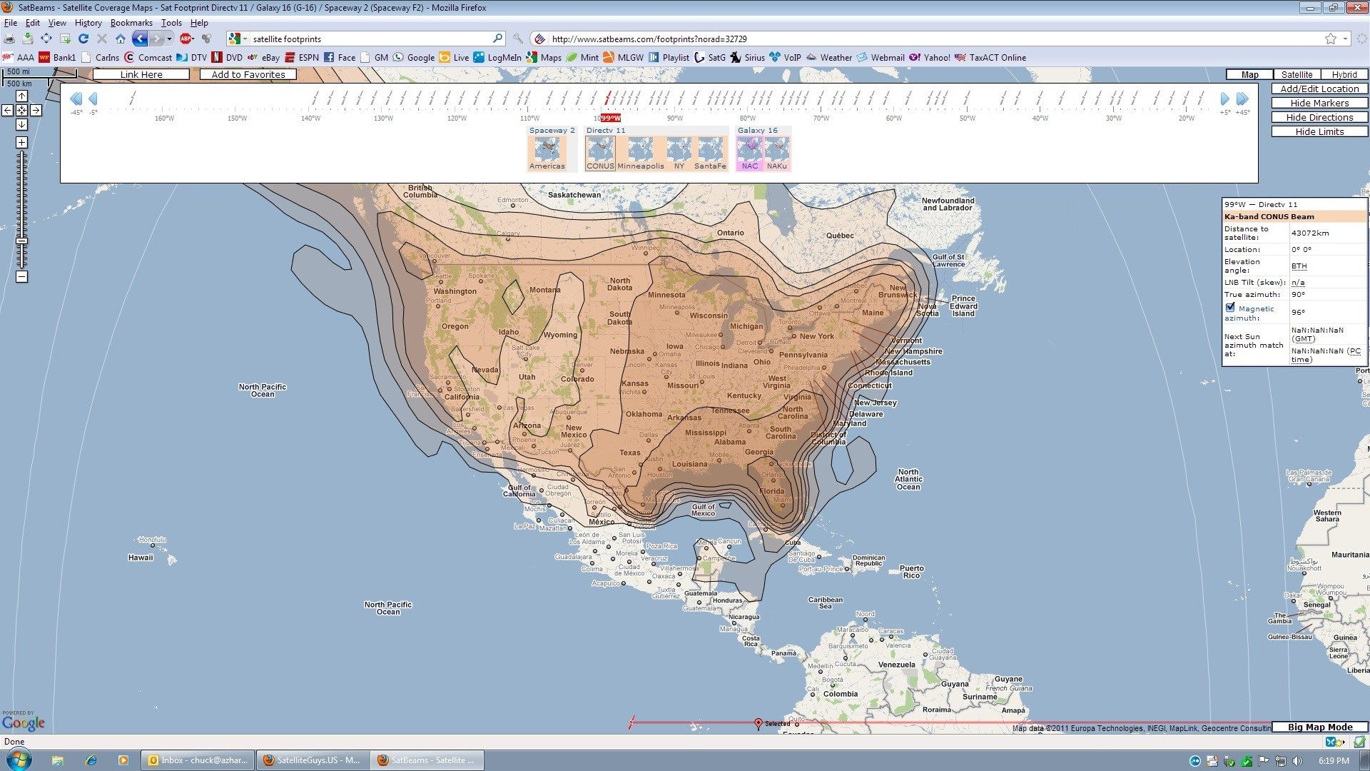

DirecTV 10 no footprint in PR or T&B
These are just a sample so not sure what success the OP will have
