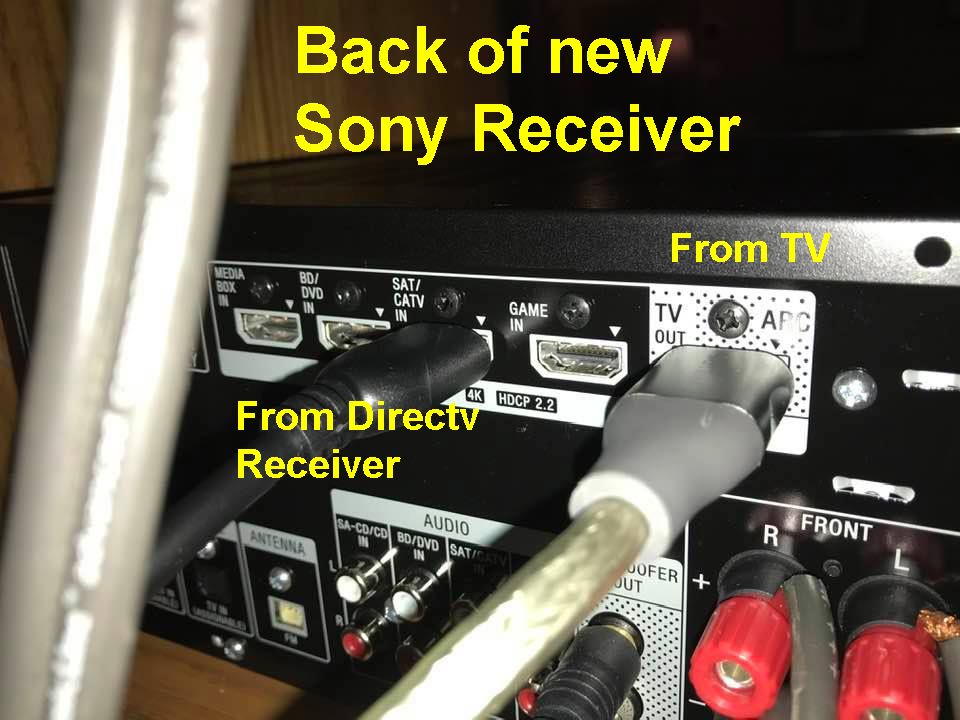

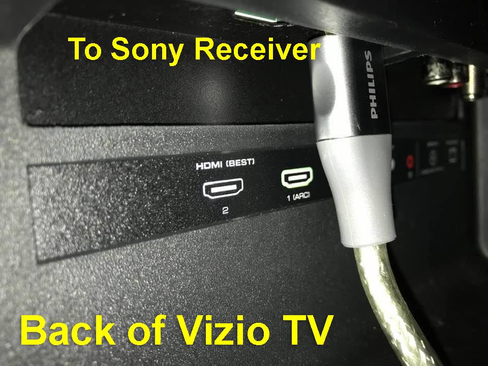

Okay, I have a silver braided HDMI cable plugged in the Vizio HDMI #1(ARC). That is the ONLY cable coming from the back of the TV. That silver coax goes into the A/V Receiver TV OUT(ARC). I have an HDMI cable coming from the Directv box, going into the SAT/CATV IN.
Sound works fine. No picture.
ON EDIT: When I press INPUT on TV remote, all 3 HDMI settings indicate NO SIGNAL...

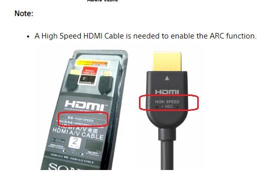

OP HERE AGAIN: I was reading the online manual for the Sony Receiver. The online version says that in order to use the ARC function, you must have a high-speed hdmi cable. (I didn't know such a thing existed!). Anyway, I've ordered one - won't be here for several weeks (so much for Amazon Prime). And the printed manual does not mention high speed. Sigh.
Don't bother with that ARC nonsense. It never works, and if it does, it will glitch a lot. Just follow Jimbo's optical audio advice. That always works and is fool-proof.

Here's the setup I have now and it equals SOUND but no picture. The sound is from the channel I have set on the Directv receiver. IF I move the silver HDMI cable over to #2 on the back of the TV, I get picture AND sound, but can't use TV's built-in Netflix/Amazon...I KNOW I'm missing something obvious!
When you are trying to watch from the TV, are you switching the input to the TV input on the TV? If not, it will not work regardless if you're trying to use ARC or optical. Just switching the cables isn't switching the input, you have to press input on the remote.
Reactions: Jimbo
OP HERE: With all the cable switching, I am not sure what I did, but IT WORKS! I moved HDMI cable to #2 on back of television (and it's still plugged into TV OUT on Sony Receiver) and plugged in the optical audio cable! I just tried Netflix and I have sound AND picture! I'll try Amazon later, but I'll bet it works, too!
