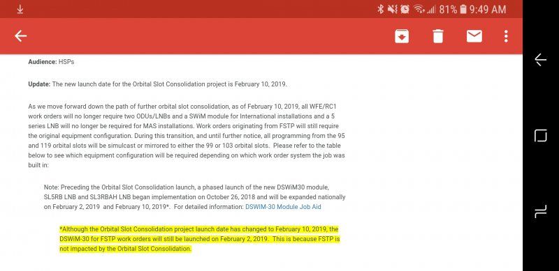

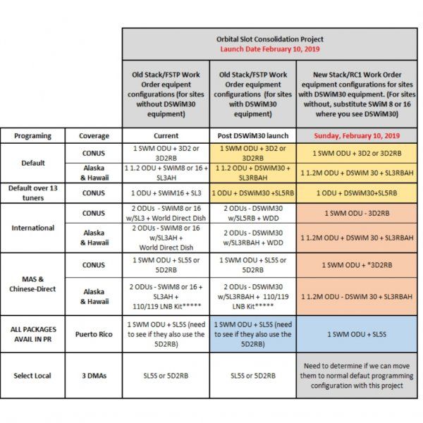

This is the consolidation changes
Very interesting and informative;
Thanks a lot for posting that ...
While most everything in the chart is as I suspected. What's surprising is that it appears that PR is eventually going back to using 110w or a re-biased 119w satellite as evidenced by still requiring a SL-5 LNB for all install WOs including those generated by the newest "stack."

The title says it all "Orbital Slot Consolidation"

That's only talking about Feb. 10th - 110 is still technically active for PR and will probably remain so until T16 launches and they reach their final satellite configuration. Just in case they need to move things around and PR needs 110 back for a short time when things are moved.
It also says that Hawaii will need the big dish - they will as of Feb. 10th but once D4S/D9S retire and T15 takes over the even transponders that should no longer be the case.

Ok, sounds reasonable ....
But I wonder that if this chart is to be rigedly applied as of 2/10. Does that mean if something goes wrong with my installation such as a bad LNB, and I call DIRECTV to fix it under my P.P.
Since with 1 Genie and 5 HR24s puts me under the "Default over 13 tuners" catagory.
Is the tech. going to insist on a legacy SL-5RB + DSWIM-30 installation?
Plus place NAS 9501 diplexers across the DSWIM-30's outlet ports to support my WH capability?
