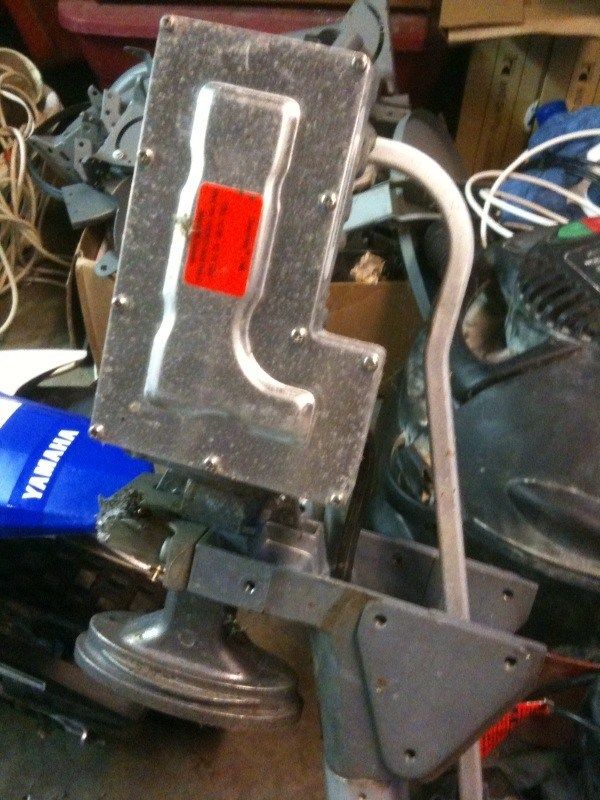

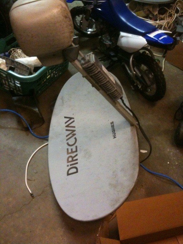

Here are some photos of LNB with this work for what im tring to do? the dirt on there is from the 7 bees nest that where in the gray plastic case that was covering this.

The DirecWay dish can be used for FTA and the LNB is most likely good (LNBs rarely go bad). I believe the HTS receiver you are referring to is an analog receiver, and will be of limited use since most FTA is now digital. It wouldn't be used to move a small dish like the DirecWay, but rather one of the older BUDs (8-10 foot dishes) that used linear actuators. You'll want to pick up a digital DVB receiver to be able to watch most FTA channels. Only DirecTV receivers will work with the flex port, so that will be of no use.
Intamin, you wouldn't happen to be a roller coaster enthusiast, would you? I ask because Intamin is a coaster designer and manufacturer :) ...
EDIT: The DirecWay dish you have pictured has a strange LNB/feedhorn combo... It appears that the LNB may be specialized, perhaps Ka-Band, but I'm not sure. If it is, you will need to replace it with a standard Ku-Band LNB, and do a bit of retro-fitting.
If there is a way to mount an LNB like a Invacom QPF-031 to the feedhorn on the dish I think you would be much happier. I use to have that same dish for internet years ago, so I cant remember how that feed horn hooks up. Judging from the one picture, it can't be done, this hobby is all about aggravation (I mean fun) anyway

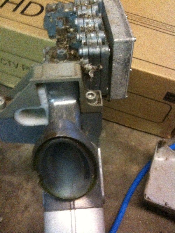

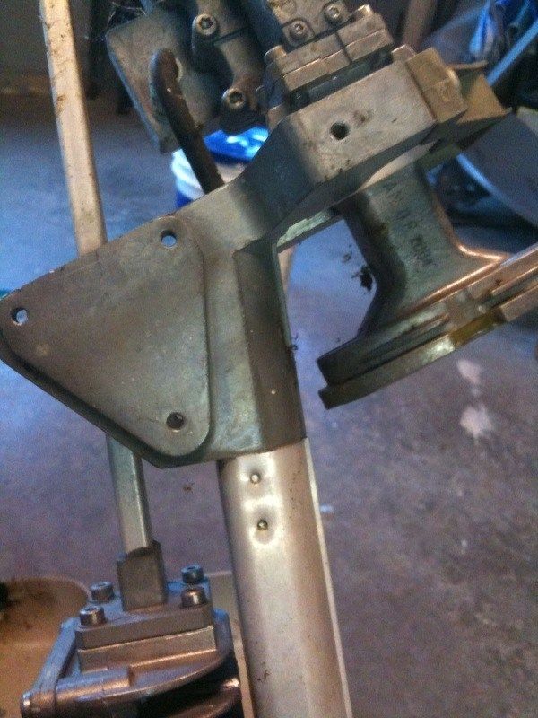

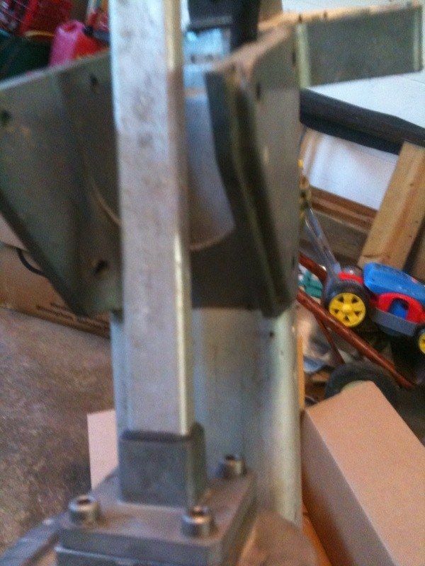

Here are pics of feed arm it looks to me that the lnb is pressed on with 2 indent on the side.

It's difficult to tell from your pictures, but I don't see anything unusual about your DirecWay feedhorn nor LNB.
You might look to see if there are any markings on it.
There are at least two models. Mine has a rectangular looking feedhorn.
Many have an oval feedhorn like yours.
You don't want to connect to the finned transmitter slung blown the LNB support arm.
There should be an obvious connection just to the LNB itself.
Much of that plumbing is to keep the transmit signal out of the LNB. :)

First, you don't connect any cables to the amp on the ARM and i found leaving the amp in place was the easiest.
Second, you have to take off the big bulb like thing that covers the LNB in order to connect it - - - this is especially true if they just cut the COAX off. Beware of bee's as mine was full of bee's nests.

I didn't replace anything on mine, I used it AS IS and it works great.
I put a cookie dough container over the end to keep the water out. And my neighbor helped me remove the heavy transmitter thing from the arm, he said it was totally not needed at all. He put some duck tape over the hole where it came apart to keep bugs out and that was that. I use that dish to get Retro TV on 83 and it works really great. It's a linear lnb according to what I've been told. Just a weird looking one.
