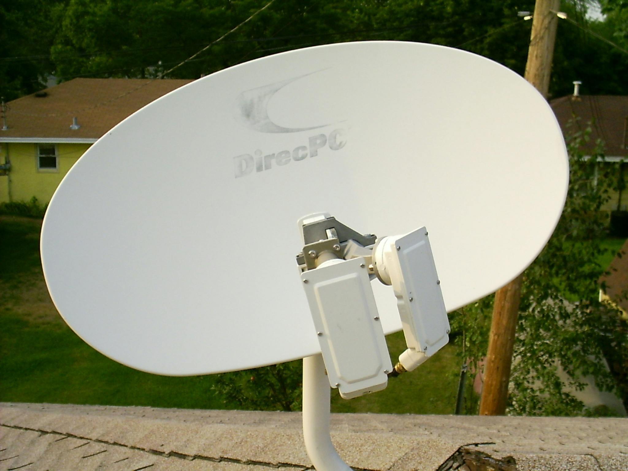

I use a few DirecPC dish with the single DirecTV LNB to the side, they work great but if you need the Phase III 3 LNB type Dish the Channel Master (Gain Master)is the way to go! If you are only pointing at the main 101w DirecTV this dish will work, or even better a 30" dish with a DirecTV LNB would really help with rain fade.
