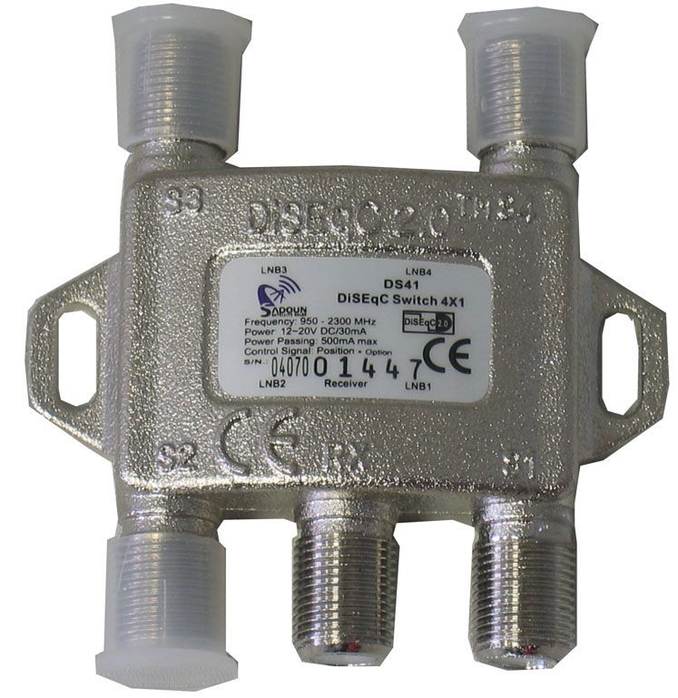

Iceberg,
We do have the four ported naked switch, the new DS41. It does not have the weatherproofing cover as the DS41C and should only be used indoors.

It was indeed the S-DS41C (first pic). By the way, the "cheapies" comment was not about Sadoun, but about the switch. It was cheap and on sale when I got it. One went from 4 ports to 2 ports in very little time. The other went from 4 to 3, and hung there for quite a while, but recently dropped down to 2 working ports.

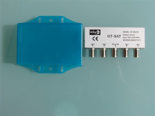

This is the cheapy model DS41E 4x1 switch I have used for some 5 years with no problems even in intense heat providing it is shaded. It also handles the motor current draw. The weatherproof casing covers all the connections. Strangely the 2x1 model I found susceptible to braking down in intense heat and returning to life when it cooled

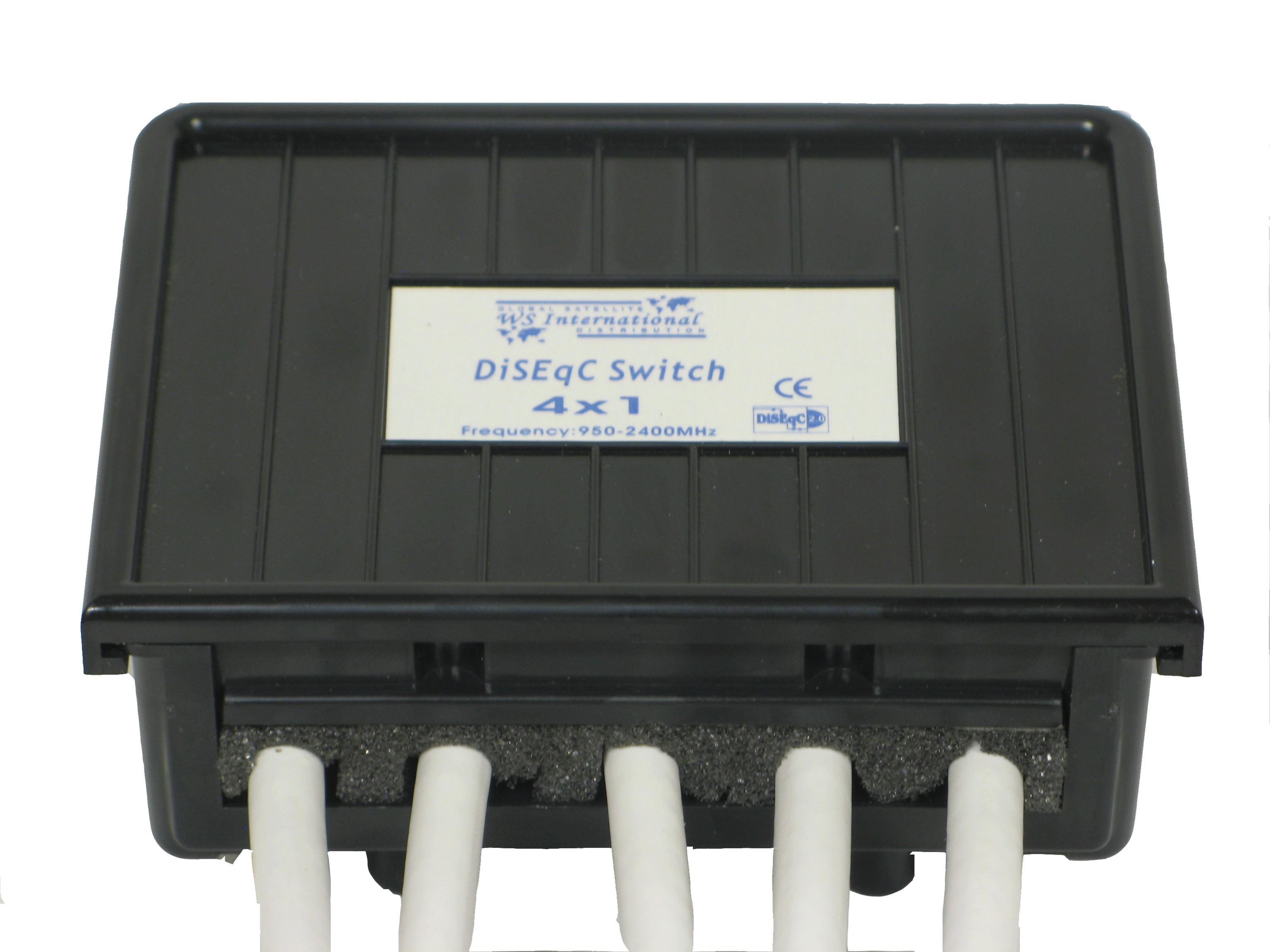

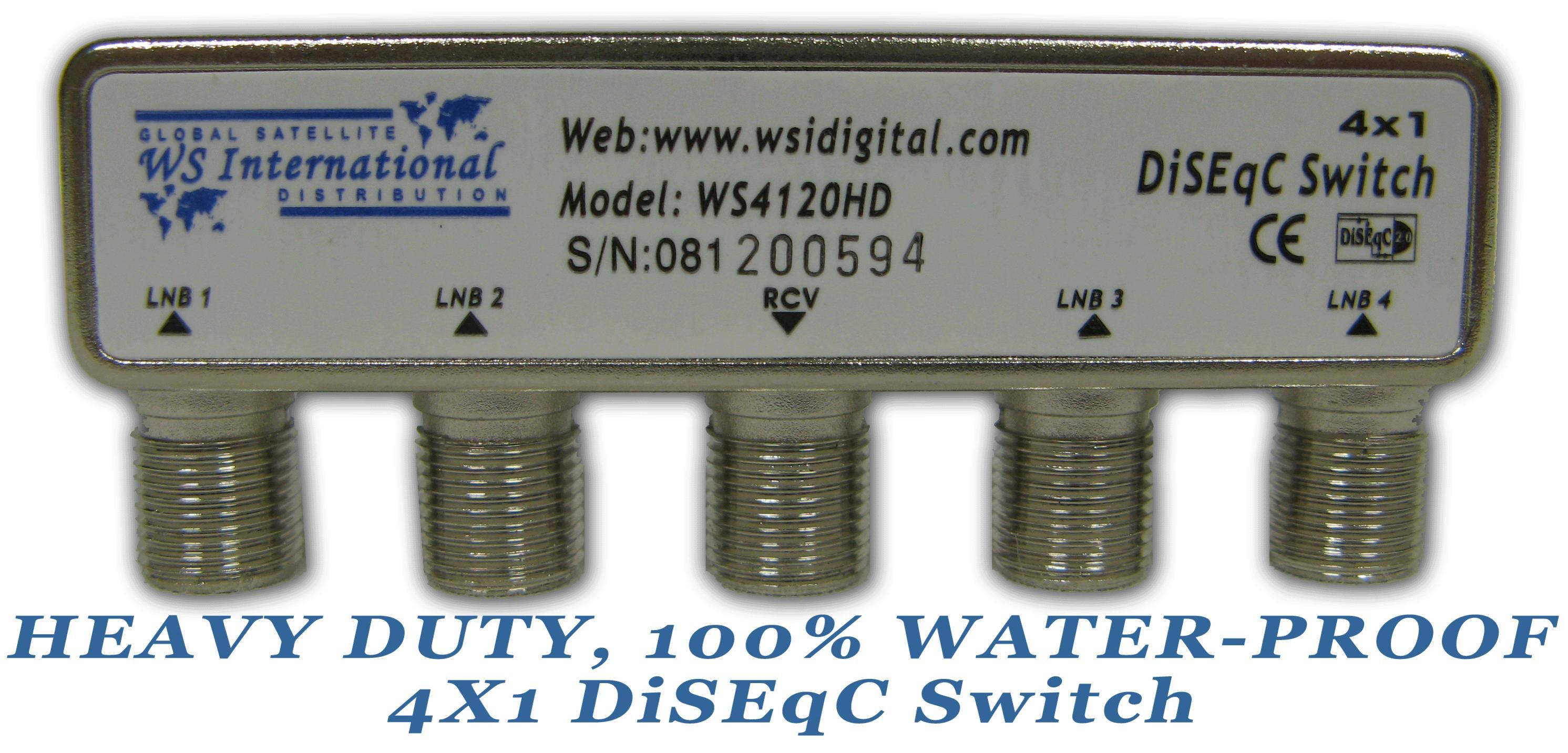

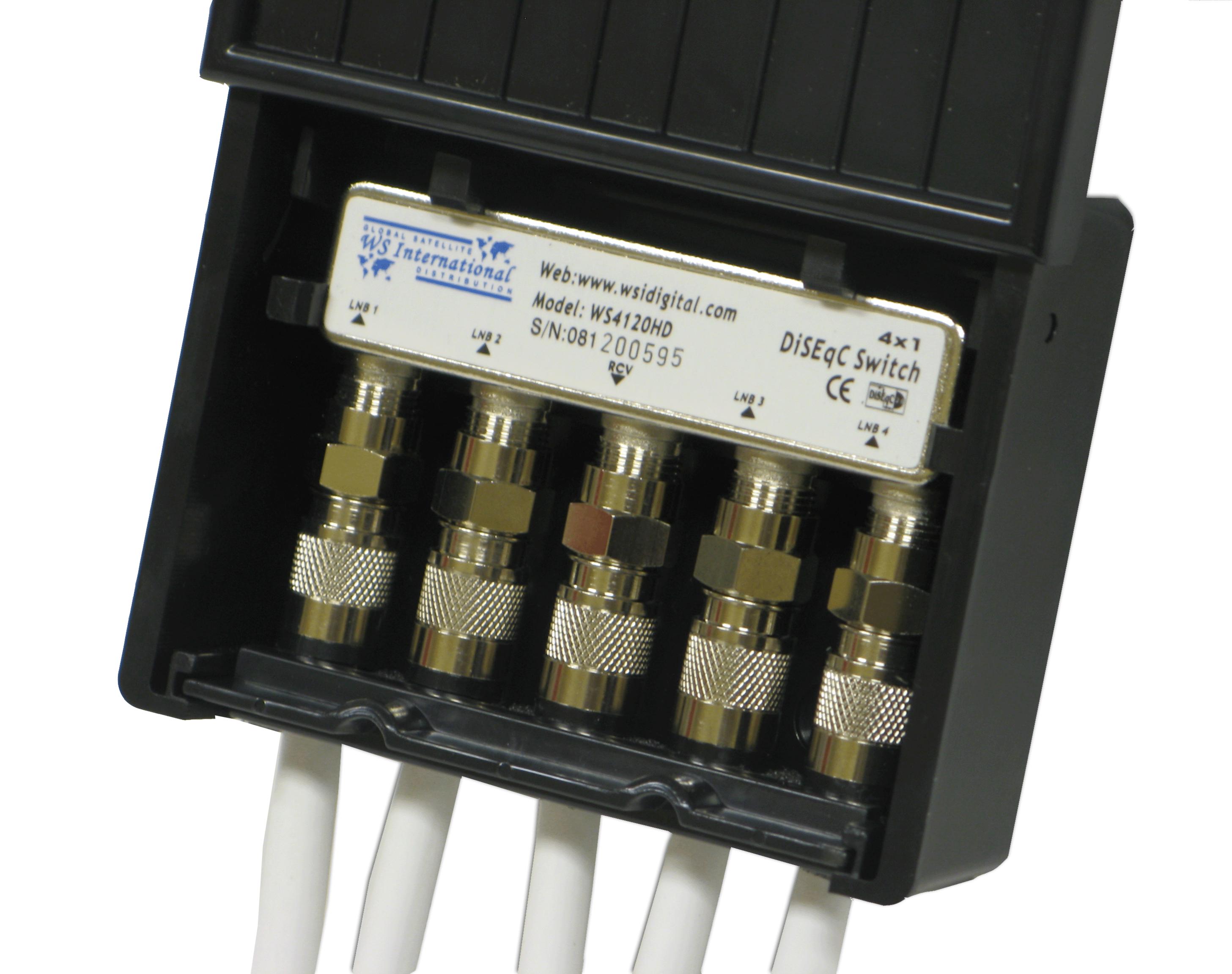

I guess I'll put in my 2 cents also... We've been selling the WS4120HD with good luck. I think after selling thousands of them, we've only had half a dozen or so come back.... It comes with water-proof box and is mountable either on a pole or wall.
