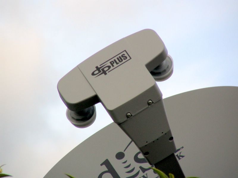

Is this what yours looks like:
Or is it this one:
If its the top one you need a Dish Pro Plus switch (either a DPP33 or DPP44) between the LNBs and the receiver. If its the bottom one you just need a piece of coax from the dish to the receiver.
You can use a DP34 switch but for the dual tuner to work you will need 2 lines going to the back of the receiver instead of just the one.
Or is it this one:
Yep it's the bottom one. Thank you.
