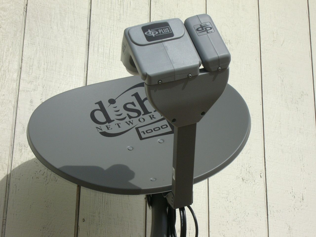

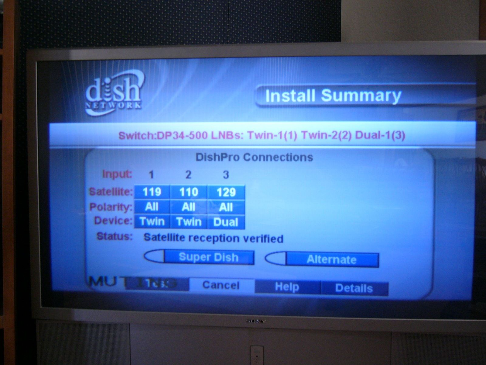

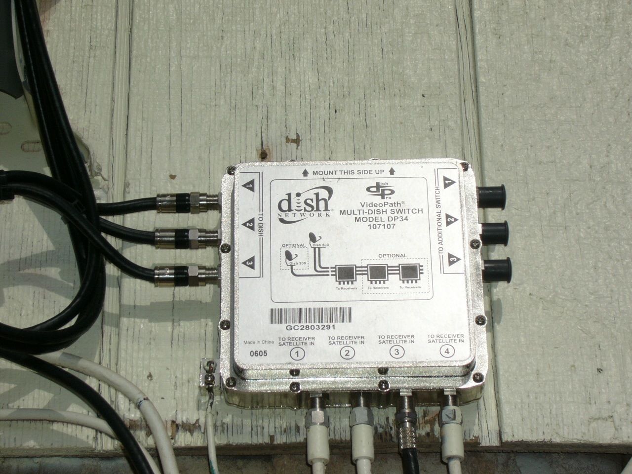

I also thought that the DPP Twin and the DP34 were incompatible, but when my Dish 1000 was installed, that's what they used. The only issue was that the Dual had to go directly to the DP34 input, along with the DPP Twin.

No problems at all. This has been rock solid for me, just as the DP Quad before it was. I was hoping for, and expecting, a DPP44 with the Dish 1000, to hookup to my four receivers. But this does work, so I'll stay with it until I have dual-tuner receivers.
It will work since he has 4 single tuner recievers, if you go to a dual tuner you will need to replace the 34switch or run anoither line from the switch to the reciever. Jus a couple of comments on the install, did you use the metal staples on the cable, why is it grounded to the switch and by the way, nice crimped fittings.
For the most part, I have nylon cable clips, but the installer did put a couple of staples. I'm not an expert on grounding. Shouldn't the switch be grounded?
Grounding at the switch is ok, and yes a dpp twin will work fine with a dp34.

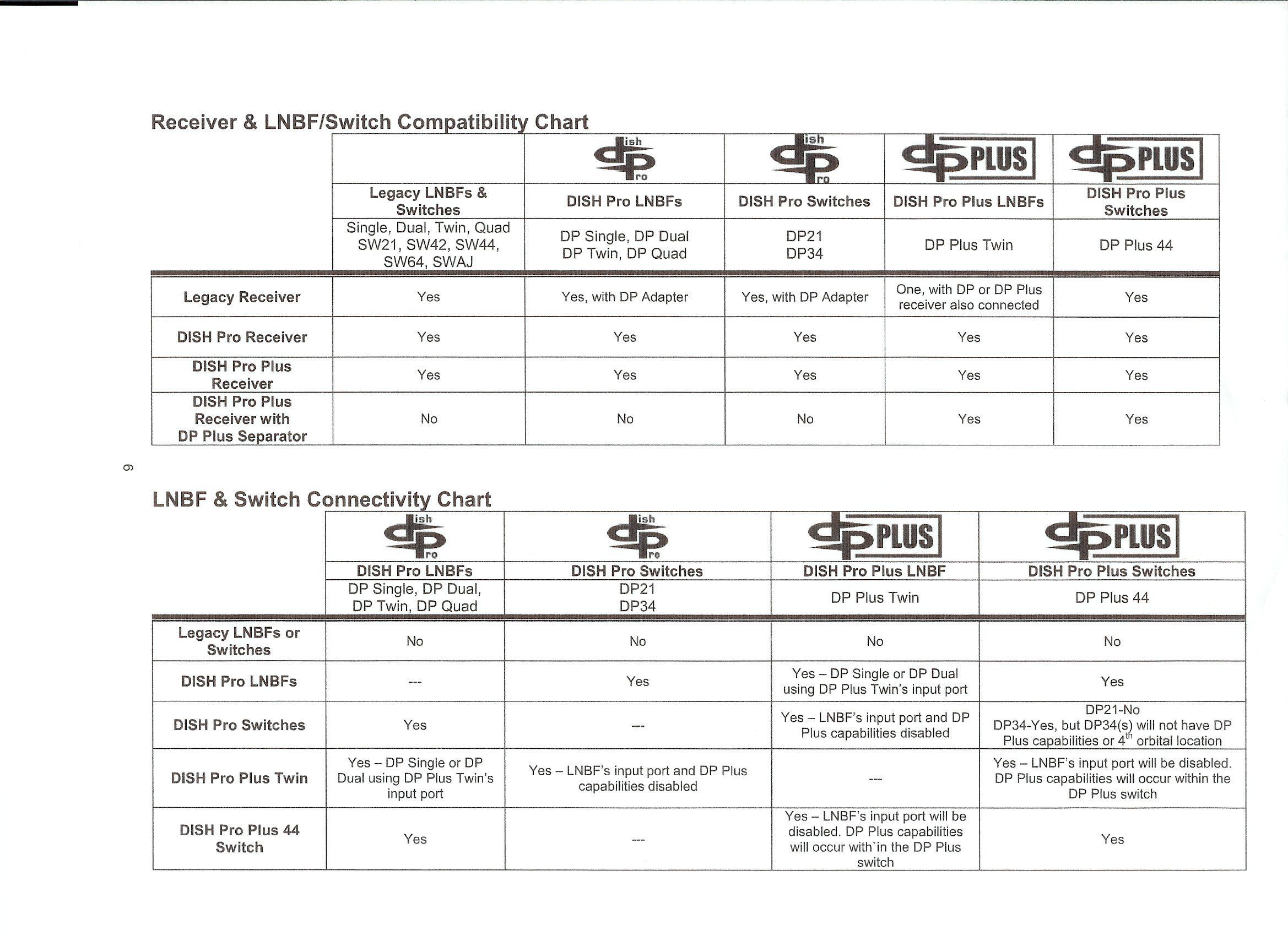

Dish's Switch Compatibility Chart indicates that you can use a DP34 with the Dish Pro Plus Twin that comes as standard with the Dish1000; however, if you do so, the LNBF's input port and DP Plus capabilities become disabled.

Do you have a link to the Dish's Swith Compatibility Chart? I saw it somewhere before but can't find it.

Don't have link, but attached is a scan of the chart. Bob
