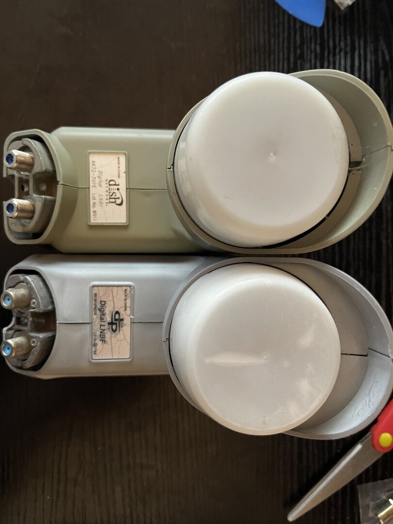

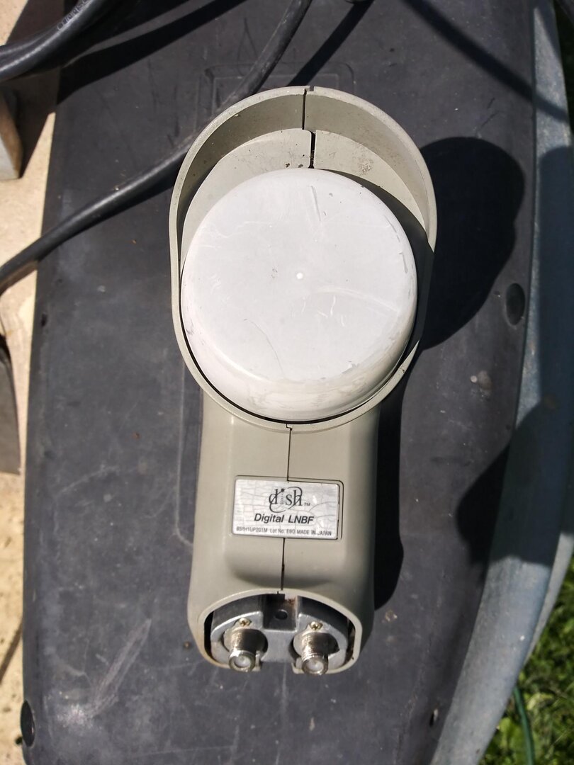

I have this Dish 1000+ setup and working very well with 110, 118, and 119 sats. Unfortunately on the 129 side LNB I am only getting a signal on the odd transponders. I get nothing on the even transponders and I have peaked the level to make sure it's maxed out. I have 2 LNB's I have tried and have swapped the cable running from the 129 LNB to the #4 input. The only thing at this point is it a legacy LNB and won't switch by itself. I have uploaded a pic of what I am using. It's the only single LNB's I have sitting around. Is it possible this is the issue??
You cannot intermix legacy (voltage switched) LNBs with DishPro bandstacked LNBs. If it really is a legacy LNB, then that is your issue unless there is some sort of 110/118/119 LNB I don't know about.
Yep, that's definitely your problem. Legacy equipment would do either even's or odd's with voltage switching, 13v for one and 18v for the other. Not sure of the order (guessing 18v=odd's). Dish pro switchgear will run at 18v only and needs DP equipment, because Dish Pro is the ability to have both E&O on one line without the need of voltage changes. So you need a DP Single or Dual to have the switch in the 500+ get the satellite in its entirety.
So good news, finally got my Dish Pro LNB and got it mounted yesterday. Took my temp antenna pole and found the sats and great news, I now get even and odd transponders on all 4 sats. Gonna wait for a cooler day to install on the Dish pole, 90's heat index next 2 days. I will post when I do but am now finally happy I got this setup running as it should...
