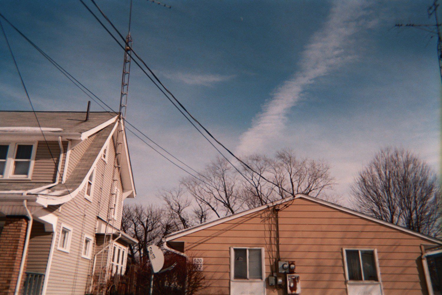

For what it's worth, here's my current setup..Sorry about the picture..Only one I have currently
