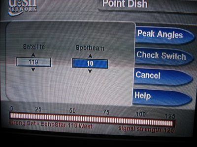

I get pretty strong signal for 110 (up to 125 sometimes) according to the Point/Signal option and a satellite finder tool. Unfortunately, when I try to see the signal strength for the 119, I get ""Wrong Sat -- Echostar 110 West" in red at the bottom of the screen.

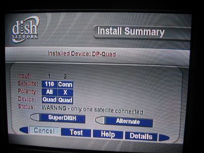

When i first installed the switch I did a switch check and as installed device it said SW21. Due to lack of 119 signal, I tried switching the cable connections to the switch and when I did the switch check again it said Device installed: QUAD DP. It has stayed with Device installed: QUAD DP since then even after switching the cables back. It also says: WARNING only one satellite connected.

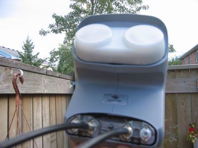

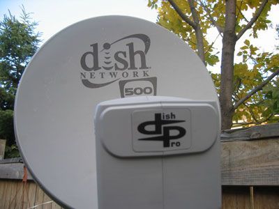

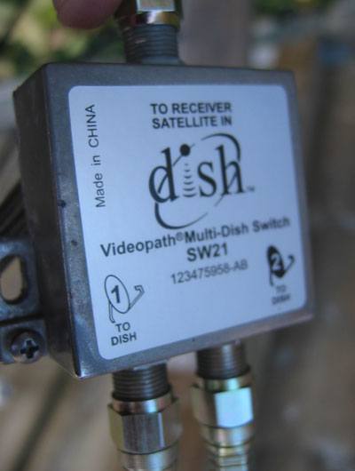

See the attached images for the one I have. Should it not be connected through a switch to merge the 110 and 119 signals?
I will try to move the dish a little to see if i get any results.

Nope the switch is built into the LNB on twins and quads.
Switch is only necessary if adding a 3rd sat in your situation.
Also that's not a DP21 so it wouldn't work anyway. That's a legacy SW21.
Remove the switch altogether and re-point your dish and baring any LOS issues you should be good to go.
By the way this is a DP21 http://www.satelliteone.com/dish/images/dp21.jpg if you ever decide to add a must carry dish.

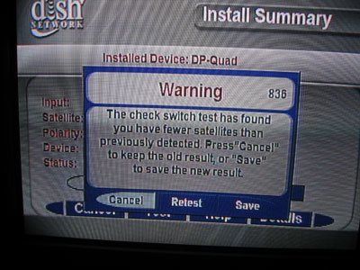

Ok, so ... I connected it with one cable directly from the dish to the receiver as well as moved it around for a while to see if i could find 119 but nothing. I can still see 110 fine though. Should i continue to try to find 119 ? or?..
See the images below.
1st image: after connecting it with one cable and restarting receiver & going to point/switch option
2st image: after running check switch
3rd image: 110 signal strength
3rd image: attempt at checking 119 signal strength

With no cable connected to the receiver run a switch test. It should run 38 tests and find no switch detected. This will reset the switch to factory settings with no satellites detected.
Loconet: Your second picture tells the story in it's entirety.
When using a Twin or Quad, the first column is the 119 eye, the second column is the 110 eye. ALWAYS!
Therefore, "110 X" means you're pointing 9 degrees too far east.
For completeness, "X 119" (or more likely "129 119") means you're 9d too far west. And finally, "X 129" is 19d west.
