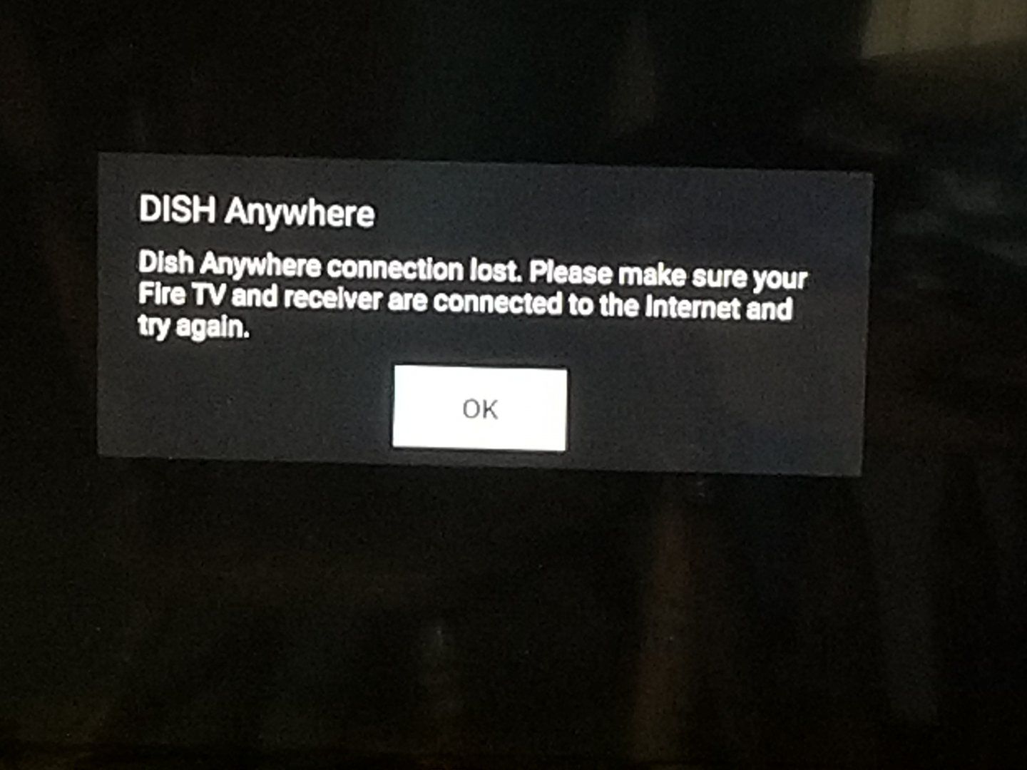

I replaced my two Joey's with 4k Fire Sticks a month or so ago. Dish Anywhere was working just fine without any major issues until this past weekend. Now when I try to watch anything (from the guide or DVR) it gives me the attached error message after several seconds. This is occurring on both devices. The only thing that fixes the problem is a router re-start. This however only gets it working for about 24hrs. then I get the same error message again the next day.
This all started after I took one of the sticks on a trip. As soon as I got back and re-connected it to the tv I started getting the message on both tv's. The only other recent changes were the cancellation of the two Joeys and dropping to the Flex pack. I haven't made any router changes. Any ideas? I really don't want to re-boot my router everyday:(

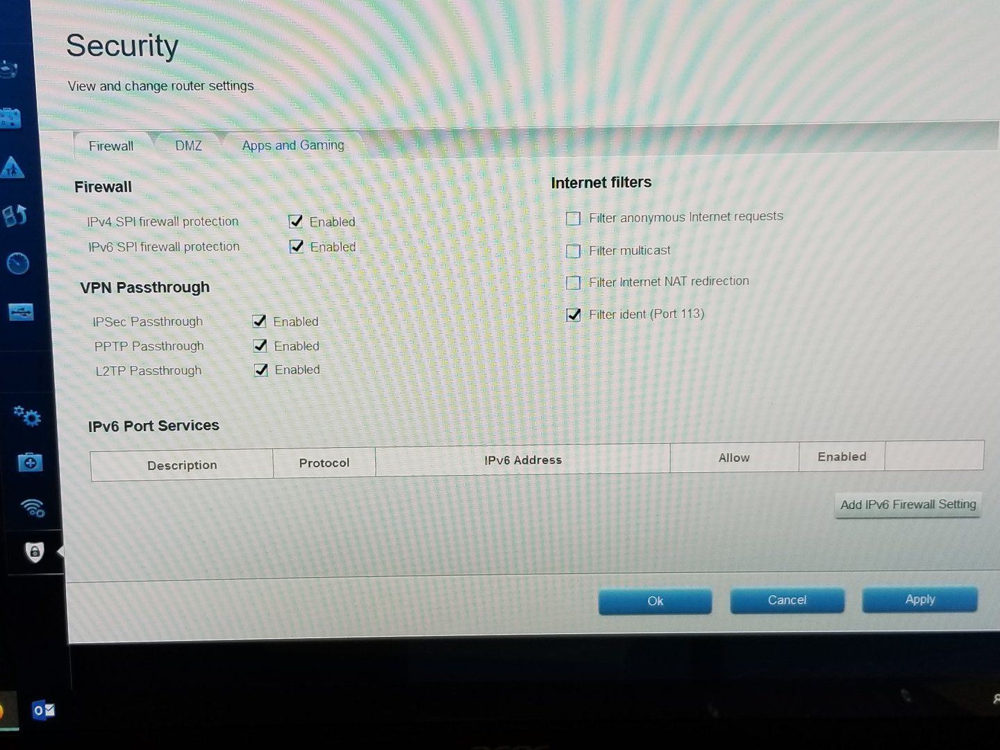

Here's a picture of the security settings on my router. I turned off filter anonymous internet requests before taking the picture thinking that might be what you were referring to. I didn't see anything related to "whitelisting". For reference I have a Linksys EA-7400.20190531_104236.jpg
Here's a picture of the security settings on my router. I turned off filter anonymous internet requests before taking the picture thinking that might be what you were referring to. I didn't see anything related to "whitelisting". For reference I have a Linksys EA-7400.View attachment 139018
Two things:
1. In the troubleshooting screen, see if there is anything in the logs referring to the Firesticks or Hopper or their IP addresses.
2. I'd be interested in seeing what is under the Apps and Gaming tab.

I had logs turned off but when I turned it on there were several listings for the sticks. What should I be looking for there? Since I re-booted the router this morning all is working so the log may not have error listings for the sticks right now.
Under app's and gaming DDNS was disabled. All three port settings had no values.

Maybe this model gets automatic firmware updates?
Yes I do have the auto update box checked.
Well, my guess would be that they pushed out an update that has some functionality which detects the DA traffic between the Firesticks and the Hopper as undesirable and blacklists it. I'd contact Linksys support and tell them what the problem is, and see if they have a workaround. The documentation is pretty thin on this model, so I am not entirely sure what options exist for whitelisting the traffic between the devices involved in DA.
That could certainly explain why this started suddenly like it did. I'm going to try resetting the router to it's default values to see if that does anything. That fixed a problem I was having a few months back where the router was locking up about once a week. Then we had no internet until I re-booted the router. The problem is different now because everything is working except DA. After that I'll try calling Linksys as a last resort. I don't know how much they will help me though with a router that's way out of warranty like mine.
