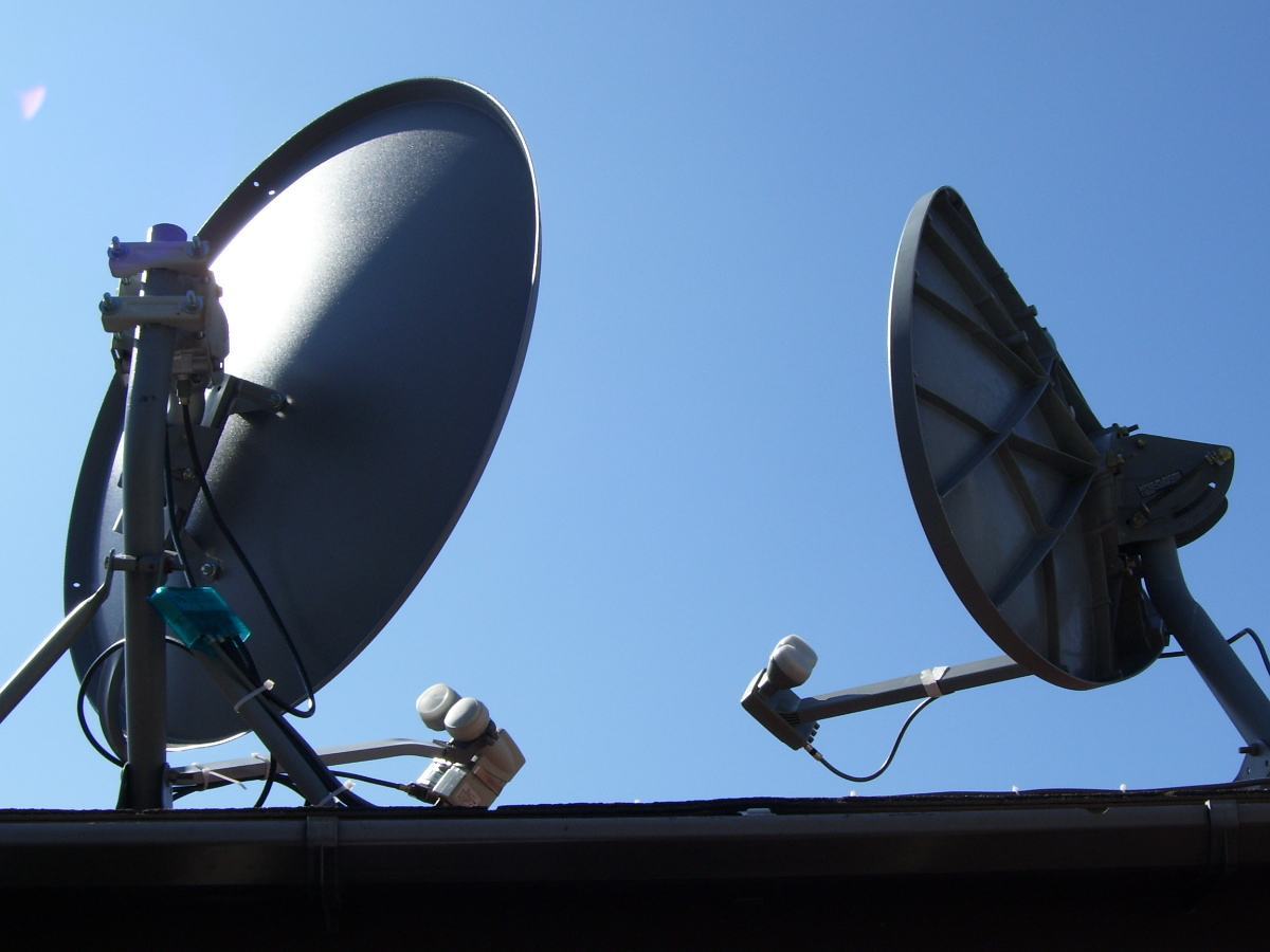

I do 8-11 degrees all the time. The dishes are well aligned and line-of-sight is clear. One does pick up a little more noise at these elevations. I have had some success at 3 degrees, but there is vegetation and distant buildings very near that point. My biggest dishes can't see that low, and they would be better for this last case.

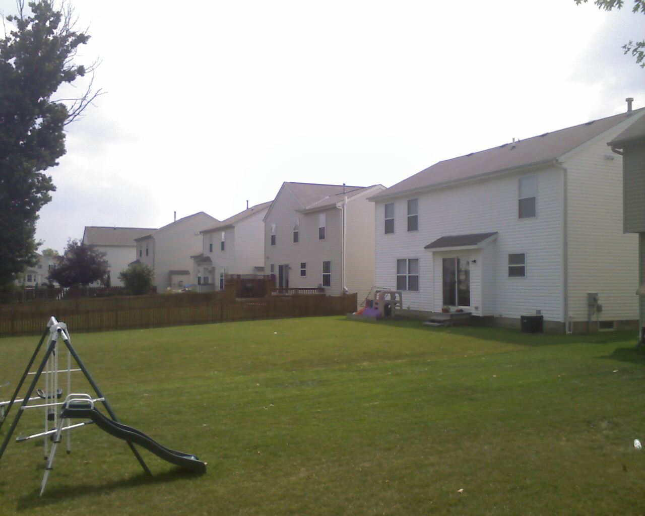

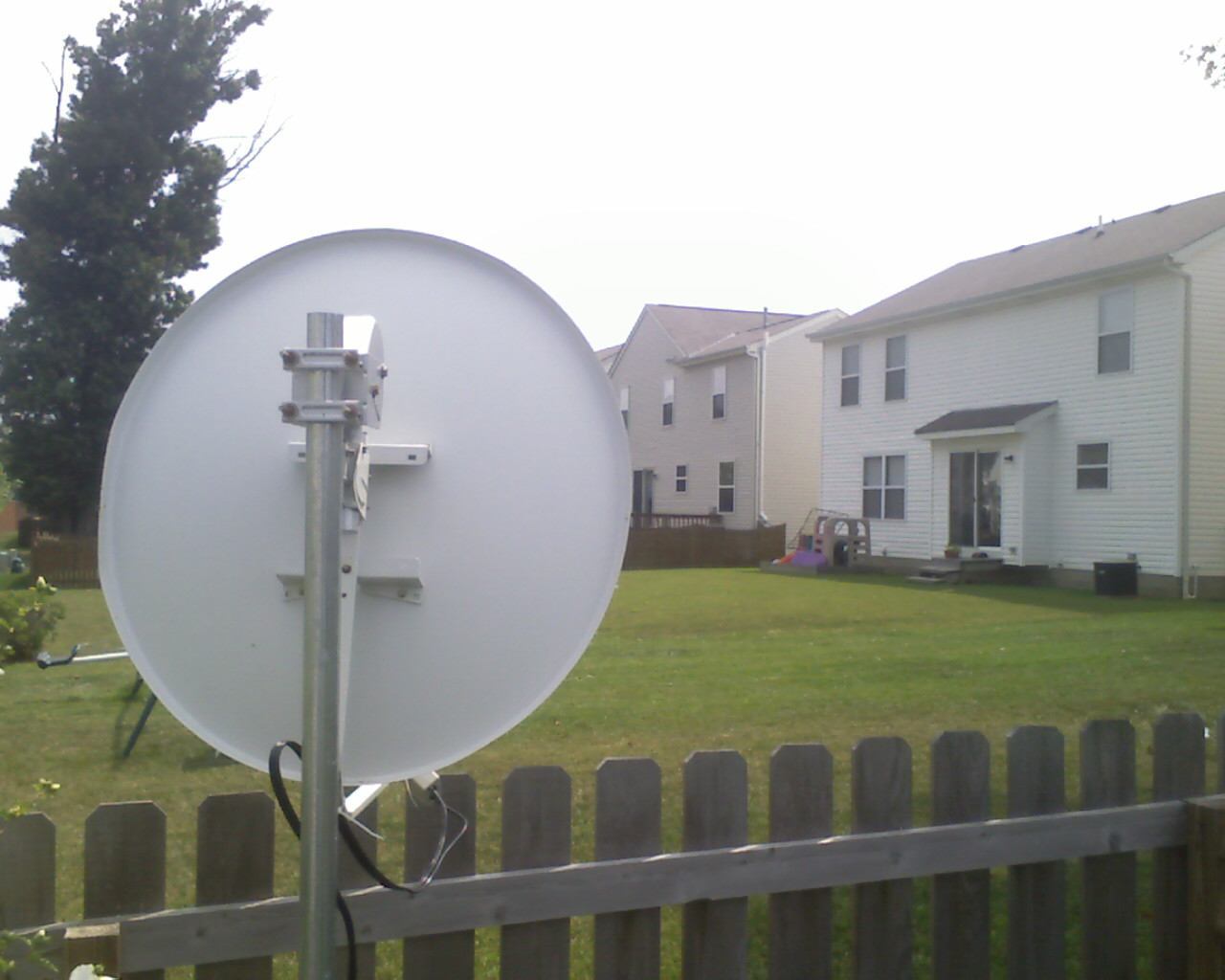

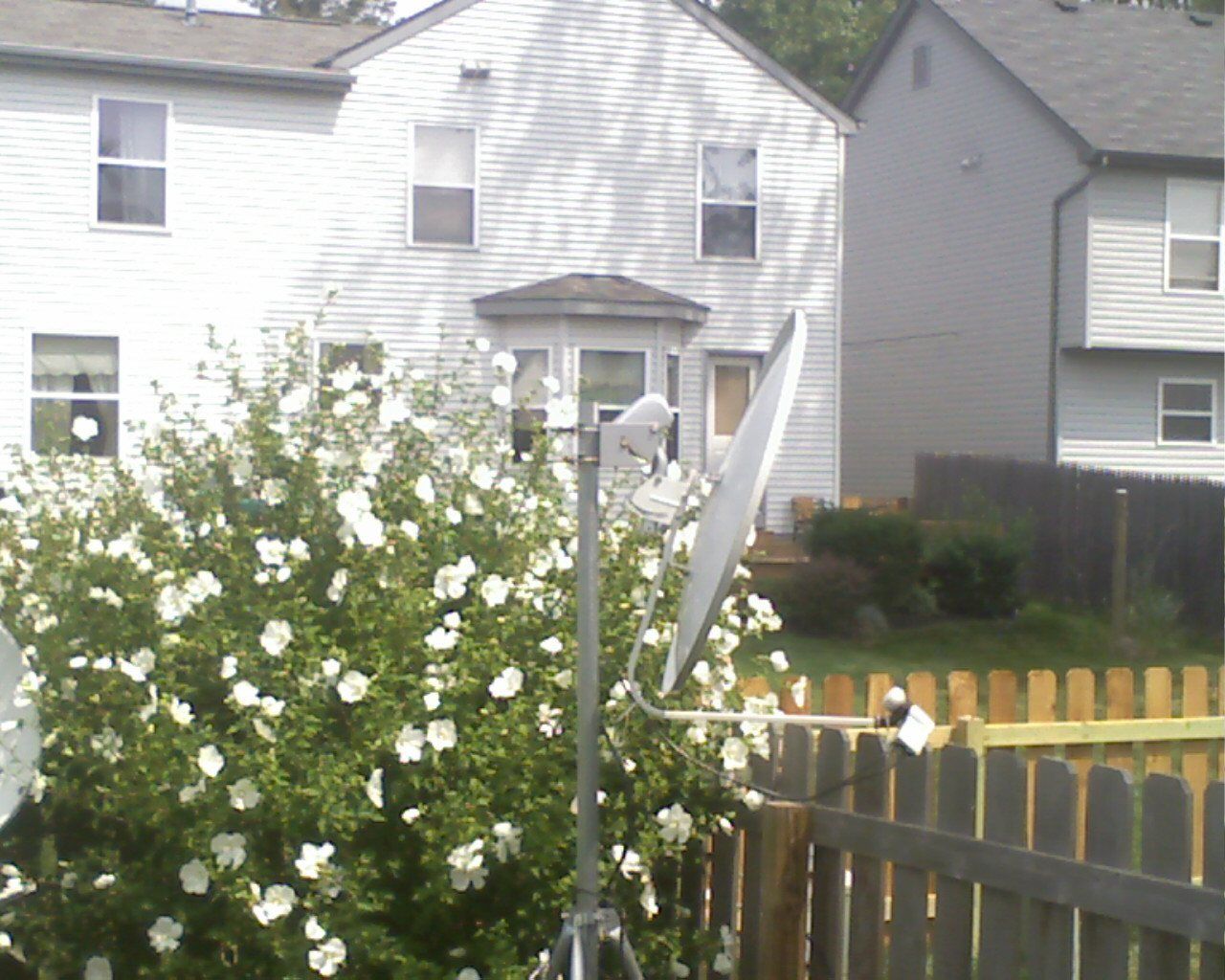

This is my 90cm pointed at T12. Motor is not connected but using it to get the elevation down without the dish hitting the pole. Where the motor mounts to the pole is about 6ft high.
The last photo is from the top of the dish. Home is about 140 ~ ft away.

spent some time on the ladder looking for a gap between the houses across...and looking at my dish angle where it would be pointing at 10 degrees...
it looks like the house roofs on the other side would be blocking my sight of line
