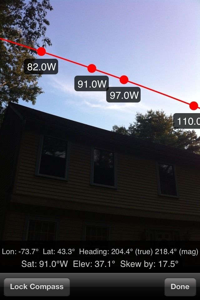

That app is better than a clinometer / compass! It also shows background LOS problems. So you see the sats and the trees,buildings and hills that block the signal. I thought the laser pointers were great but the picture is worth...about twenty minutes of BS with a cx who will not hear. Especially when it often turns out the cx does not own the ground where the blockage lies.

No, better if you are on the ground anyway. The app I used was with an Android phone but there are several co get ont that is compatible with your phone. What you will see a series of satellites presented as yellow dots with their identification number AND you will see a camera pic of where you are viewing. If the yellow dot is on clear sky you place the dish along that line. If the yellow dot aligns with a tree or building you are screwed...but you will know why.

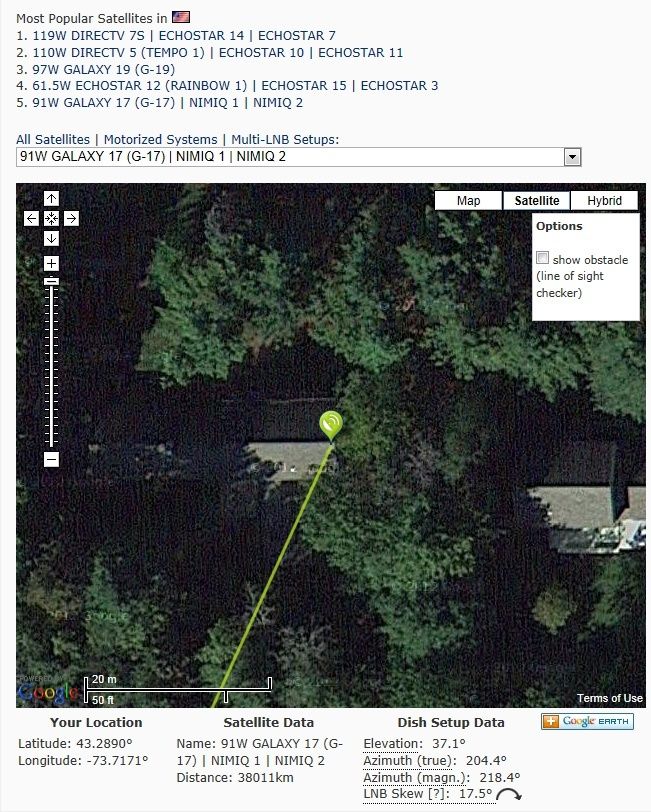

I looked at the sat pic of your home and it looks like the original installer was correct. The dish has to go either in your front yard on a pole or on the edge of the front roof. It looks like all back yard locations are blocked by trees...........and I think they are showing the wrong sat but close enough.

Thanks. It turns out the dish would be pointed northwest rather than southwest as I thought. Here is a screen shot. The dish location is on the north side where the installer said it has to go. It seems like the south side below the peak of the roof along the same line would work. I might call DirecTV and have them come back and indicate to me what tree is blocking it. I could probably have it taken down.
Reset this shot for the Directv 101 and you will get an azimuth a little more west....right into a tree near your building.Can't tell about elevation clearing that tree.

Like Joe said, you can use it from the ground. Take a view from the north side of your house behind where the dish might be and check the screen that shows where the satellites are. Line up the 101 satellite with where the dish might go and you can easily see if you will clear any trees. By moving around your house you may find a place where you have a good line of sight. Because you are in the Albany dma, for Directv to do the install you will need to be able to get the 119 satellite as well as 99, 101, 103, and 110. If you can only get 99, 101, and 103, an independent will probable do it, but you won't be able to get your sd local channels, only the hd ones. Most people wouldn't care about that, but it might make a difference to you. Good luck!
Here's the view from the front (north side) of my house. The first installer wanted to put it on the lower left corner of the roof. If that's my only choice I guess I'll go with that. Making an appointment in a few minutes. fr_189.jpg

Here's the view from the front (north side) of my house. The first installer wanted to put it on the lower left corner of the roof. If that's my only choice I guess I'll go with that. Making an appointment in a few minutes.View attachment 79737
It looks like you will be good to go. I'm guessing the lower left corner will give you the longest time before those trees could be an issue.

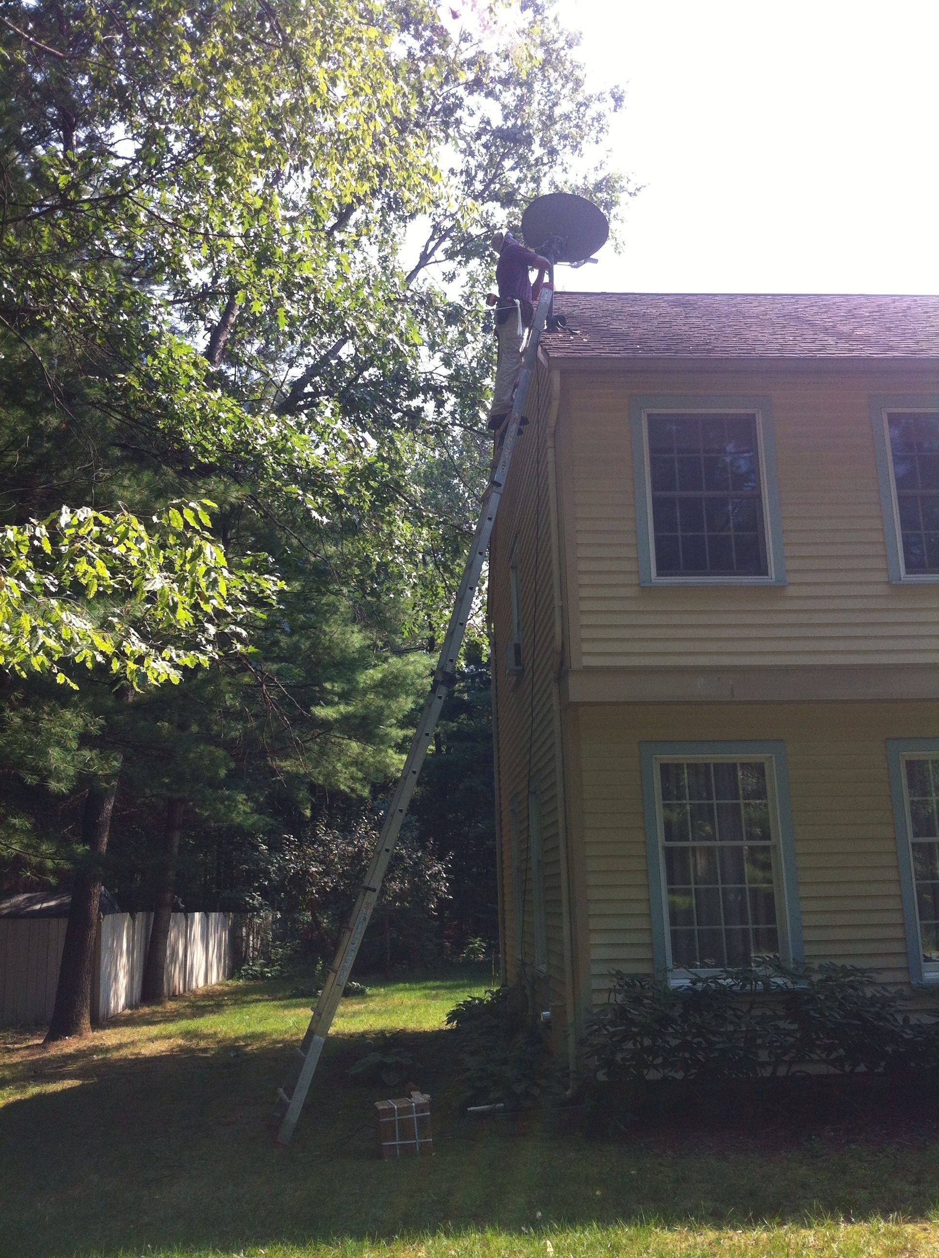

Here's a picture of Nigel doing the install.
