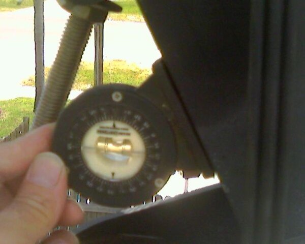

Then this picture would be the Elevation ? it was correct at 62.5
the measurement in the last post was 32 . I unhooked it for today I will play with it again tomorrow.
Without knowing your exact Long & Lat, you look good
90 minus 62.5 = 27.5
27.5 + your local Declination = about 32
Where you made your first measurement is only done with the Dish at it's Zenith (highest point)
I think your angles are close enough for C Band
