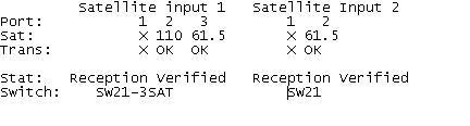

61.5 show fine on both connectors.
On one input, it sees 110 ok, and an X for 119
On the other input, it doesn't see 110 at all and an X for 119
119 shows as x on both, so it sees something.
I am using Sat21x and sat21 switches
110/119 into a sw21x then connected into the mix with 61.5 with a sw21
Second input duplicated with first.
This was working until last month....
Sounds like a bad lnb??
Can't see how BOTH sets of switches went bad at same timeor both LNB's all at once

Ok, it worked before, for years. An SW21X is *NOT* an SW21.
Anywayz...
I took the SW21s out of the mix (Not the 21x), check switch reported exactly as above except no 61.5....obvious.
I pulled apart all the switches, and found a corroded 119 line, replaced the connector.
Plugged a 119 and a 110 directly to the rcvr, both inp 1 and inp 2 showed ok, tried the other 119 and 110 lines, both say ok.
Pluged them back into the sw21x units and plugged then into rcvr. BOTH show
Port 1: x
No Switch
Note reading nothing. Tried them one at a time, both show as X.
Where do I go from here?

When you do a check switch, what exactly does the 'X' for satellite name mean, instead of 110/119/61.5? Especially if it says 'Reception verified'

When you do a check switch, what exactly does the 'X' for satellite name mean, instead of 110/119/61.5, I see x/110/61.5? Especially if it says 'Reception verified'
Does that mean it found the switch/lnb, but can't tell what sat it is cause it is mistuned?

'X' in the check switch display?
X means no satellite signal detected at that port.
