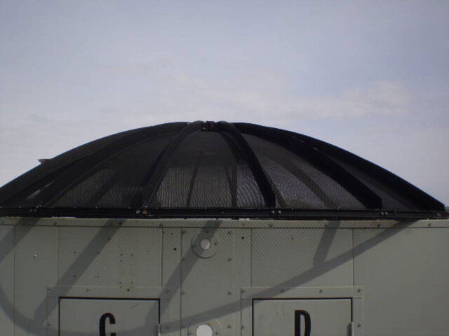

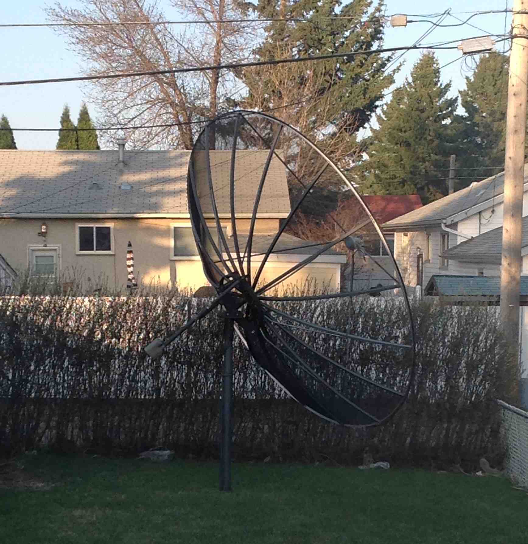

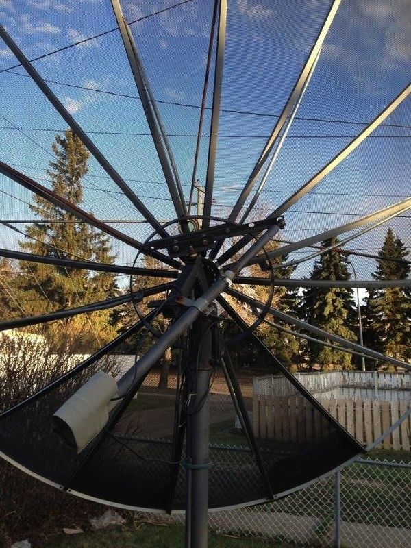

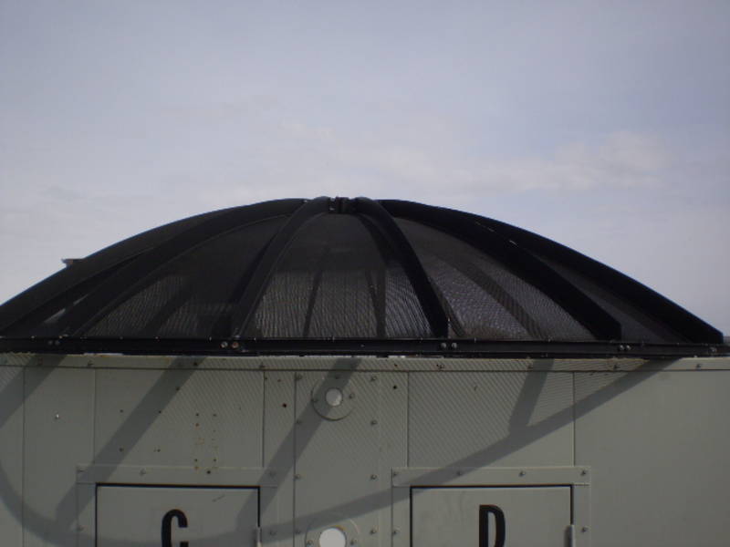

So, would it make any sense or is it even possible to combine the dish you see in the first picture below with the mount and equipment from the second?
Dish number 1 is an 8 foot at a metals yard a couple of hours away from me, and they want 75.00. They have no other hardware for the dish.
Dish number 2 is a free, take it away, yet to confirm size of dish.
Wouldn't make sense here. But, Why? Dish #2 looks complete. Go get it. $75 for what's there [#1] is way too much. Somewhere around $30 is the scrap metal value.
A bird in the hand
I agree.
A complete dish for free is hard to argue with.
Lot more bang for the buck. ;)
It's got a scalar, arms to hold it, a motor, and the pole.
Get 'em all!
The $75 dish has none of those. :down
And even if it's a pain to dig out, never under estimate the value of a free pole!

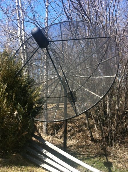

Ok, the fish are jumping now...
Got another picture of a dish I think is currently number 1 to attempt reeling in.
And another one has popped up, but by the time I saw the ad and contacted the poster I was number 2 in line. Owner has promised to contact me if other party does not take it.
General guidelines...
I don't see anything to rank one above the other.
Think you got two good choices, there.
Can not guess size from looking at them.
8-10' will be fine, and go for 10' if all else is equal.
I wouldn't get excited over 6', though. ;)
Dish #1 - the owner didn't post a size, but based on the size of other things in the background I believe it's at least an 8, and quite possibly a 10.
Dish #2 - owner posted as "12?"
To my untrained eye they look like the same model of dish. Probably installed by the same dealer around the same time.
