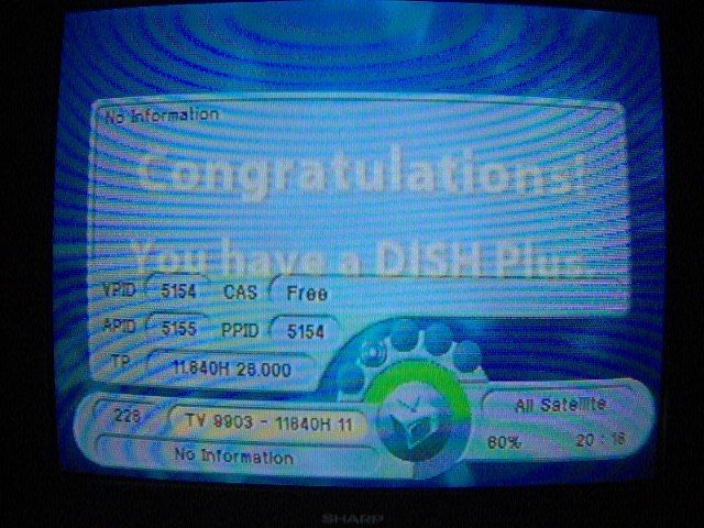

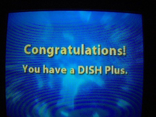

by the way...what are you watching on 118? Only thing there free is the "you have a Dish Plus"

The above picture is the only free item on there :D

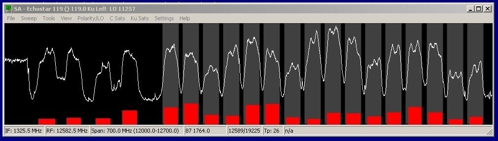

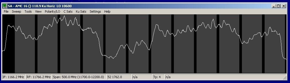

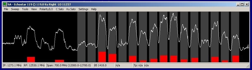

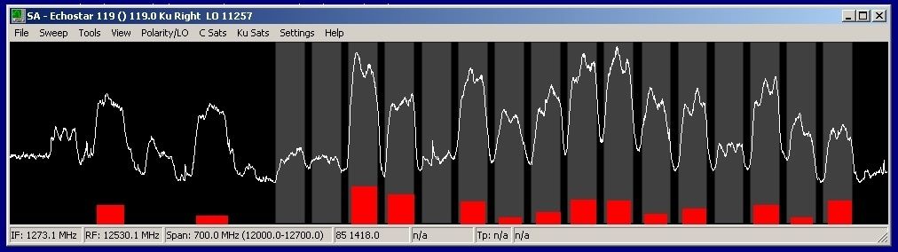

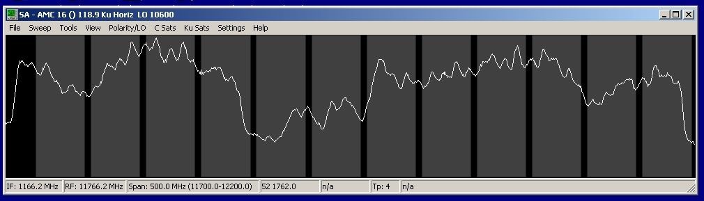

Here are some Broadlogic Spectrum Analyzer plots. Two are using a circular dbs lnbf at 119 degrees. It shows both Echostar 7 and part of AMC 16. The four signals on the left are on AMC 16. The others are on Echostar 7. The rest of AMC 16 is cut off because the dbs lnbf can't tune any lower. The third plot is of AMC 16 with a linear lnbf. It looks like crap because the circular signals overlap one another when using a linear lnbf.

Thanks, but for those of us unfamiliar with Spectrum Analyzers...
Could you explain exactly what that means?

below is the "Dish Plus" screen
11840 H 26000
