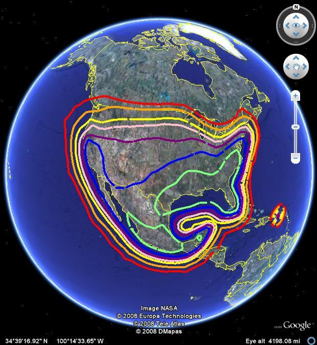

Looking at that new contour map, I wonder what they are planning with that satellite. North of Nebraska looks like a larger dish would be needed.

Very interesting details in the modification. Basically, they resolved the potential conflict with Canada by modifying the beam so it stays out out Canada. They are also going to flip the right and left circular frequencies to reduce interference This all is quite different than previous Conus satellites. And, they have been able to shape it so that it effectively covers Conus and Mexico with almost a knife edge cut enclosing the two countries with a tight recepton area for Puerto Rico. High power beams, either 150w or 300w if doubled.

Went back and looked at the footprints after looking at your earlier post. It will take something like a 4 or 6 foot diameter antenna in the northern border states. They may use it for some locals futher south, but I'd speculate it has to do with expansion in Mexico. Can't think of anything else that makes sense.

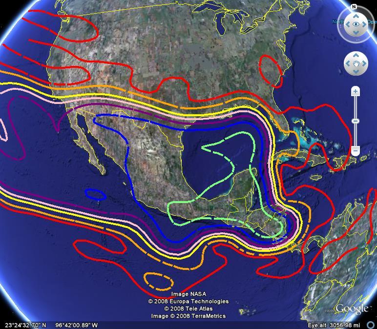

went back and got the E8 77W Mexico footprint for comparison. Sure looks like it is designed for the DishMexico service.
