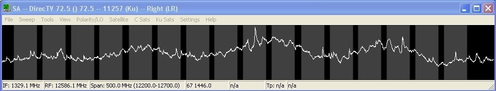

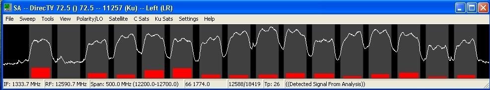

I looked at it with the Broadlogic Spectrum Analyzer. There are DSS signals on all even transponders except transponder 4 which is empty. There are no signals on odd transponders because Directv 1R doesn't have any. It only has 16 transponders.

There's nothing at 72.7W yet. Directv 1R is at 72.5W and Nahuel 1 and AMC6 are at 72.0W (according to Lyngsat). If there are DSS signals on TP1, more likely they're coming from 72.5W
Here are the BLSA scans.
