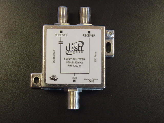

I am trying to cascade 2 sw 64 switches. My question is will a standard 1 port dc pass diplexer work as a direct replacement for the dish network splitter in the picture.

You can use a standard 1 Port Power Pass satellite splitter, a diplexer will not work. When cascading SW64 switches, you must use the Dish Network load barrels.

Unh. Could someone tell me why a DihPro splitter will NOT work to split a Legacy feed?
Obviously, TWO splitters will be needed per LNBF, but other than that, no problem that I can see.
Because, for legacy, one side of the splitter must pass the DC 13/18 switching voltage.
If you look at the picture you can see the diagram that only one side passes power. You need to pass power on both sides to cascade 64s.

Right. So, a DishPro splitter SHOULD work just fine.
You have to remember to match the switch ports (ie. the same LNB feed to the same port on each switch).
Yes, if you don't use a power blocked splitter, you will overpower the LNBs and could cause them to burn out. You only need power from 1 SW64 to the LNBs. SS is correct in that 4 of the DP Splitters(for 2 sats) will work just fine since I have done it with just that config.
