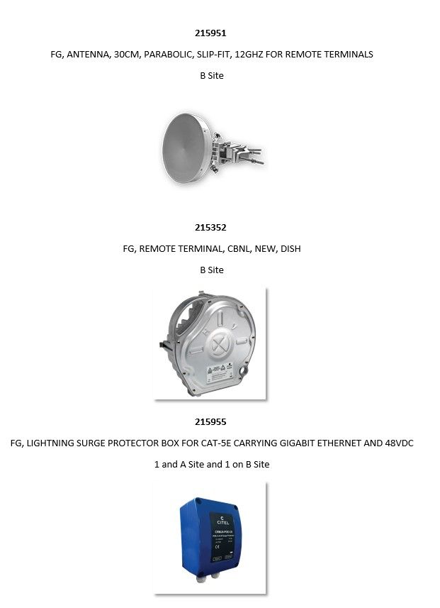

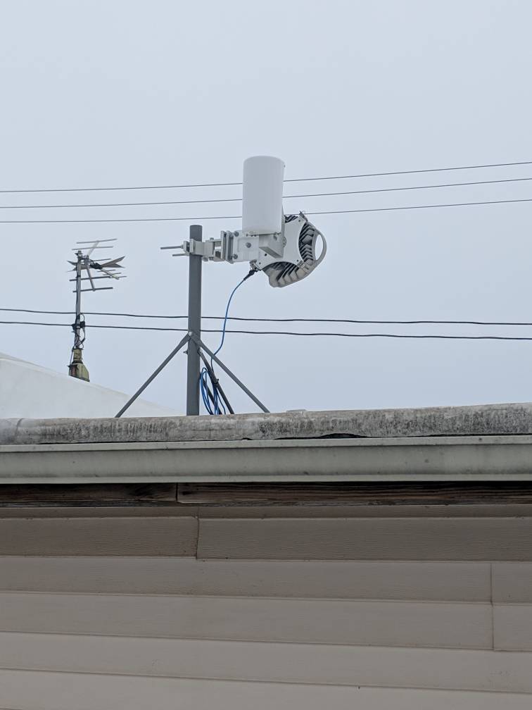

The Dish is the same size as a dish either mounted if allowed or on a temp mount. Same with the Site A and B Antennas - mounted if allowed or on temp mounts.
The Site A Antenna is bigger than I thought. Maybe comparable to a 5 Gal Bucket
The Site B Antenna is maybe half as big. The blue box is the lightning protection that goes at the ground point.

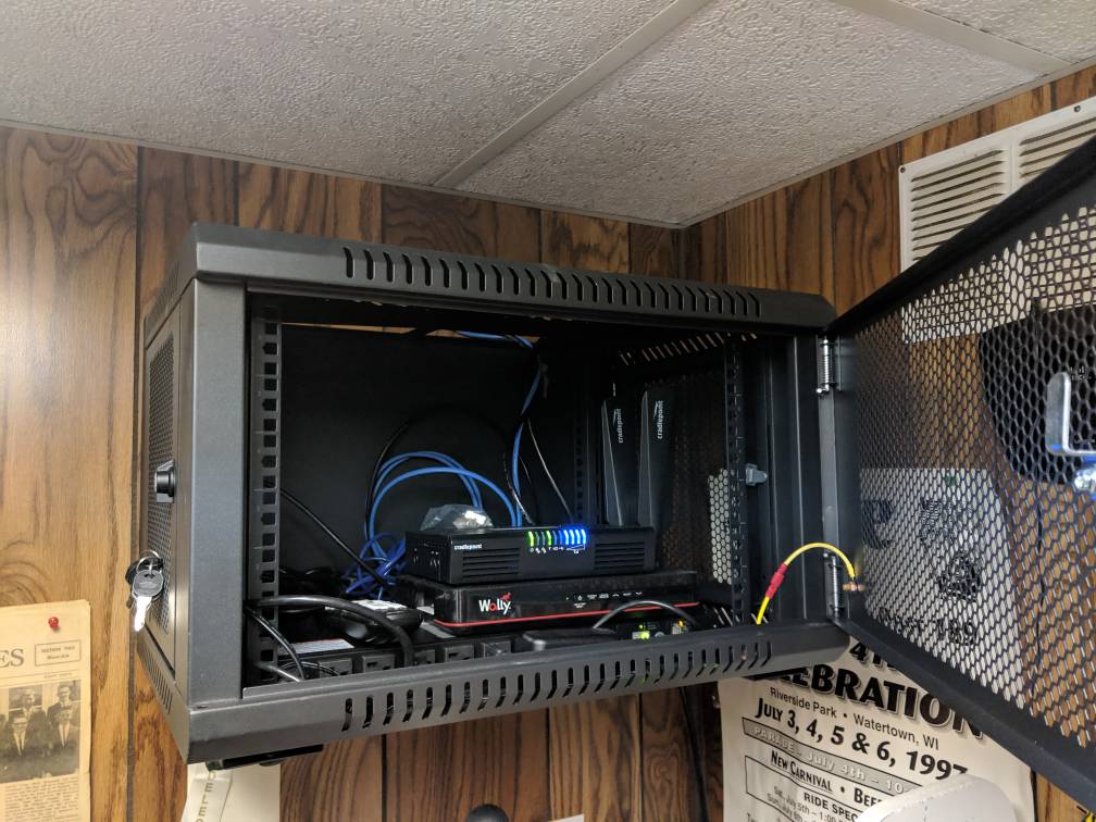

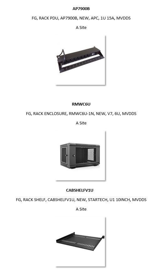

Inside is the media cabinet, 2' by 3' with a Wally and surge protector inside, then everything is connected via Coax from the Dish and Cat 5 from the wally to the Site A Antenna and From the Site B Antenna to the receiving Router
So what's powered is the wally, the receiving router, and the power strip/surge protector in the media box

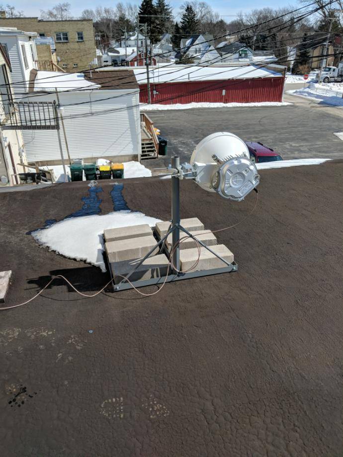

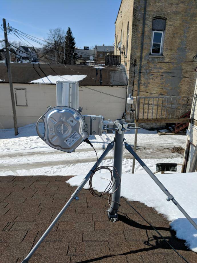

A site(send) here is on the mast, B site(receive) is on the non penetrating mount. View attachment 137766View attachment 137767View attachment 137768View attachment 137769
Since when was it proper to install a non pen roof mount on a sloped roof?
Besides that, where is the teather!
That right there is a liability hazard, the non pen mount could slip down the roof on to the side walk. If someone is below they could be injured or killed.
They need to either screw a mast into the roof like a Dish install, or get a non pen mount that sits on the eve in a V shape and is supported on both ends up equally distribute the weight of the mount.
I didn't do the install. Dish had partnered with another company that did these VERY early installs of this system. I heard the other day that they ended that partnership because of things like this, and also because they can't handle the workload.
That's fine with me, just means more work for us. I have a feeling we'll be reinstalling all the jobs they put in so far. The pictures you see is a job I rolled on to swap a modem at the site. I haven't done an install yet, but I'm looking forward to it.

As far as having things rebooted, the surge protector used has an IP address for each individual plug, so they can control what's plugged into it remotely.
I see non-pen mounts quite often on mildly sloped roofs with no tethers. Mostly they're on businesses supporting Hughes two-way dishes for POS and lottery systems. On steeper peaked roofs, non-pen straddle mounts are pretty common, at least in the northeast.
Yeah the one in the picture above is VERY slightly sloped, and there's a skid pad under it. Even still, I think we'll be redoing that.
