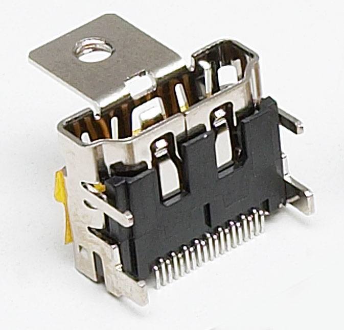

If its the connector that comes loose, anyone have any luck opening the case and pushing down on the HDMI port to put it back in the socket or is it a solder joint type of problem?
Mine failed so I looked at the connector. It was soldered on the board at an angle causing the surface mount pins to pop off the board. I put pressure on the connector and reheated the four thru hole shell pins to reseat it properly, then reheated the surface mount conductors. Been woirking fine for six months now.
Current HDMI connector is 'surface mount', Dish is working on a 'through hole'
version but ECN's take awhile.

Spliff - Yes, yours does sound like a "handshake" issue vs. the ubiquitous HDMI hardware failure. I have posted many times on this subject, and I have always allowed that SOME failures could be SW related. But I have always contended that the bulk of them are hard failures, usually one or more of the SM legs of the socket breaking free of the circuit board. One possible solution is to migrate to a through-hole design. Sounds like that is what E* is doing. Too bad that can't be an easy retrofit for the fielded units that develop the problem over time.
There are some things the users can do, like not wiggling the HDMI plug excessively (and preventing any inadvertent movement), off-loading the weight of the HDMI cable from the plug, and making sure the unit gets LOTS of ventilation to prevent thermal cycling from contributing to the problem...
