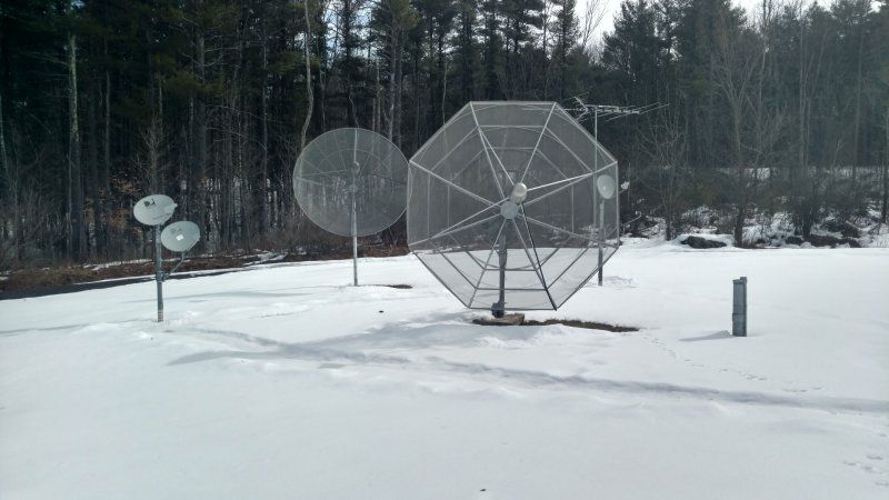

How's this...
That's my back yard. :)
The Dish Network, Viasat and Hughesnet dishes are on the south side and aren't visible in this picture.
WOW, nice, except for all that white stuff all over the place. And is that a dish I see from the dark side? :shh LOL
I took that pic this morning. You should have seen the snow here a couple of weeks ago. It was up to my, well you know. :)
That's a 12ft Paraclipse C/Ku, a 10ft Perfect 10 C/Ku, 3 DirecTV Slimlines, 1 Dish 1000.2 EA and an OTA.
