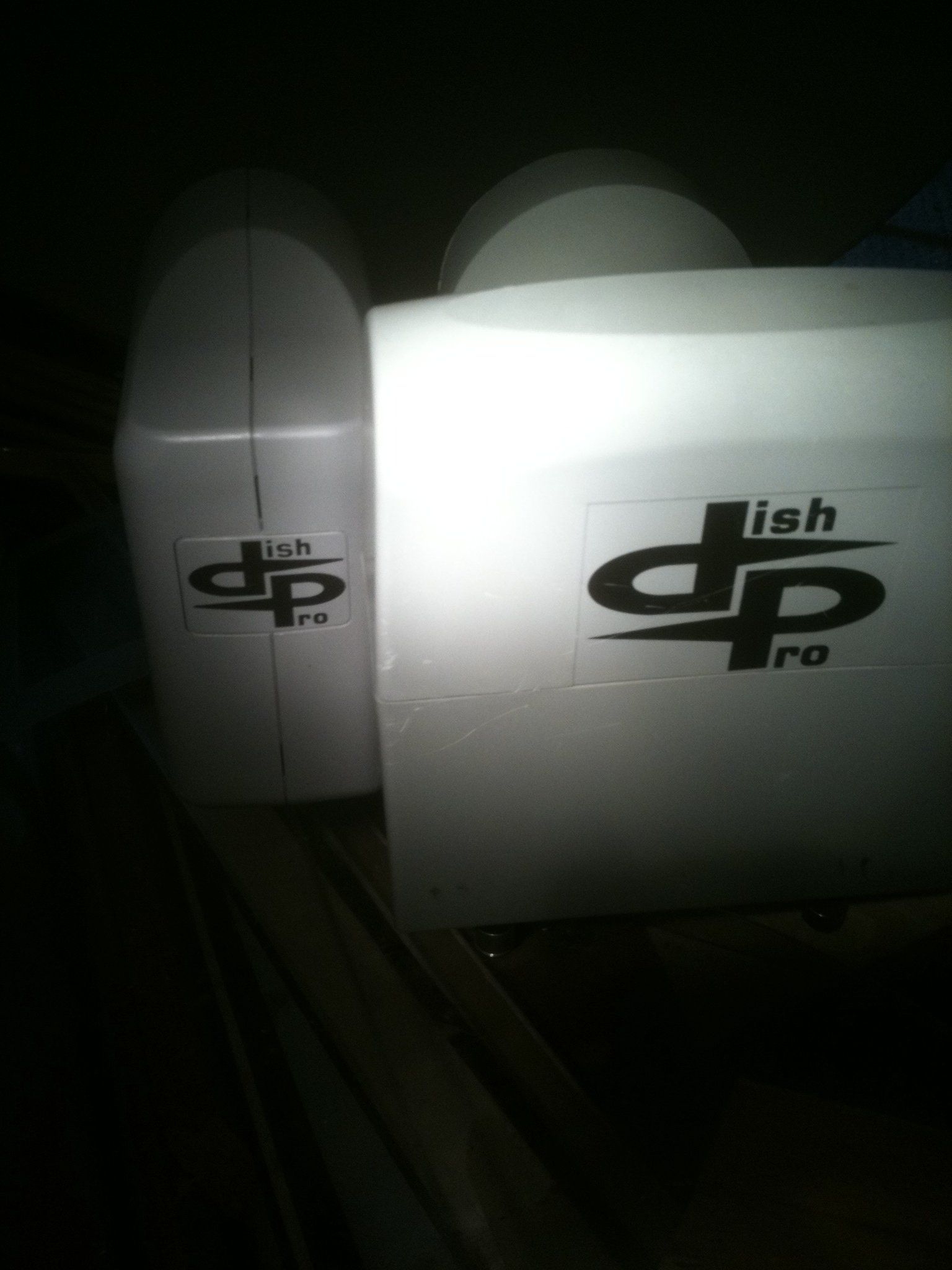

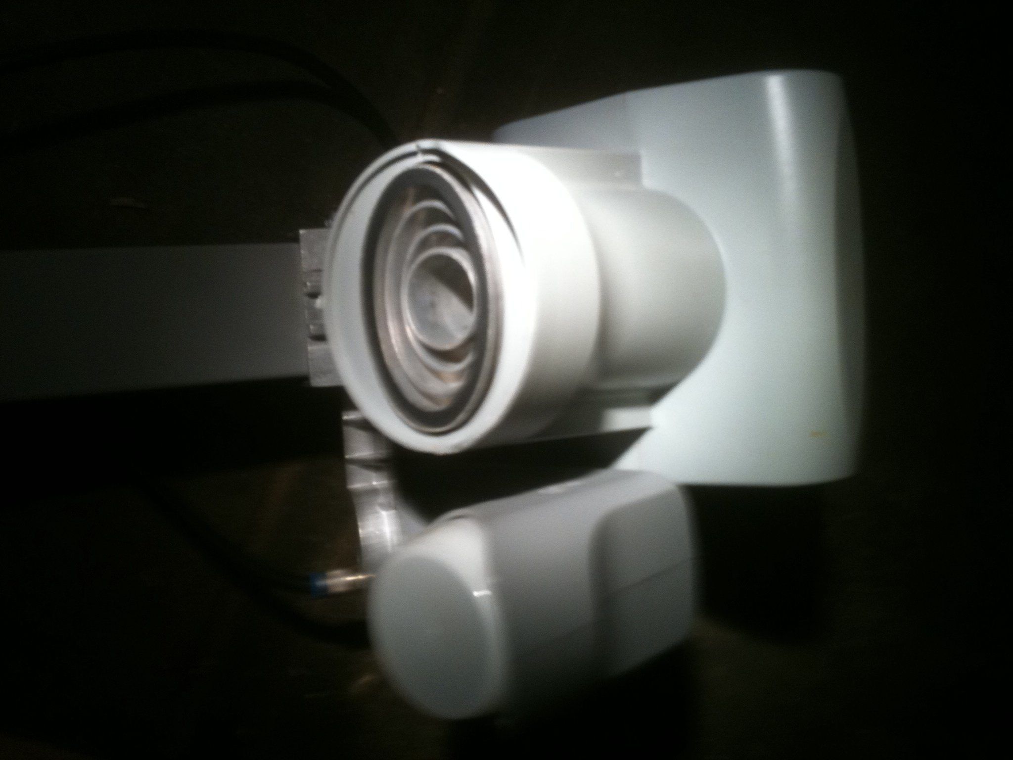

Just want to ask for a help setting up the following (pics of lnbs attached)
1 unit 211 HD receiver connected to my 2 lnb's - it is my understanding that the bigger lnb will get 110+118.7+119 sats and the small lnb will get 129 for HD channels - if this is correct - what kind of switch will I need?

I don't think that's right. The bigger LNB will give you 118.7 and 119 on two separate DishPro outputs. The little LNB will give you either 110 or 129, depending upon how it's oriented compared to the big one. You really need another one of those little guys. ;)
And if you subscribe to channels requiring all 4 birds, you will need a DPP44 switch. Pricey. Perhaps you can get Dish to install one for you.

The SW21, being a legacy switch, can't be used with DishPro LNBs. What is the LNB setup of your Dish 500?
