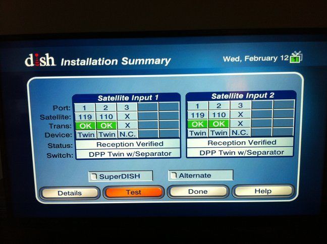

Run a checkswitch to make sure which sats are being seen.

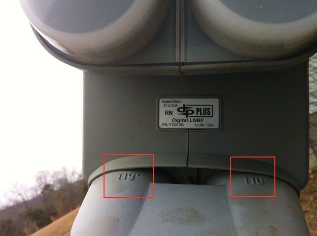

Navychop, thx to you as well: the '110' & '119' is molded into the plastic housing below each LNB; I'll run a checkswitch as soon as I can.

Ran a checkswitch today, found 110 and 119, a big 'N.C' in the third slot.
Here's those 2 LNB's:
<img src="http://www.satelliteguys.us/attachment.php?attachmentid=95376"/> Ran a checkswitch today, found 110 and 119, a big 'N.C' in the third slot. Here's those 2 LNB's: <img src="http://www.satelliteguys.us/attachment.php?attachmentid=95379"/>
Thank you. The technical explanation for your situation is: Her installation was hosed. BAD tech!

Having a Western Arc setup in the Birmingham market is okay, but it needs to be a 3 slot dish (DISH 1000.2) as opposed to a DISH 500 pictured above.
The local HD channels are on 119W so she should be able to get HD local channels with the current setup:
