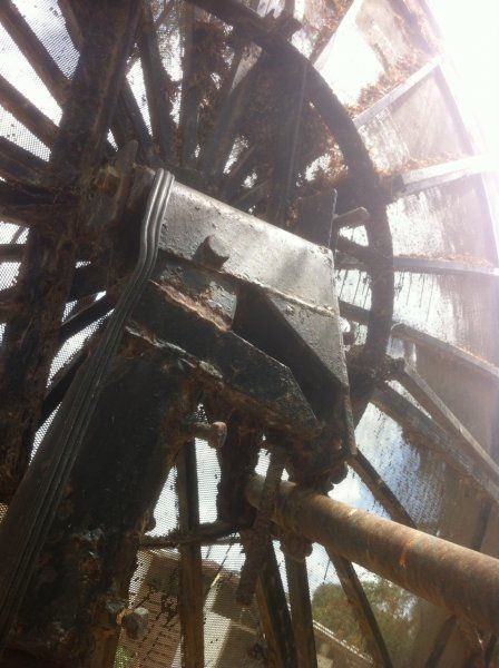

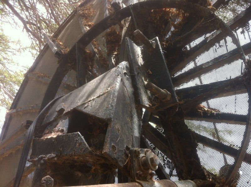

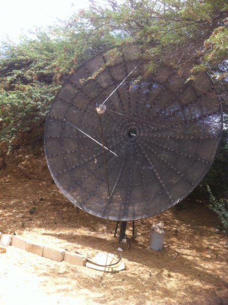

Hello,
I recently was searching around for some C-Band dishes, and came across with a C-Band dish all the panels are complete, talking to the owner about it, I saw the dish and the structure is almost good, one satellite technician that looked at the dish pointed out the mount is rusted, and would break if the mount would be disassembled from the pole.
I took some photos and would like to request if there can be any advice given if the mount can be restored by a welding shop, and also if anyone can identify the dish, it is a complete dish even with an actuator on it with the control cables just the dish was not being used for many years, the dish overall looks almost good, so does the pole, just the mount would need to work on it to restore it, or if it can be replaced.

I say to pass on it. I'm not sure what brand dish that is, BUT, it would cost far too much time and money to attempt to rebuild that mount. IMO it's too far gone. I'm sure you'll find another much better dish if you keep looking.
Reactions: Titanium
The work that you will need to put into this restoration would be proportionate to the number of C-band dishes available in your area. If there are other choices, I would keep looking and find one that isn't damaged. If the mount is broken, I would guess that the reflector might also be damaged. By the looks of it, time has taken a toll on this one and it will require a lot of work to get operational and cleaned-up.

It looks like a 12 foot dish. The dish itself is likely aluminum, and appears to be in good condition. No panels missing or horribly bent out of shape.
Maybe I'm missing something from the pictures, but overall it appears to be in good shape. Sure, there's tree crap on the dish, but that's not rust.
For a mount for large c-band dishes, they need to use thick steel... I'd be surprised if the mount is beyond repair.
Finding someone who does welding in your area might seem difficult until you ask around, but there are guys that do it, and can likely repair it easier than you think... you just need to find a welding repair shop. They can get the mount off of the pole easily.
Worst case, you can always get another mount, and put this dish on it, if the mount is truly beyond repair. 12 foot dishes are not that easy to come by, and are excellent for c-band.

from what i see that isnt that bad, but my threshold (to use @Titaniums word) is higher than most. i'll try to fix anything.
if you do get it, first thing, is to spray PB Blaster (or WD40 in a pinch) on all the bolts that need to be removed to get it ASAP... keep them wet.. let is soak while you get other stuff. Welding shops can fix anything, even if it needs to be 100% rebuilt, it just costs $$$
