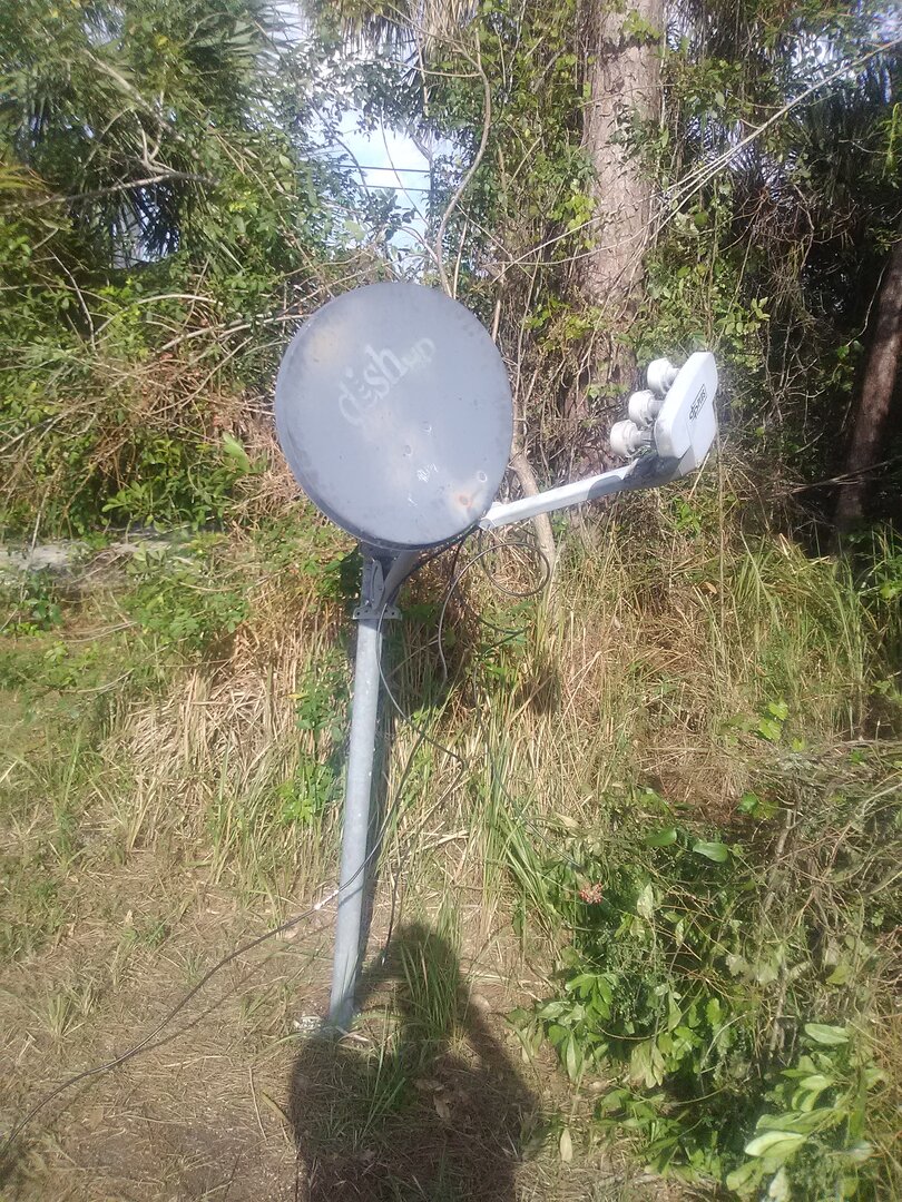

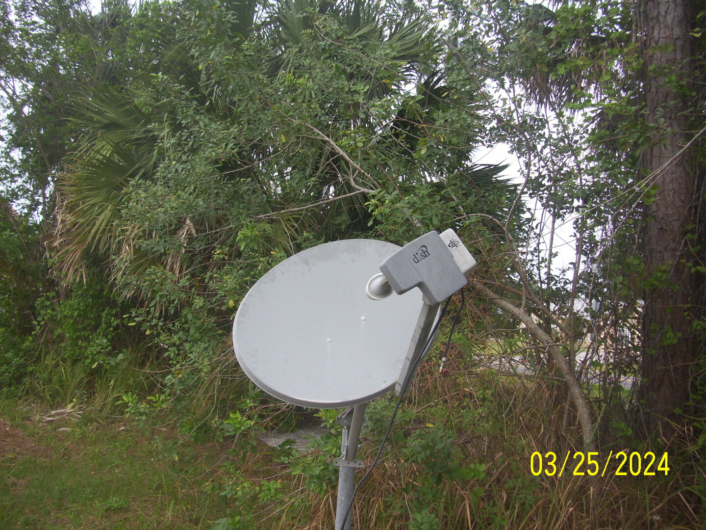

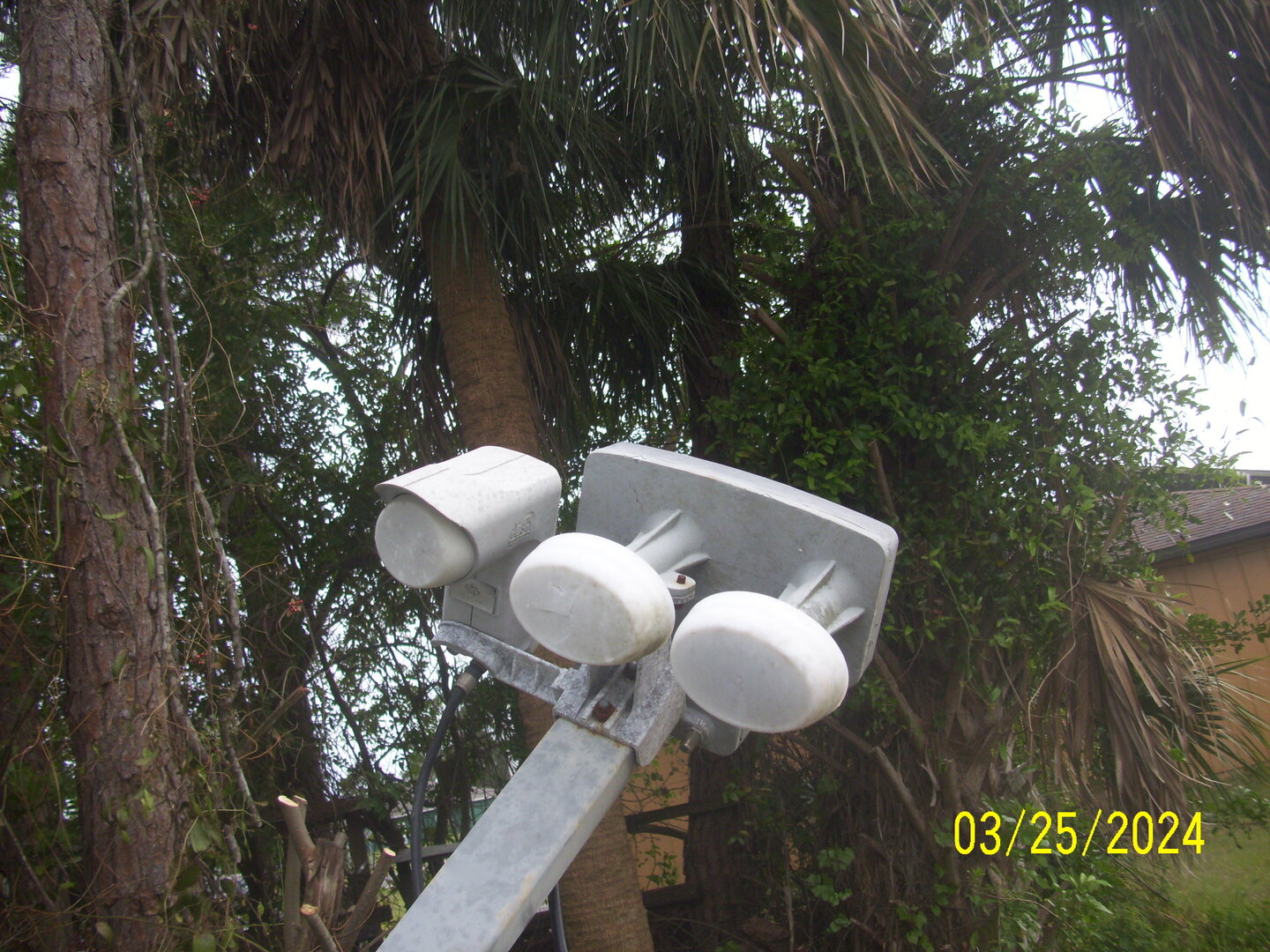

Have you verified the missing channels are included in your current plan? Can you add some pictures of your current setup?
Thx, yes. I can get the missing channels/transponders when I revert the dish in my setup to the Playmaker. Pics attached

Do yourself a favor and just get a new LNB. It will make your world go round. It's obvious why you found the one you have in the trash, it's broken.

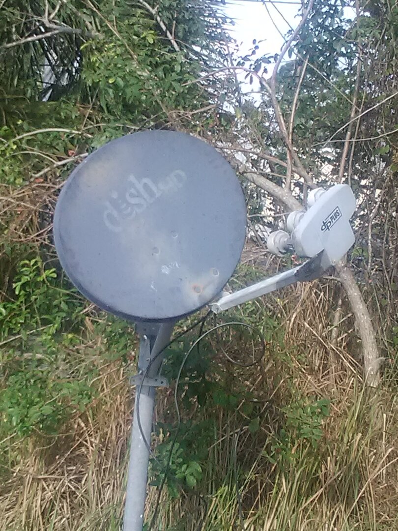

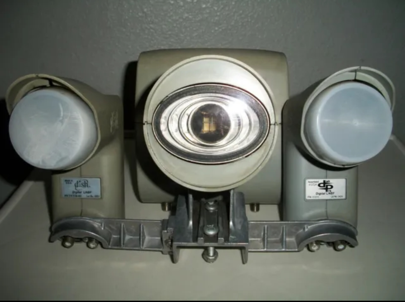

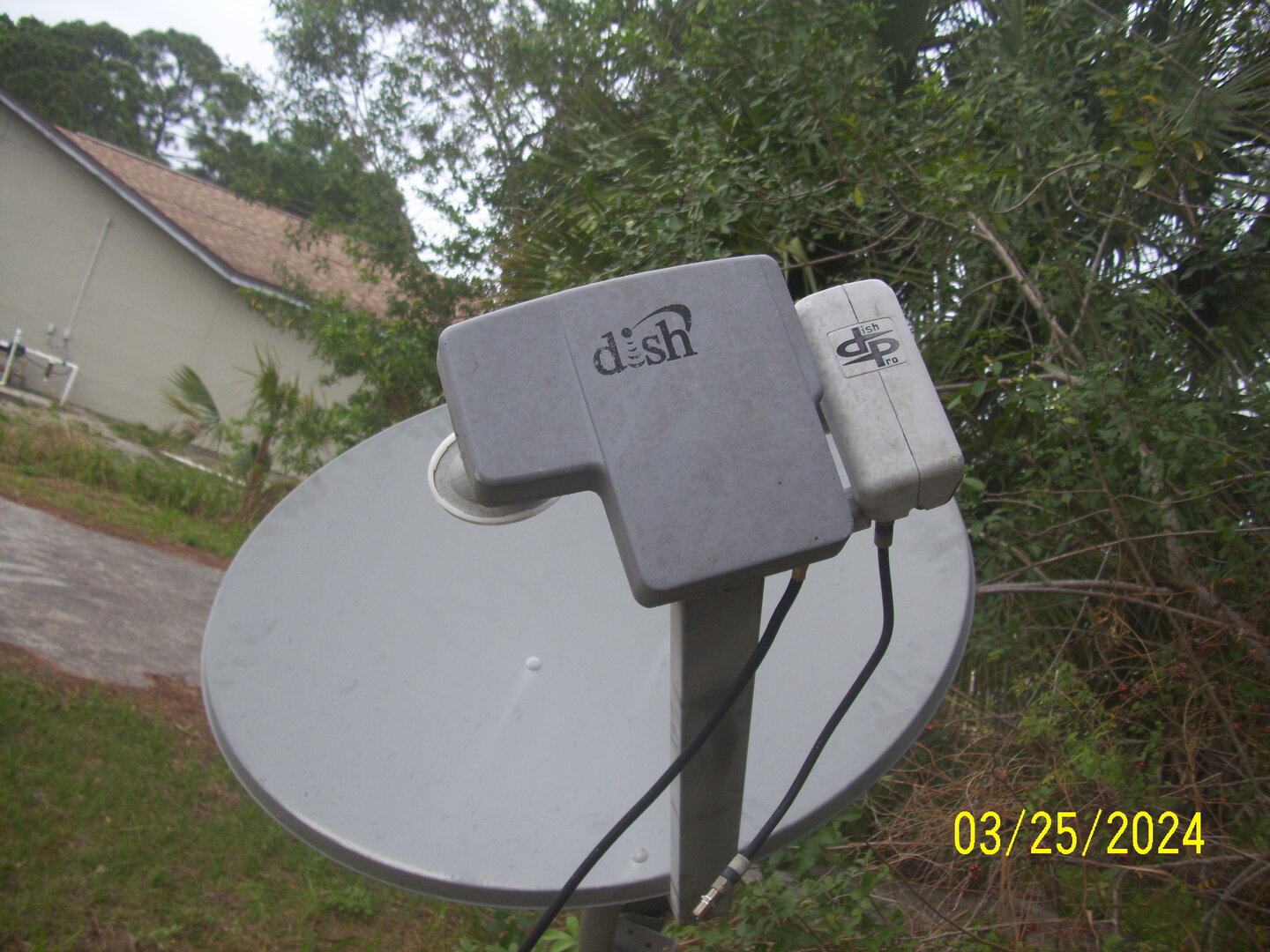

As luck would have it, the Junkyard Dish Fairy gifted me with another "vintage" Dish today. (Pics attached) This one is a DP Plus Digital A414025. If you look at the LNB on this one (from the Dish's pov) it appears to have 2 duals. My Wally box reads the left one as a "DP Dual", the one on the right (with the oval horn covers, whats up with that?) the Wally reads that as "DP 500+". So I soaked the rusty bolts on this one and set it on my test mast. I aligned it by sight and quickly got a signal (on the DP Dual only). However it tickled a "78" on the Wally signal meter (my personal best), and received all of my subscribed signals. One thing I noticed, in this setup it received Sat 119 only. I later tried to get a signal on the DP 500+ (oval) LNB and could get nothing, I only moved it left-to-right, I didn't want to move the other settings since it worked so well with the DP Dual. Any comments? Thanks

That's what we call an international dish which adds the 118 for international programming. The single lnb on the side isn't needed as it was used for the 129, and is no longer in service. So you can remove that one. Then the cable will connect to port 1,2, or 3. But do not use port 4 as that's an in port for the side lnb.
If you were getting the 119 on the single that would be why you didn't get anything on the main lnb. So connect to the lnb and then if you're standing behind the dish looking toward the lnb you'll want to move the dish a little to the left and probably slightly up as well. Once you have signal on 119 you should start receiving signal on 118 and 110 as well.
I thought the 118/119 lnb was one unit that received both sats, a bit larger than the two larger ones pictured.
The one pictured above is dish pro plus and has two lnbs. One for the 118/118 and the other for 110. Prior to that model, the dish pro version (in included picture) had a big lnb for 119/110 then used two dp singles on either side, and is most likely what you are thinking of.

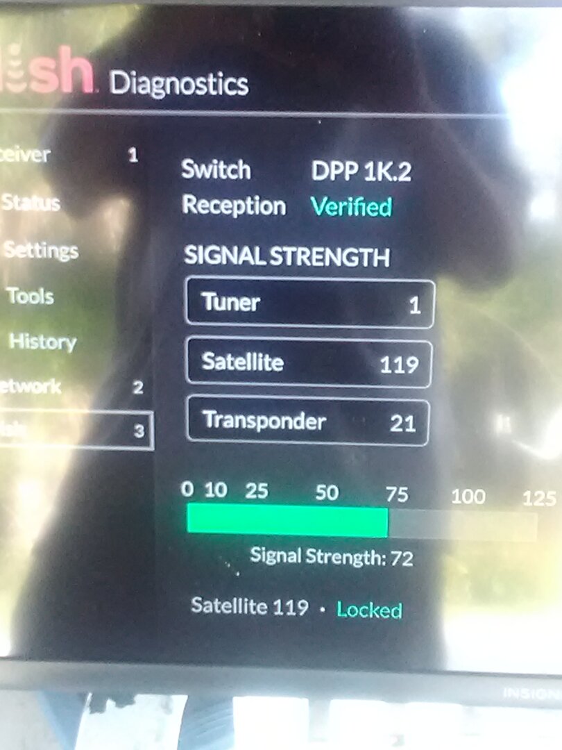

I tried your suggestion today. First I re-established my baseline set up (I take the dish down over night) . with the single (I'll call it that even though it has 2 connectors) LNB. I quickly had success with receiving all of my channels, Sat 119 only, and mostly 70+ signal strength. Before I started tweaking pointing, I took the output of the single, and ran it into the input of the double LNB. My Wally box recognized the double and repeated the video and signal strength results. I then connected strait to the double LNB and started tweaking the direction and angle of the dish like you suggested (this dish has a jack-screw, after I brushed the rust off-it and applied some anti-seize , I could tweak the angle easily and precisely) . I couldn't receive anything, either with my signal meter, or the Wally signal meter. After many attempts, I brought the dish back to the settings I started with, and easily got back to the Single LNB and Sat 119 w/ good signal and all channels. I think I'll quit while I'm ahead( the double LNB may be shot, one of the plastic horn covers is cracked) . I have to add, given the only experience I have with these is a old Sony single LNB dish from the 90s w/ Direct TV, I find this Dish equipment pretty user friendly. This is the second dish I pulled out from the trash and got Video w/it. In the event of doomsday, I think I'd rather have a Dish system. Thanks for the inputs.
You haven't mentioned having the receiver perform a "check switch" after connecting and aiming the DPP (Dish Pro Plus) LNBF. It's required for it to perform this checkout for it to know what kind of LNBF scheme it's interfacing with so that it can switch orbital slots and polarity as needed for the selected channel. It's also an indicator of whether the LNBF is any good (they're actually rarely bad). The receiver should be able to state on-screen what type of LNBF is connected. Also the multiple-feed units are a single LNBF, just with the multiple feed inputs and also a feed-switching system. They could be termed as dual- or triple-feed LNBFs.
Thanks, it did run, the dual was recognized as DP 500+
While you may at the moment think you are getting all your channels, without the 110 you definitely are not getting all your channels. Won't get locals without the 110 either, if your subscribed to them.
Thanks, I don't subscribe to local channels, I'll have a look, if there are any channels missing I didn't notice them when I scrolled thru the guide. (actually, I seemed to notice more channels, several Spanish speaking and a Chinese streaming one....
