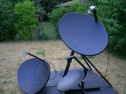

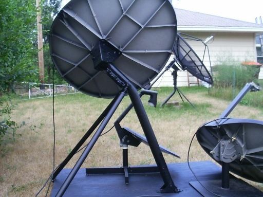

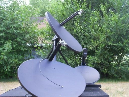

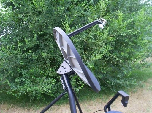

Yes! That's exactly what I do with my "Poor mans H to H mount"
Off set your mast to the same angle as your latitude then rotate the dish until you land on the satellite!

Hey Pete is the mast your using bigger than most, or is it an illusion because it's at a 45 degree angle.
Also..... since mast is at correct angle (lattitude) then dish elevation equals Zero........ is this correct ?
This is the standard mast for the 40" P* dish!
The elevation on the dish ends up at around 24º here!
