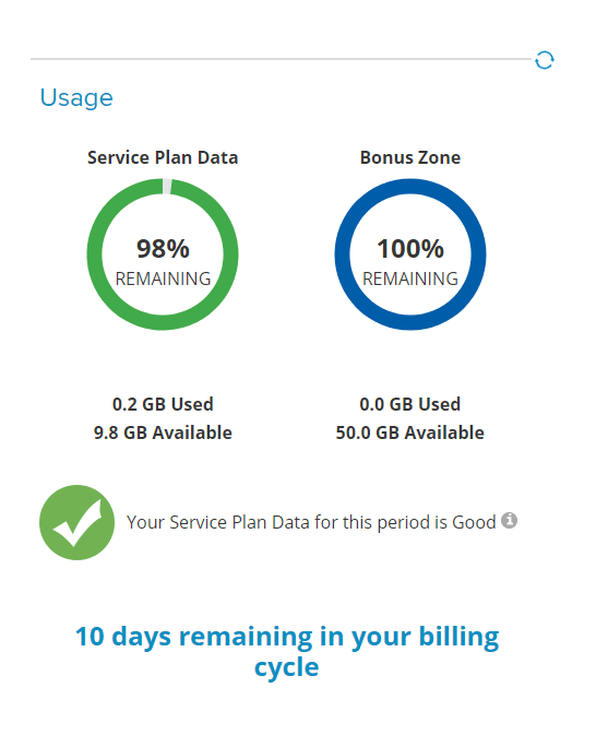

If you go to 192.168.0.1 in a browser, it'll bring up the Hughesnet portal. See where your data is at. If you're out of data, you've been throttled down. Typically, Gen 5 speeds run over 20 Mb/s during peak hours, from what I've seen. Also, you're Dish may need to be repointed
I hardly ever use my HughesNet connection, so it's impossible that I'm throttled. Isn't HughesNet signal strength measured in up to 120 points/units/whatever? If so, then my 110 is pretty good.

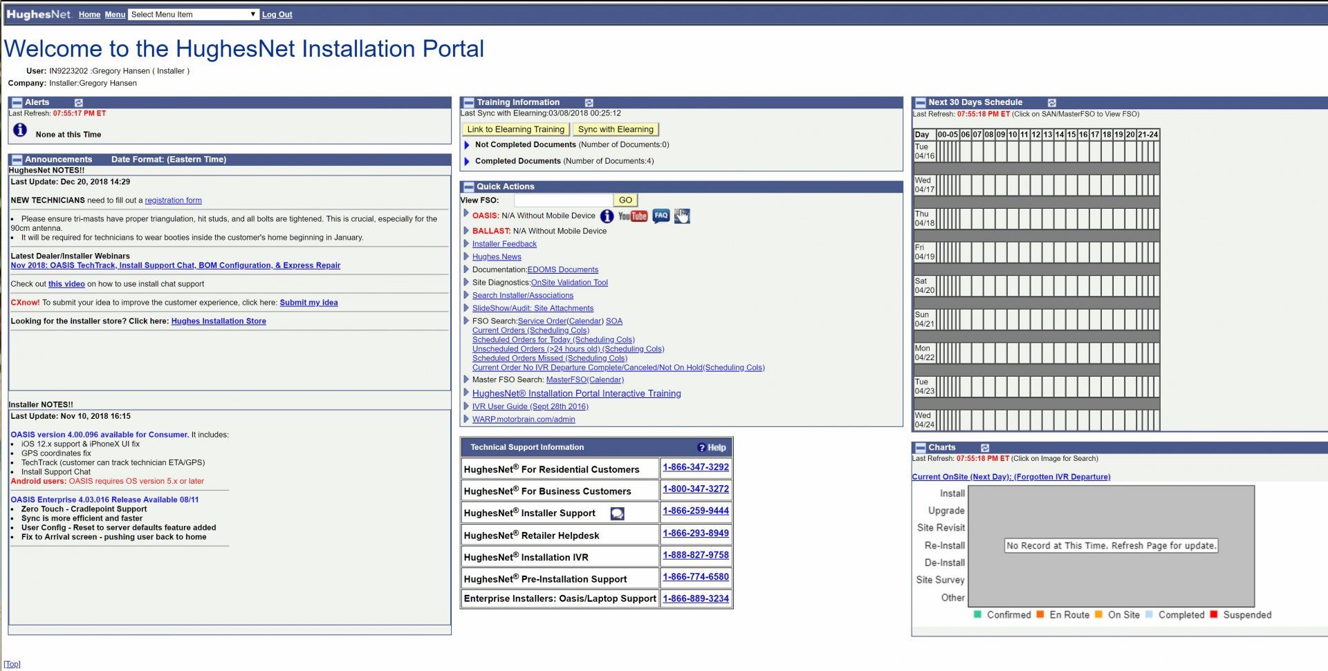

The on site validation tool OVT is used after a dish is aligned to verify all parameters are within Hughes specs. It's a web based test available to installers, not a physical tool like the dapt you have pictured.
You mean like this:
