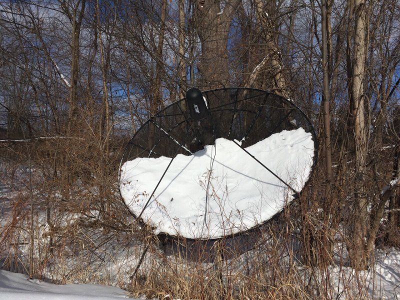

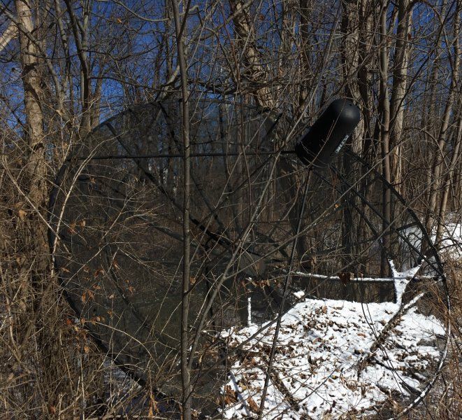

Also, I found another c-band dish by a nightclub. I've looked on google street view and it's been there for a long time. Also, it's always overgrown during the summer. Should I call them asking for it? Is it an 8 or 10 footer? Here are some pics I took earlier today of it.
Yes ask them. Never hurts to ask.
Looks like a 10 footer.
I just took down the same dish. It was all 1/2" and 7/16" to take the dish parabola off the ring mount. Most of the bolts will break. That's a good thing - you should buy new stainless nuts, bolts and washers. I cut the pole just below the mount and at the base for a favor to get the pole down for the house owner. Take it home and bath the mount in penetrating oil and take it apart and clean it up, reassemble and you'll be good forever.

If at all possible I would take the whole thing at once. Get some help and move the whole thing. It looks like it is not high off the ground.
I'll take it apart in panels Is c band easy to align to a satellite?
Since you insist on taking it apart, I suggest you take a LOT of photos of it from all angles before tearing it down. I also suggest that you take a permanent marker, and number the panels and make marks so you can fit it back together EXACTLY how it was put together originally.
Oh yeah, and you'll most likely break the majority of bolts, so be ready for that.

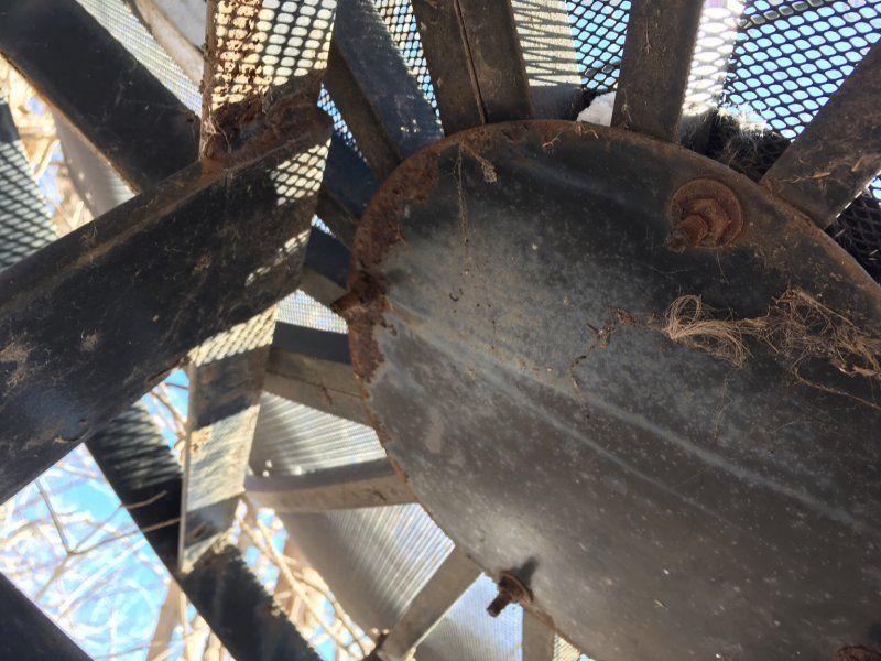

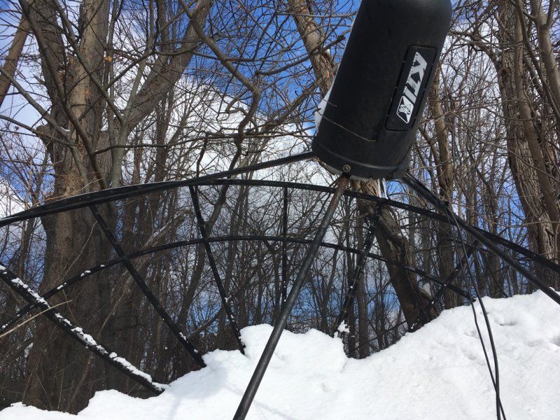

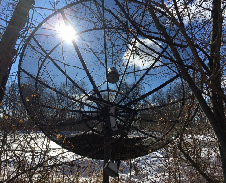

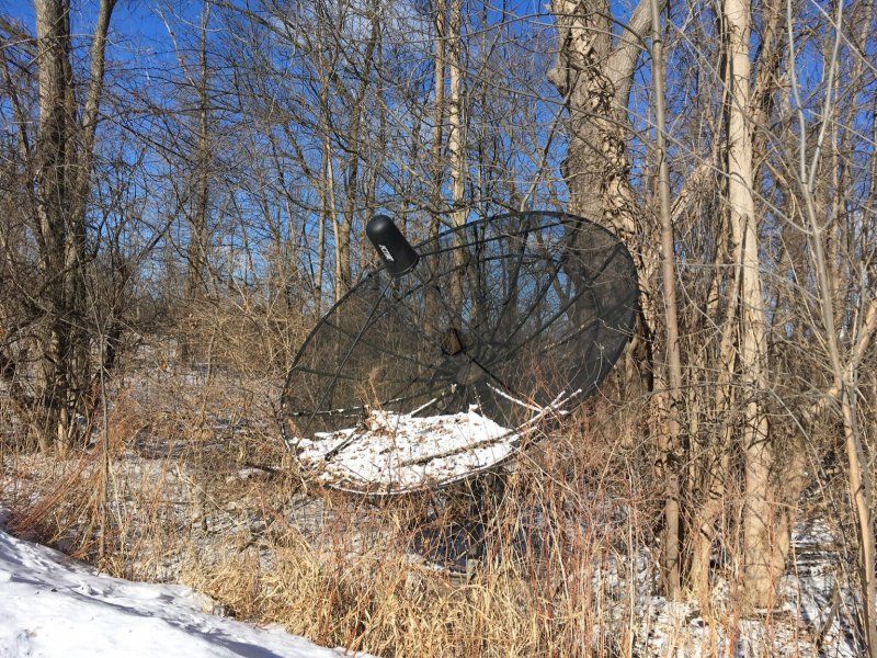

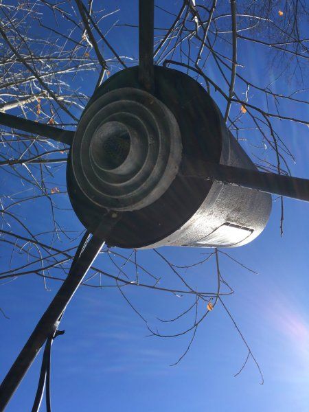

I stopped by today and took more pictures and talked them down. They originally wanted $300 but after negotiating they let it go for free. I wanna take it down now but my wife refused to help me until spring. So, unfortunately I'll have to wait[emoji17].I think it's in pretty good condition, a bit rusty though. Does anyone know when these KTI dishes were made?
It looks pretty good to me! and it seems that the feed is a corotor (a bit hard to see in the picture). watch out for some dings in the mesh where those branches landed, but that looks like a great find! I agree with Greg, that rust should not be a problem. It appears to be just superficial. Congratulations!
