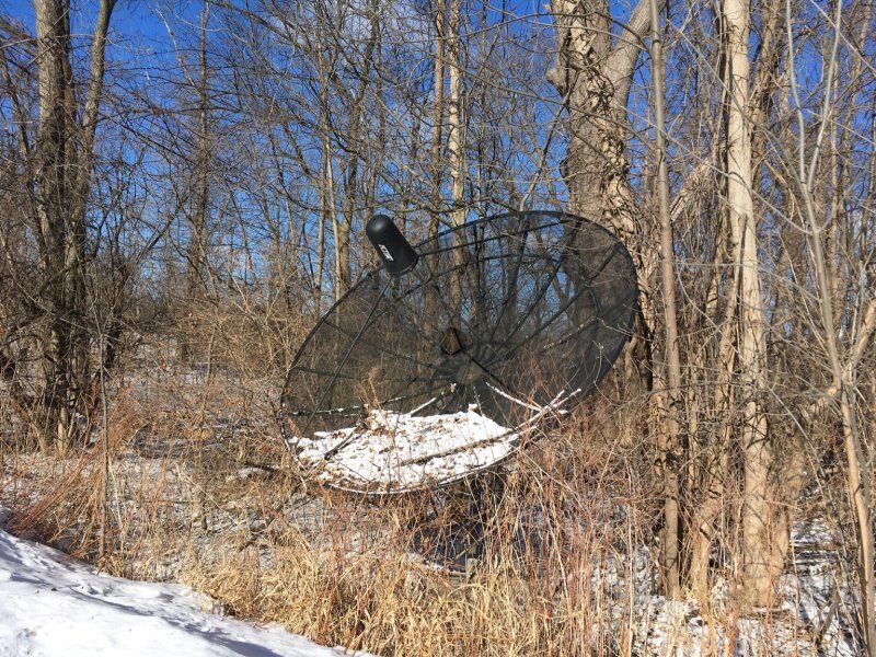

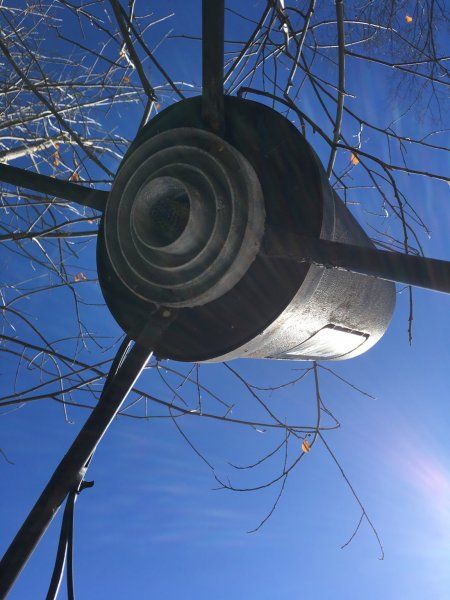

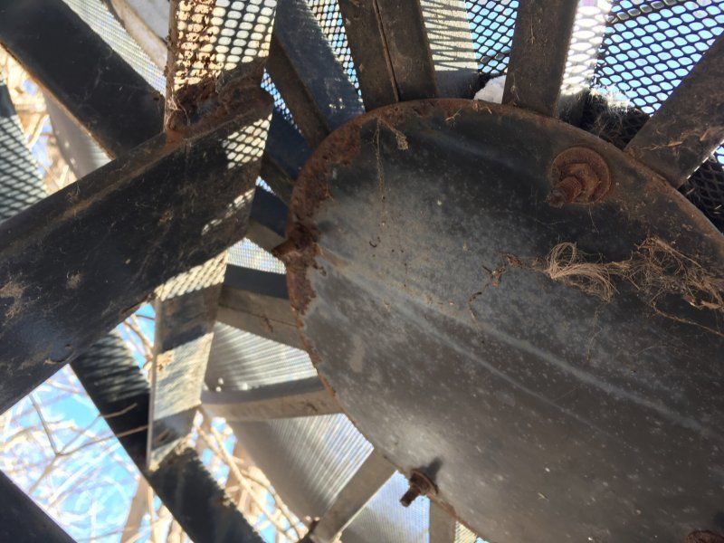

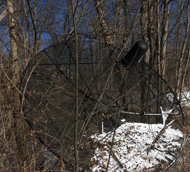

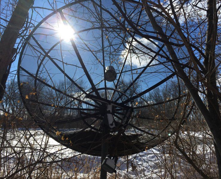

I stopped by today and took more pictures and talked them down. They originally wanted $300 but after negotiating they let it go for free. I wanna take it down now but my wife refused to help me until spring. So, unfortunately I'll have to wait[emoji17].I think it's in pretty good condition, a bit rusty though. Does anyone know when these KTI dishes were made? View attachment 130443View attachment 130444View attachment 130445View attachment 130446View attachment 130447
That's probably mid to late 1990's. Made by "Kaul-Tronics"
It looks pretty good to me! and it seems that the feed is a corotor (a bit hard to see in the picture). watch out for some dings in the mesh where those branches landed, but that looks like a great find! I agree with Greg, that rust should not be a problem. It appears to be just superficial. Congratulations!

A corotor feed has a small motor that turns the probe in the feed horn to switch to horizontal or vertical polarity. If you decide to switch to a titanium lnbf you replace the feedhorn and corotor and lnb with the lnbf. It will then use voltage to switch between horizontal and vertical polarity.
A Corotor is a feedhorn with a LNB attached. A small servo motor rotates a probe inside of the feed to select horizontal or vertical polarity.
This type of feed provides the user with the ability to optimize the skew for each polarity, which is useful when attenuating adjacent satellite interference or other signal issues. The interchangeable LNB options permit the user to select an appropriate model that fits their budget and requirements matching the type of signals they receive and to upgrade only the electronics.
To use the Corotor, you will need a servo controller that interfaces with your receiver. The controller senses the 13 or 18 Vdc polarity voltage provided by the receiver and positions the servo probe at a saved position. An example of a dish positioner with servo control is the ASC1.
Some hobbyists manually control the polarity servo with a legacy IRD. While possible, it is a PITA to manually select the polarity on a separate controller each time you change the channel or perform a scan. Also, each polarity must be separately scanned and the polarity manually changed between the scan. :(
Options to using the Corotor are a LNBF or an Orthomode (fixed horizontal and a fix vertical polarity LNB without servo skew adjustment).

A week or so before you are going to pick it up, start stopping by every day (or thereabouts) and squirt some PB Blaster on all the nuts and bolts. That will hopefully keep the twisted off hardware and scraped knuckles to a minimum.

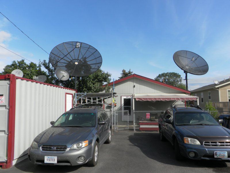

I have a set of "His & Her" C/Ku Buds. Perfect :)
