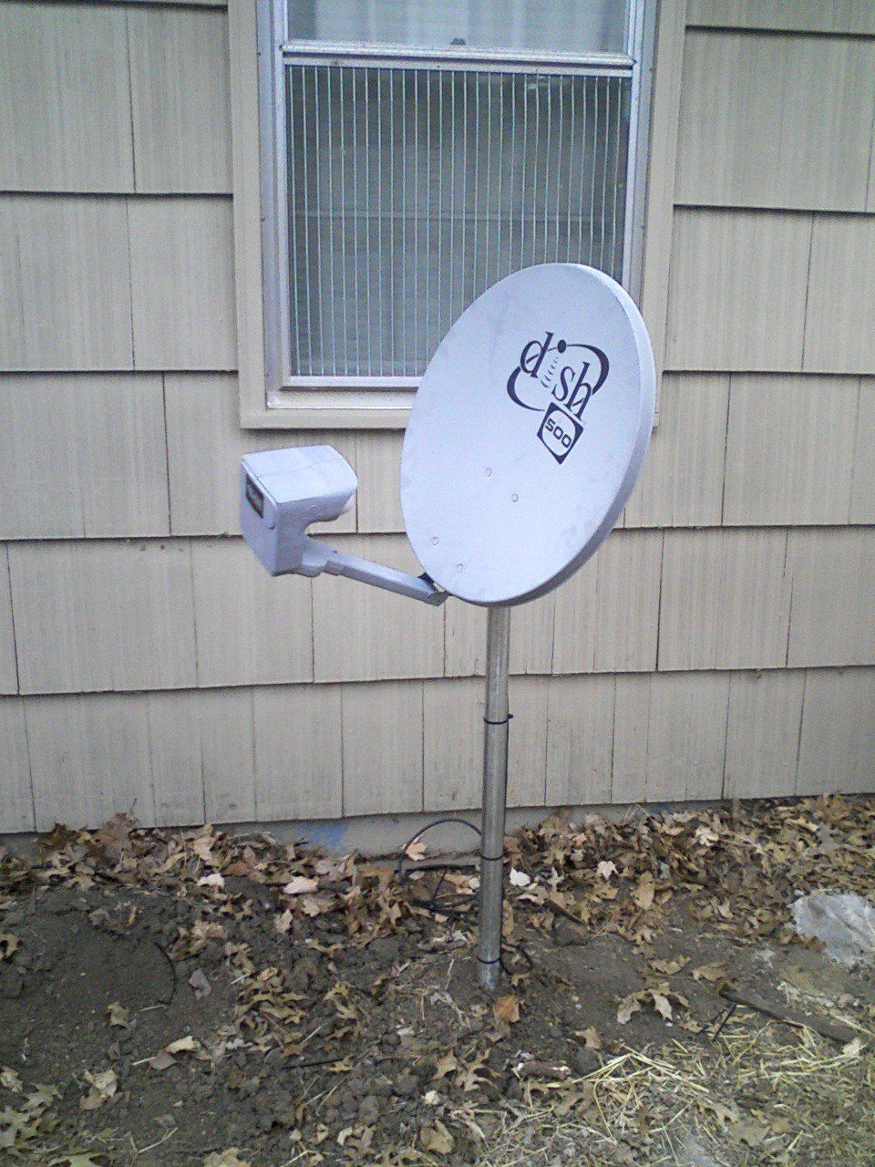

I've seen posts about people having success getting acceptable signal splitting 61.5W and 72.7W with a D500, and using a wing dish to pick up 77W. I have a pile of dishes, a few LNBs, and some free time on my hands, so I want to try. I'm also handy with metal, so I can extend the focal length of the D500 LNB arm if I need to. I just have a couple of questions:

Not having a clue about the skew setting, I had to settle for trading my 129 for a 61.5 wing dish. I eliminated 75' between the Plus and the wing dish in the process (there was actually over 200' to start with) . My signal strength was indeed breakeven. I REALLY need to get an answer to number 2 in the first post. Do I have to plug in a 77 wing to get this done? Once I get the skew number, I really want to push forward.

According to the 1000.4 installation manual, the skew should be set at 65°. Since I'm not using a 1000.4, and 72 rides lower in the sky, I think that 67° is probably closer to what I need. This would all be a lot easier if I just spent $100 on a proper EA dish, but I'm beyond broke.
I have no idea how much more length I'll need on the LNB arm, but I'll worry about that later, when I get rid of the 125'+125' of RG6 still strung across my back yard, replacing it with 75' wrapped around my house instead. :)

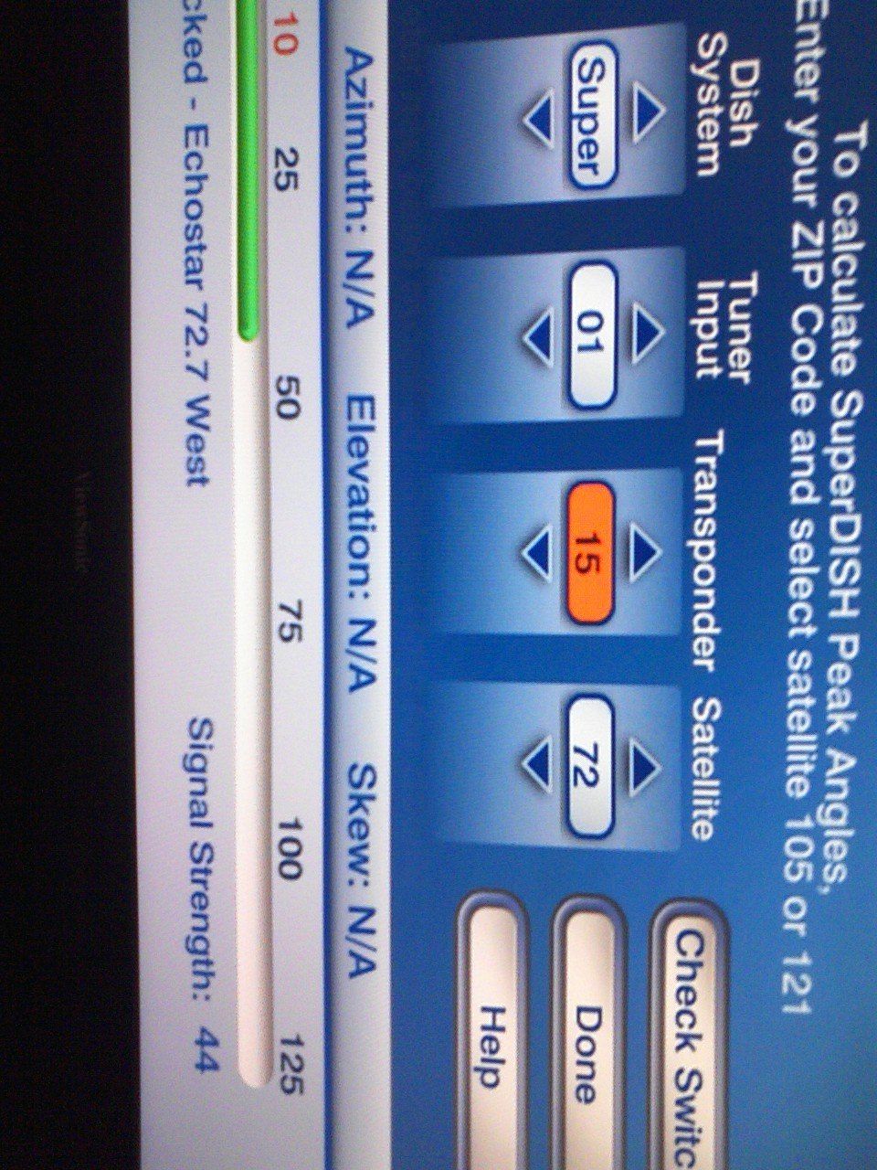

Got the skew set at 65, peaked the best I could on 61.5 (by myself), and moved the DP twin to the other side of the Y adapter. That sumnagun worked! When my buddy gets off work, he'll bring the compression fitting tool over, and we'll REALLY get this dialed in!
It's Working! Low 50s on the strong tp's, but it's totally functional.
