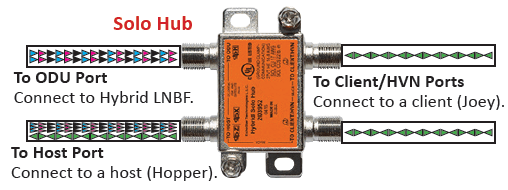

Simplify it if you don't mind buying a few things. Gut/or bypass all the cabling coming out of the LNBF except one cable. You'll need a DPH Slimline LNBF with LNBF Bracket and a Solo Hub.
Here's the connections:
