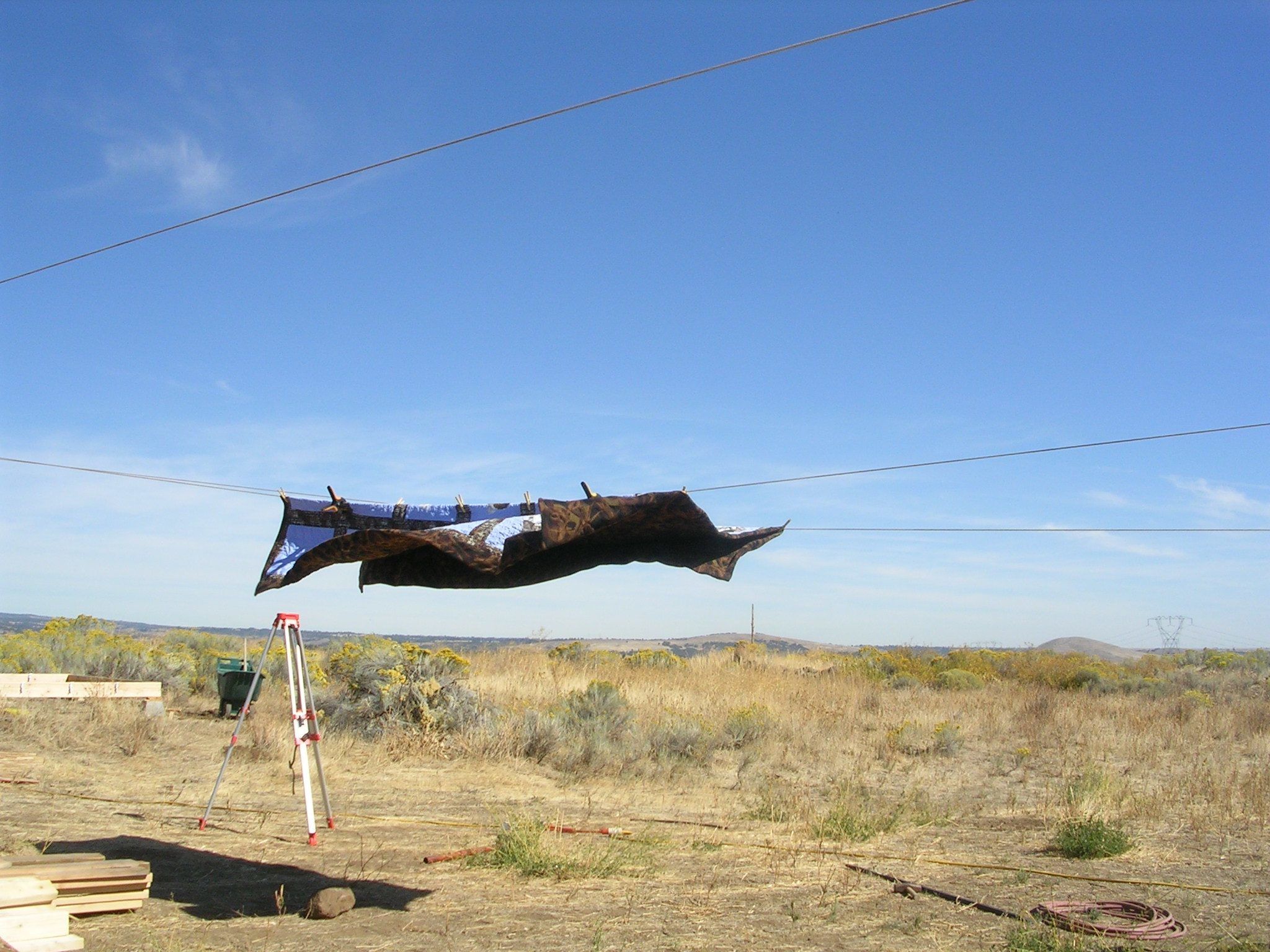

OTA is iffy--- 43* to 148* (plus on both ends) clear LOS.
