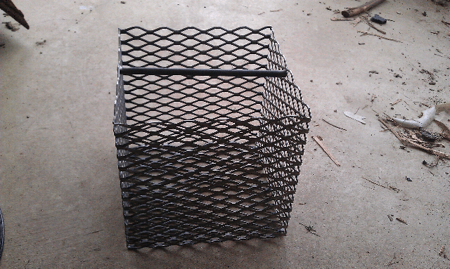

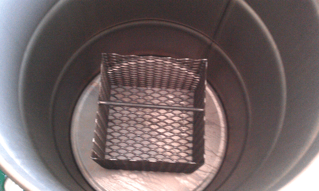

The start of the charcoal basket.

stimpson said:
Looking good so far. What do you plan to use to pull the basket out of the drum? Or are you going to do it by hand after it cools down?
Slow down there mister. ;)
This is a fly by the seat of your pants build and I have no thought that far yet. :D
Most likely I will make a hook to pull the basket out.
