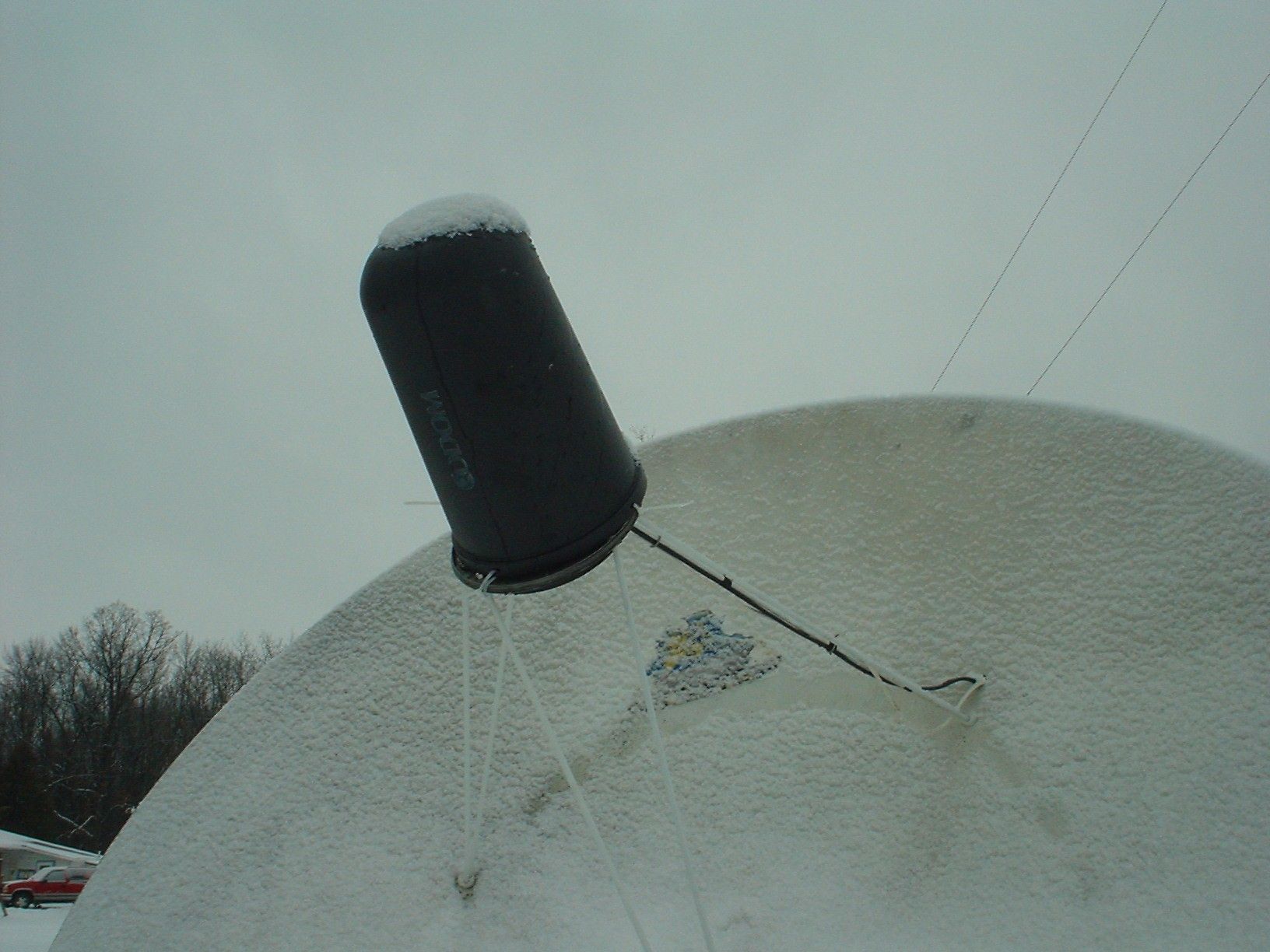

As far as attaching the LNBF cover to the plate, I've had to use a longer, more "standard" nosecone on my birdvew conversions. I run long wire-ties (zip ties) around the supports (BV has 6 total) to the holes in the side of the cover! Holds nicely. Tight as you can get, but easily cut and re-attached. And, though it does not fit perfectly, the bottom is open for moisture to drip "out" and can be sealed in the summer with silicone. Meanwhile, no weather on the components. And, the birdview "perf" (black) dishes had black nosecones of plastic with no problems on heat, either that we were ever aware of as retailers.

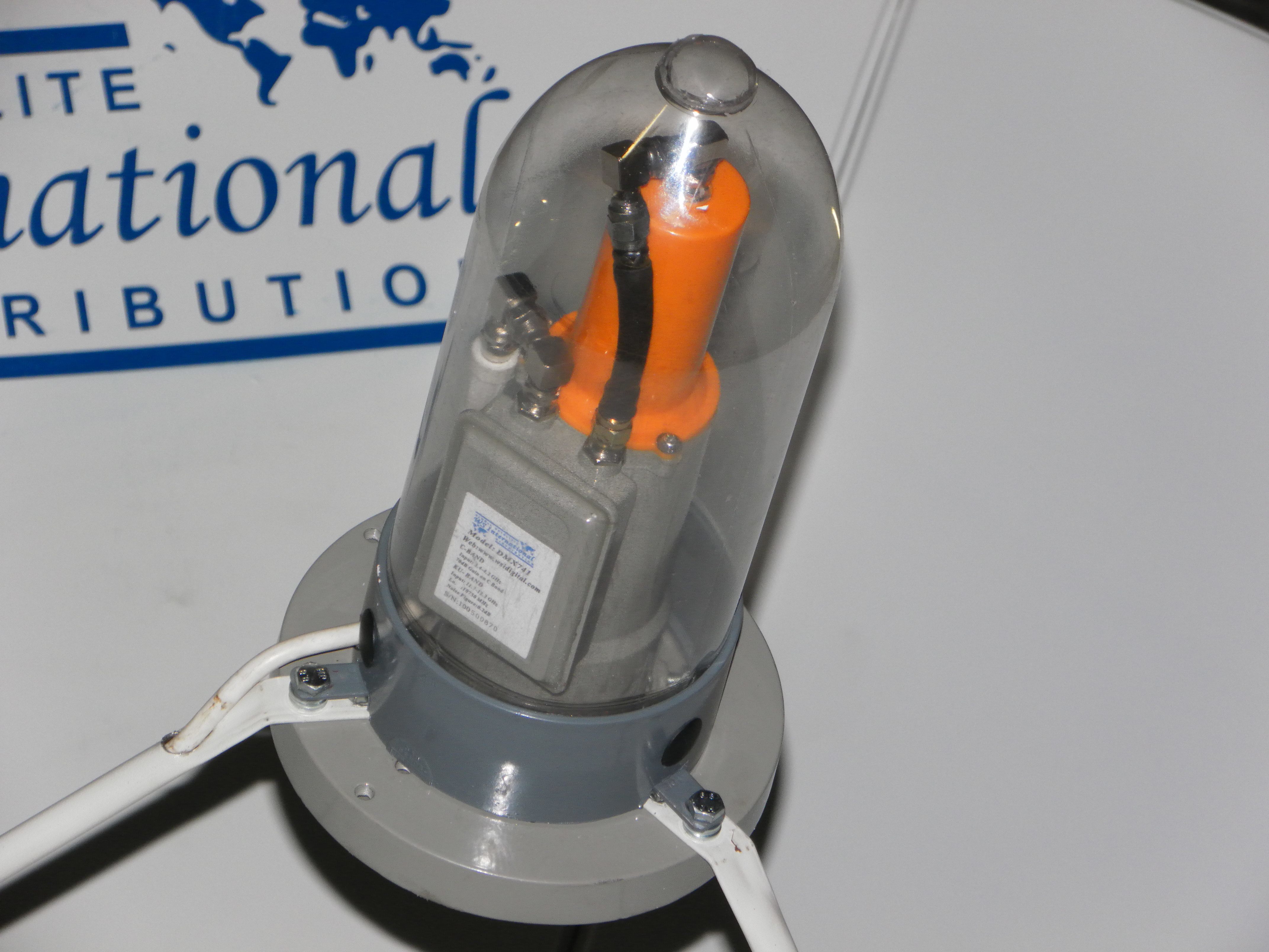

I made a cover from a 2 liter bottle for a DMX741. Have yet to see how well it will work, field test it.
