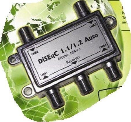

LNB will work and with DISEqC 4x1-1.0 or DiSEqC 4x1 - 2.0

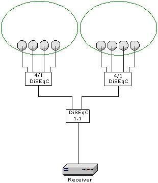

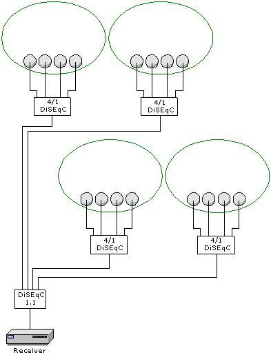

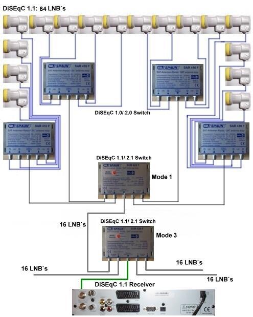

Hello. It is necessary it will be defined, how many you think to establish Dish and LNB.
If 4 LNB will go 1 DISEqC 4x1-1.0 or DiSEqC 4x1 - 2.0 report

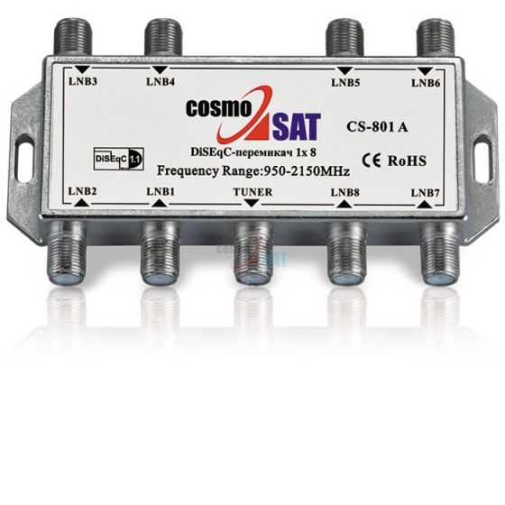

If 6, 8, 10 LNB will go DISEgC 6x1-1.1 and DISEgC 8x1-1.1 and DISEgC 10x1-1.1

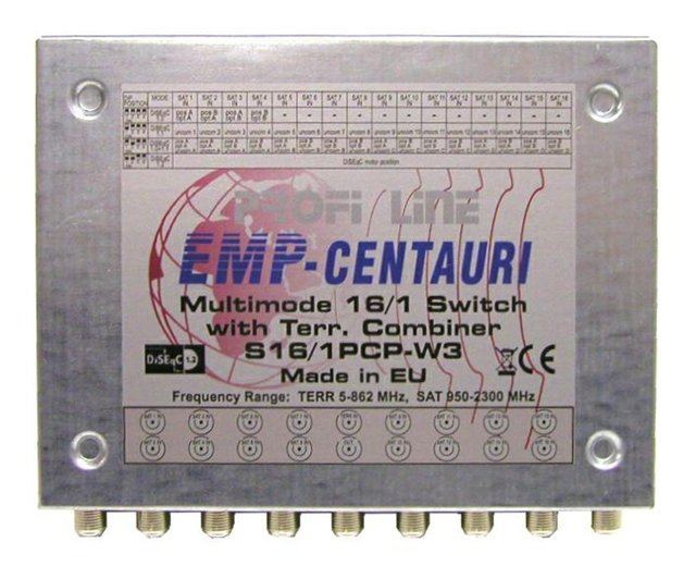

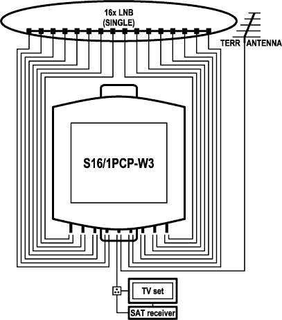

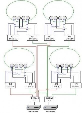

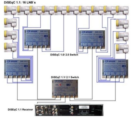

If it is more 8-16 LNB that below a photo and how to include. If the receiver supports report 1.1

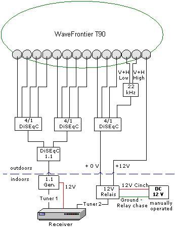

At me on 4 Dish it is included 16 LNB.? by the cascade has connected 1 DISEqC 4x1-1.1 plus 4 DISEqC 4x1-1.0. Perfectly all works.

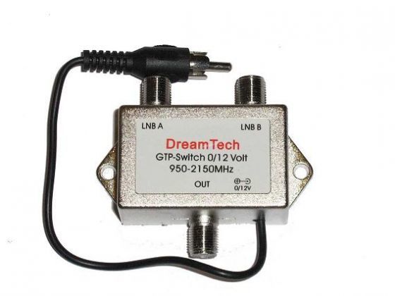

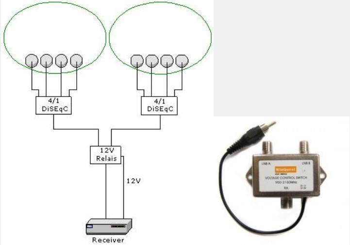

If at you is in a receiver 12V.?? it is possible to connect 8 LNB through the relay 12V.

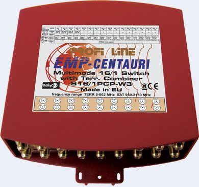

There are at us on sale and switchboards DISEgC 16x1-1.1 and DISEgC 32x1-1.1- But they are expensive ---------------------------------------------------

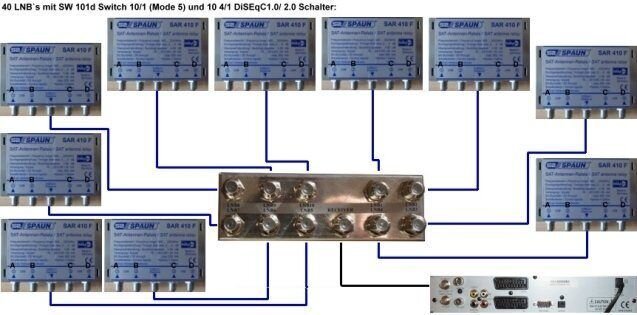

It is possible and 40 LNB the cascade to connect-report 1.1.??? switchboard DISEgC 10x1-1.1 plus of 10 pieces DISEqC 4x1-1.0 or DiSEqC 4x1 - 2.0
-+ 64 LNB
