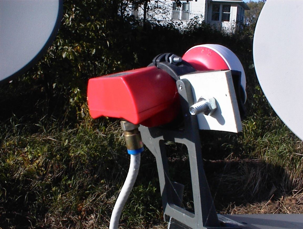

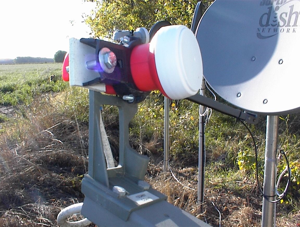

I have several SD's in my array, and have modified them for standard (40mm) lnb's. They seem to have more "punch" than the stock FSS. Got the lnb holders off fleabay. total cost per mod ~$15.

The nice thing about the superdish is that it's made for multiple LNBFs. Built ruggedly and best of all, can be found for free. Be creative in design and post the photos.
