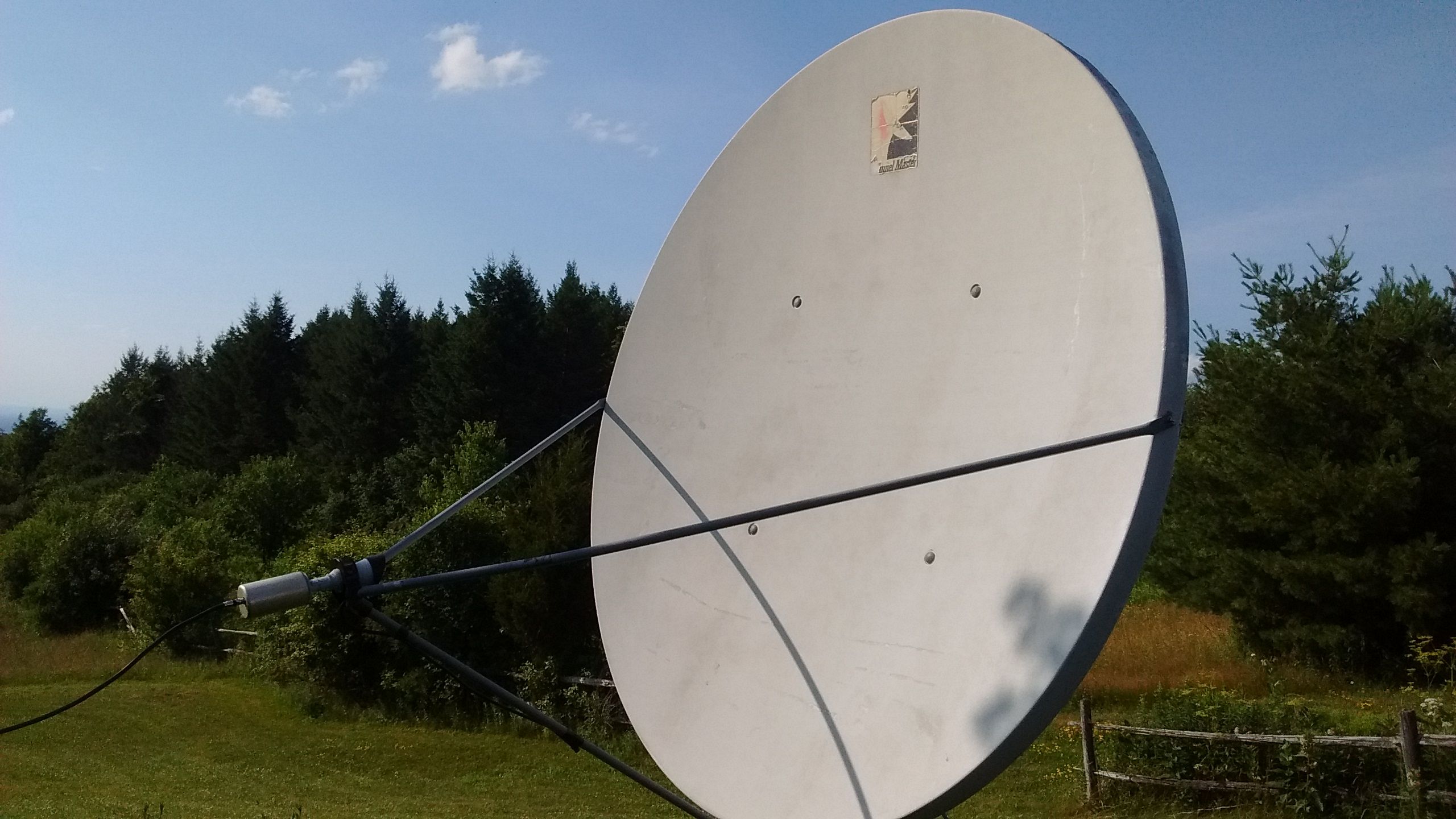

In my haste I did not install the spacer when changing out a KU LNB. I replaced a 1209HA Norsat LNB with an Primestar single on a 6' Channel Master solid dish.
I am receiving Cozi at 103W fine with a 16 db SNR?
The spacer is about 1/2" and is shaped as you see in the picture.
I am keeping it just in case I need it someday.
Thanks

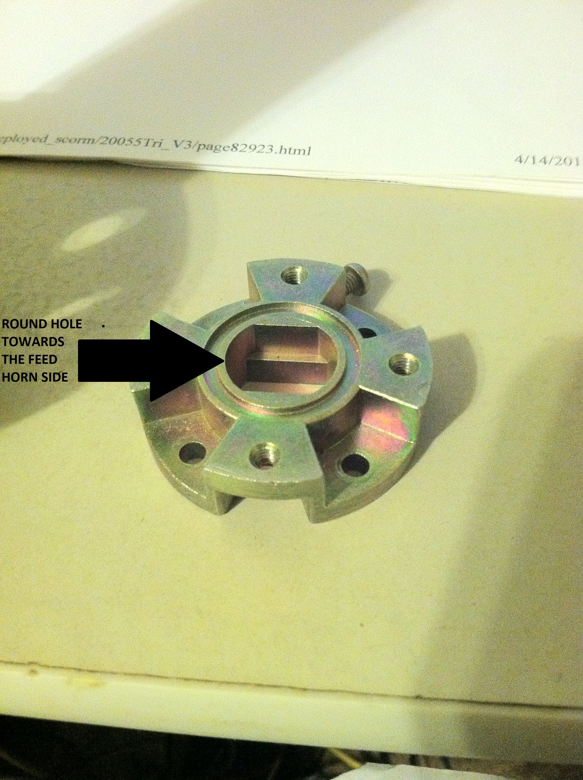

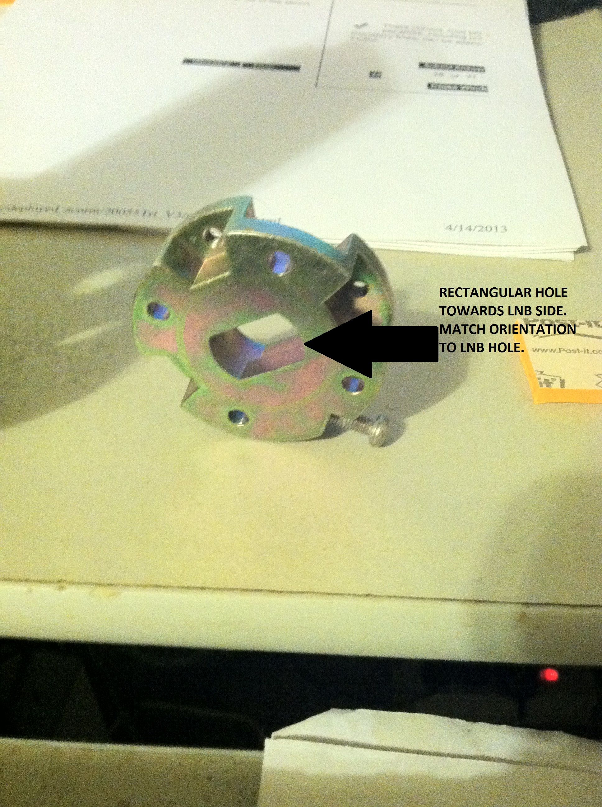

Yes you need the "spacer". Its a waveguide polarizer. Its job is to convert the circular polarized rf from the feedhorn to the linear polarized rf needed by the lnb. It will probably give you 2-3db of signal back.
It goes on only in one direction. The circular hole goes toward the feedhorn & the rectangular hole goes toward the lnb.

The 2 pics (its a prodelin polarizer but that doesn't matter) show better what I meant about which side goes towards the lnb etc.
If its working ok now you can get away with leaving it off ..... if its a long drive back to re-install it etc. But if you are in the area I would recommend putting it back on. As you know with ku signals they are subject to rain fade etc. I'd want every db of signal I could get so it might be worth the 2-3db to put it back on.

Just talked to the guy at the station and Cozi went out in a heavy rain.
Need to do more fine tuning with the dish.
So I need to put the spacer back in and if it does not work with Primestar LNB I will have to get another LNB.

So I reinstalled the prodelin polarizer and it did not make much difference SOOOO I moved the dish a bit and now am up at 18 CNR.
