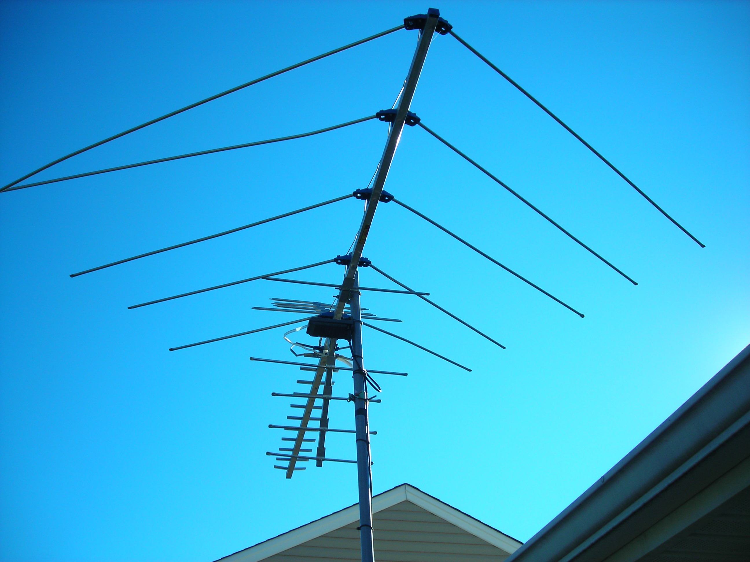

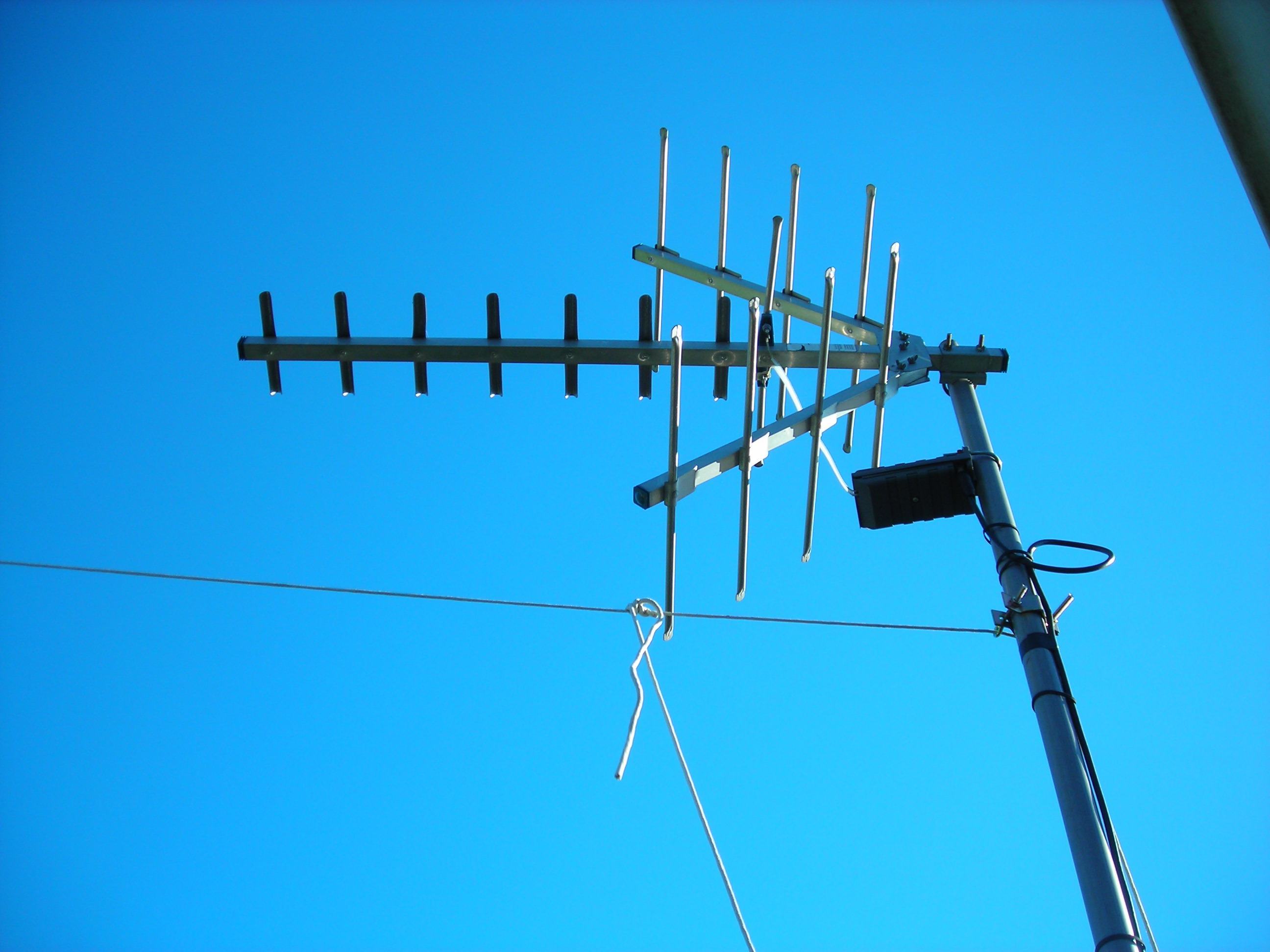

Well, there is hope..but there is going to be a lot of work involved. I need to raise it up another 10 feet, replace the coax and see where I can go from here.

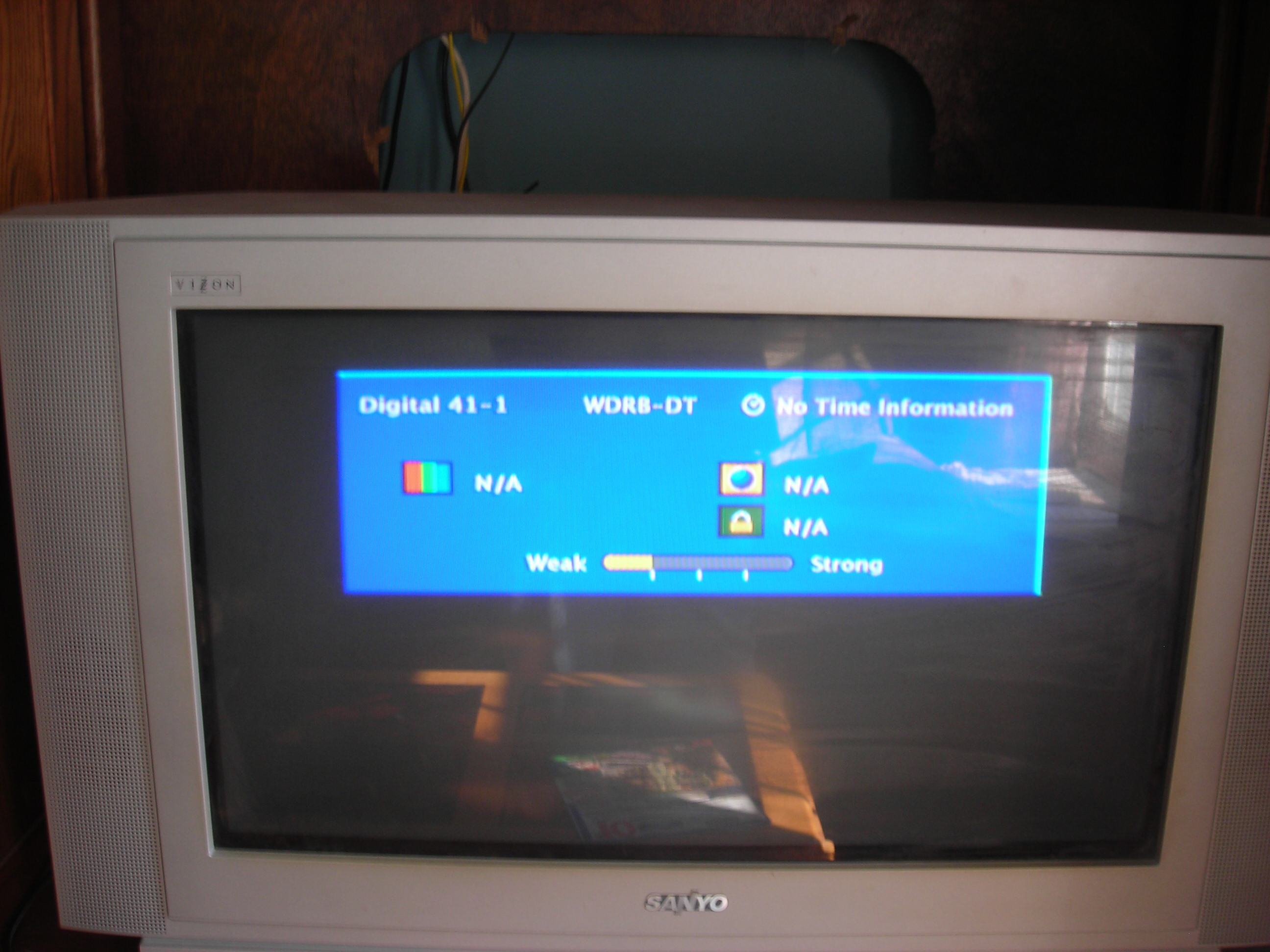

As you can see from the pictures, I do get WDRB 41 Louisville KY at 78 miles. It is not viewable or reliable, however there is a constant weak signal there. I had a few brief blips of it coming up for a second or two with a picture.
The reason I put in 900 feet in TV Fool (It only takes 500 feet) because that is my elevation..a bit over 900 ASL. Thank you for your helpful comments and suggestions. This is going to be a work in progress. I will try to update again soon in the near future.

Well here is another update. WDRB 41 Louisville KY is coming in nicely, not fading out much ...pretty watchable at 78 miles. We boosted the antenna up another 12 feet and got a 33 db mast mounted amp and replaced the coax.
The only problem is...41 Louisville is the only Louisville we can get and non of this makes sense...unless Fox 41 is in a different location from the other Louisville stations or running higher power than the other Louisville's.
Well then again, this is what they call experimenting. I have to look at TV Fool again and see if Fox 41 is transmitting from a closer location, different from the other transmitters...or ...if it is just a case of tropospheric ducting tonight (it is 49 degrees right now and has been in the 50's for quite awhile).
EDIT: When I tried this 'experiment' with the (ATSC to Analog) Insignia 'converter box', it was only with the Insignia that I was able to get fairly good reception on WDRB 41 from Louisville. The Sanyo ATSC CRT TV, the tuner did NOT get reliable reception.
The Insignia $49 converter is one hot receiver and it scans fast too. Regardless despite numerous tries, 3, 11 and most wanted WLKY 32 did not come in or even map. And from what I seen on the TV Fool map...they are all from the same direction. WDRB 41 which I got and WAVE 3 are both 1000 kw, but only WDRB 41 mapped and was received. WLKY 32 is only 600 kw and probably is the reason it will be impossible here.
