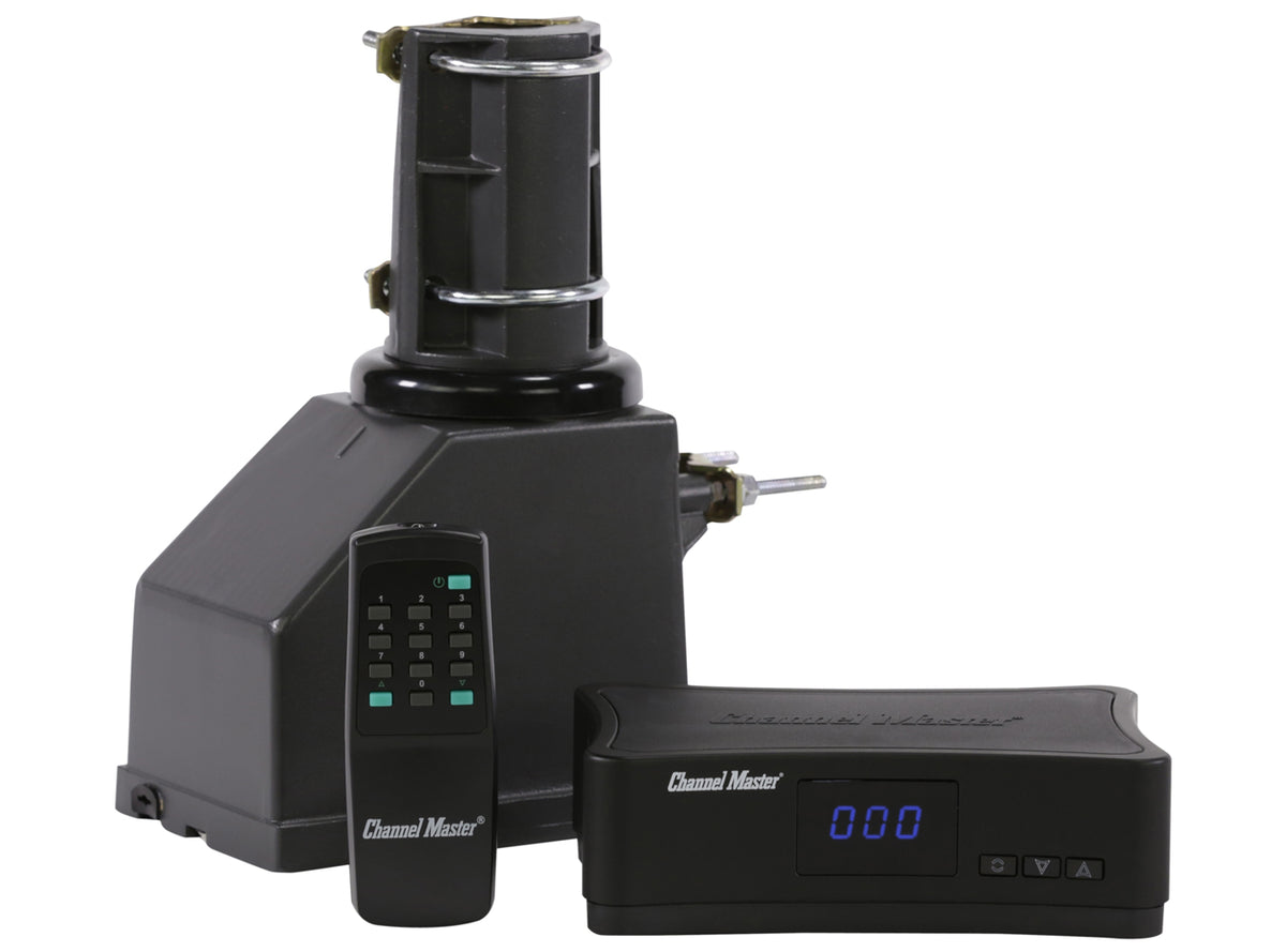

I got a new Channel Master rotator from a dealer about a year ago. A few months in, it would only rotate about 75% of the way. I called the dealer, and while no longer how long it takes for them to come back, since the claim was made within a year it could warranty out. He just said that due to COVID they weren't making them (somewhere overseas) at the moment. About a month ago, I called them to get more info from them, and they said that they were now finally being made, but they have no ETA, and I called a few times with a few different people to double-check. I'm guaranteed a new one free because of warranty and while I'd still have to pay for the service call, I will still get one. Anybody have any input on when they will be available? I hope to replace it this spring and hope to not have to wait any longer. Luckily I have it facing my direct locals.

Don't know if this applies in your situation but quite often when those things stop turning, or only turn very weakly the problem is the non-polarized capacitor in the control box unit. Those things do go bad and if you can find a replacement for that capacitor it might restore your rotator to working condition. Of course, that will not work if there is some kind of mechanical problem in the rotator unit itself.

I have been selling and installing Channel Master Rotators for 20 years. They stopped production overseas before COVID and I wouldn't hold your breath on new production. It is rare for their outdoor drive units to run 75% of the rotation. This can happen if it's not wired properly. When the unit is running from 0-360 the antenna should be turning clockwise. Time the rotation outside and even inside. They are both 1 rpm units and I have seen the control box run too fast and the drive unit can't keep up...meaning it does not complete its rotation. Easiest way to see the unit run is to set the indoor unit to 360. Then type in 00(down arrow) and watch the rotator turn. It should run from 360-000 then 000-360. Note the indoor unit will be flashing a synchronization sequence. Are there any branches or twigs that could be slowing the unit down? A simple twig hanging up at the end of a large directional antenna can easily stall that rotator.

I tested it a few minutes ago and I heard some crackling, so it's possible it may be a twig? It's too dangerous for me to go on the roof (it is very slanted), but I'll hire the professional dealer and he can have one of his guys remove it.

Ah crap. That was an error on the company's website and those rotors aren't available. I think it's possible that there's something caught in that rotor, and I hired my dealer to fix it hopefully Friday (if the weather is okay and the roof is not too slick).

I will, thanks. I called him again with another question and he told me that it should still be under warranty even if they fix it a little. So if the repair is so-so, at least it's still under warranty. So I'm good either way.
